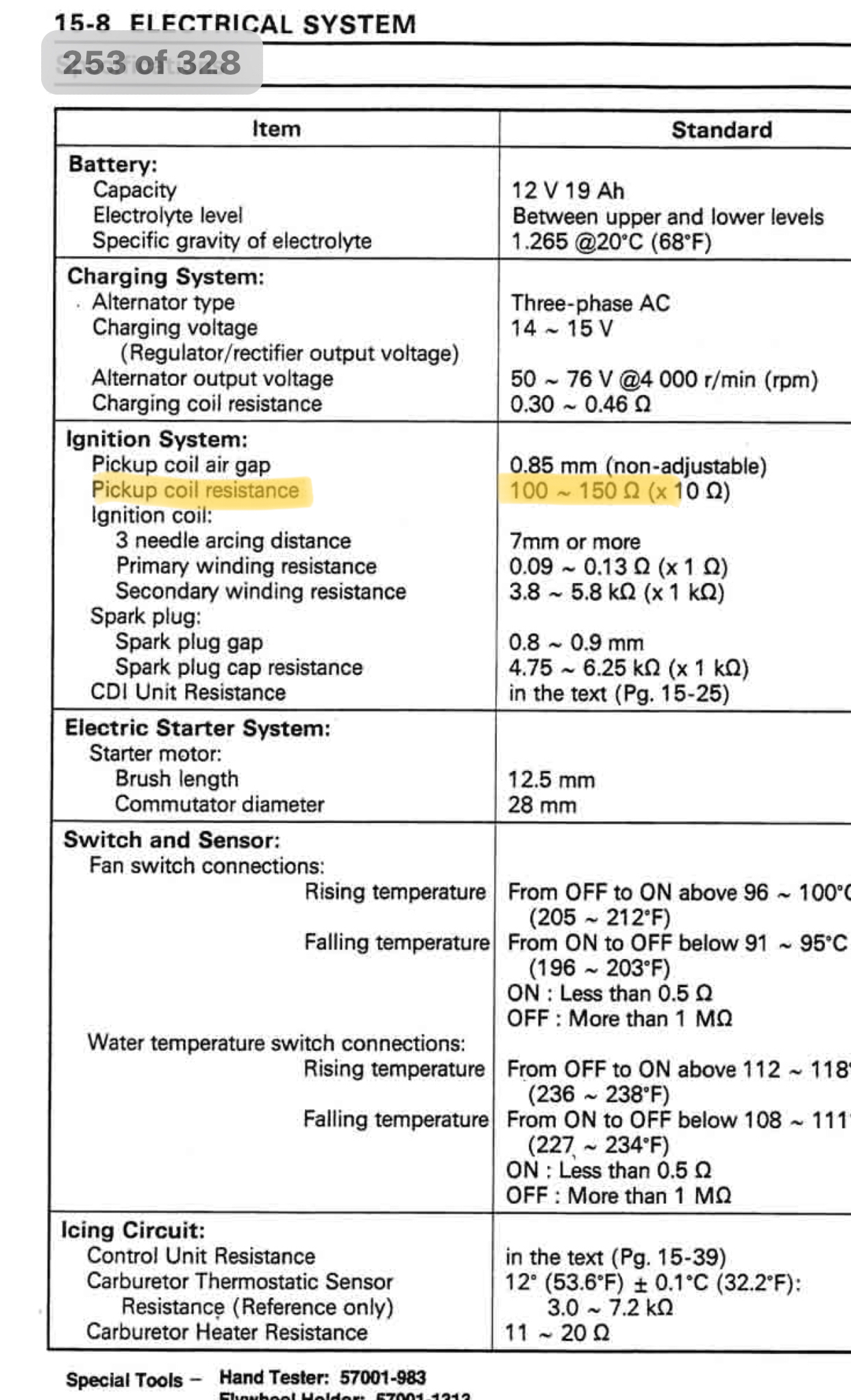

Wow strange. I will double check my bike when I get in and the spec on it. See if that can clear anything up. But there should be a reading in the  500 range I think. I will check my bike see what I get

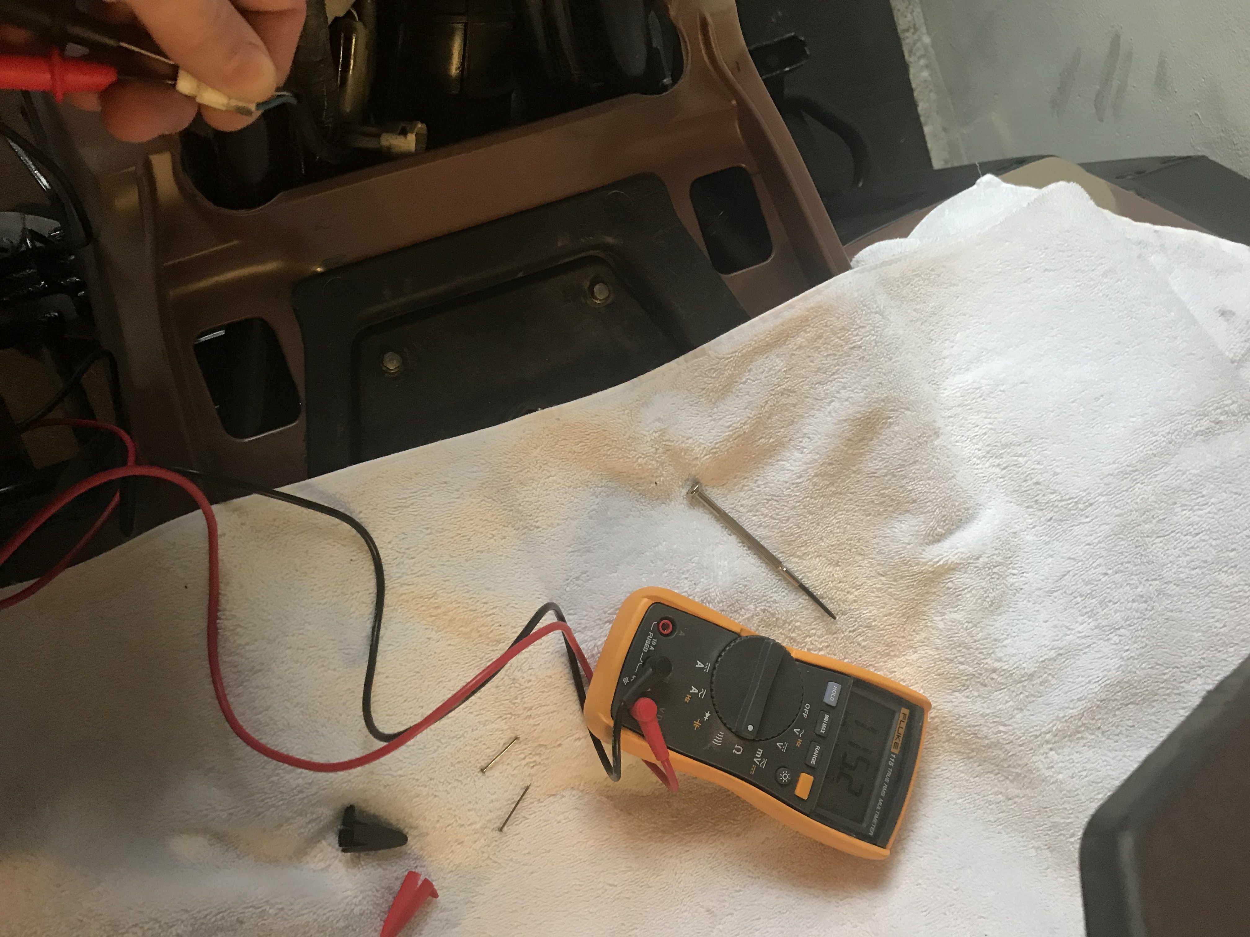

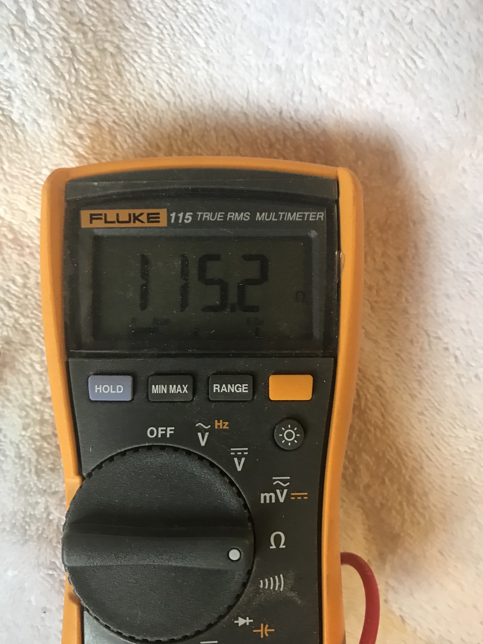

Ok so I was wrong on the reading.  I’ve attached a pic so you can see the plug and the test result.
Possibly a broken wire on that trigger coil it’s self where it was soldered during manufacturing ? Defective maybe ? Check the plug as well, and maybe test further down the wire closer to the engine to make sure there is not a stretched/broken wire.   Other then that you may have to pull the casing off and check it out.
Share this post
Link to post
Obviously the one I tested is in range so you should get between 100-150 on yours.  Try each one of the wires to ground to see if you get anything. Just a shot in the dark

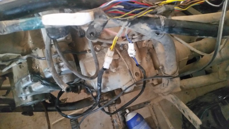

got a temperamental  bayou 400 sometimes starts most time not.
currently gets one spark once you turn on the key and hit the starter then nothing. turn it off and back on get one spark again and then nothing
anyone run into this?
