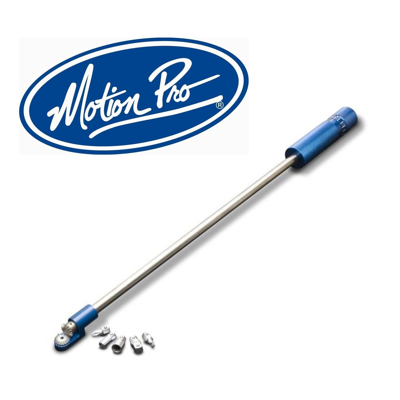

You'll need one of these tools to adjust the idle mixture with it running.1519871349_s-l1600(2).thumb.jpg.e453529e4c76ffb4e87d4c137fd2ff38.jpg
Starting to think I have multiple issues going on. Going to replace my very old and worn fuel lines to make sure none are collapsing off idle as that explains getting too much air and backfiring. Also I ordered a new petcock cause the original does not fully shut off the flow. (noticed that when I had the tank off the quad) It's only a drip but I still want it to shut off. Once that is done I'll have to see how it runs off idle and continue to figure out why I'm having mix issues. I appreciate all the info.
