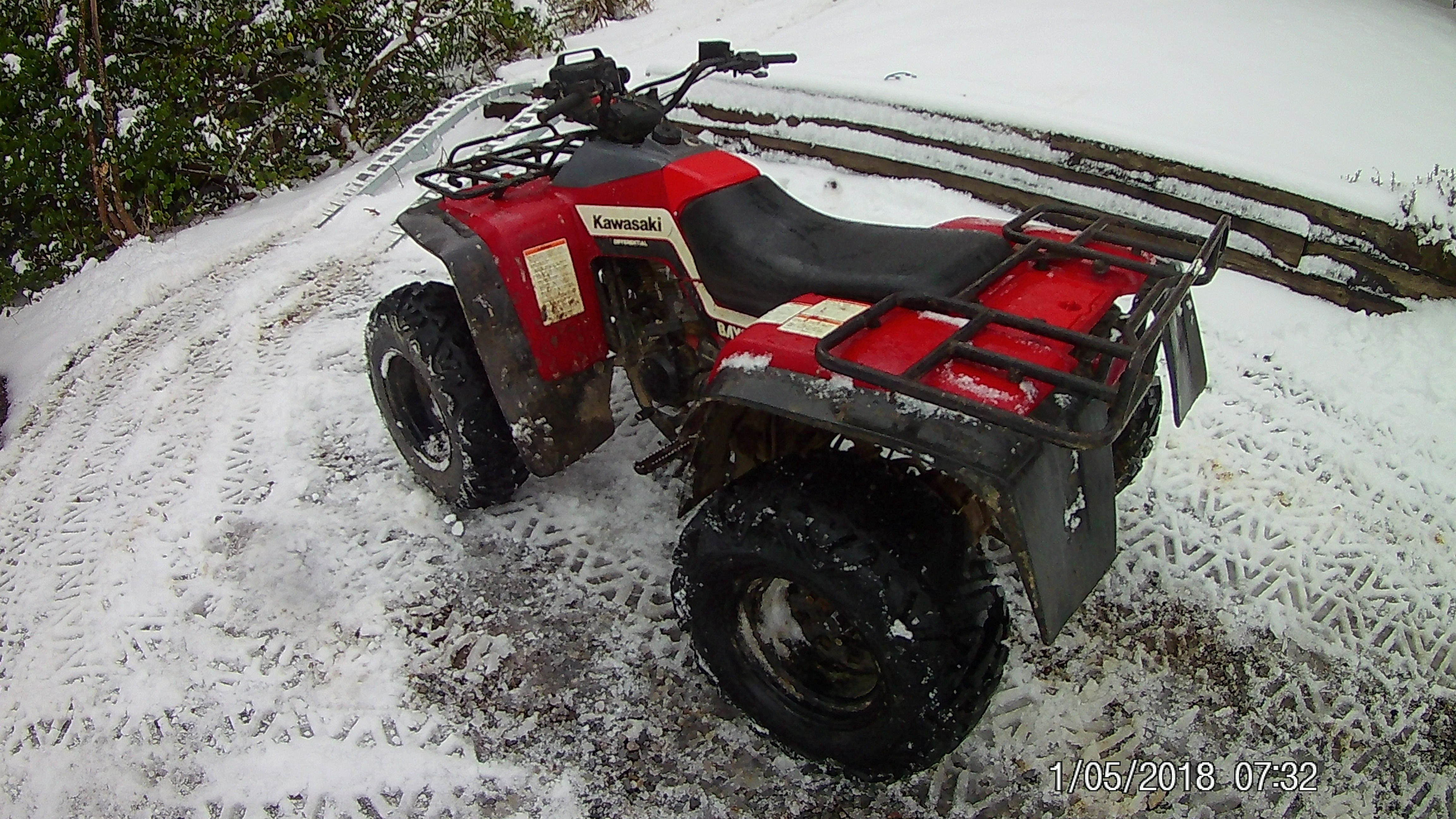

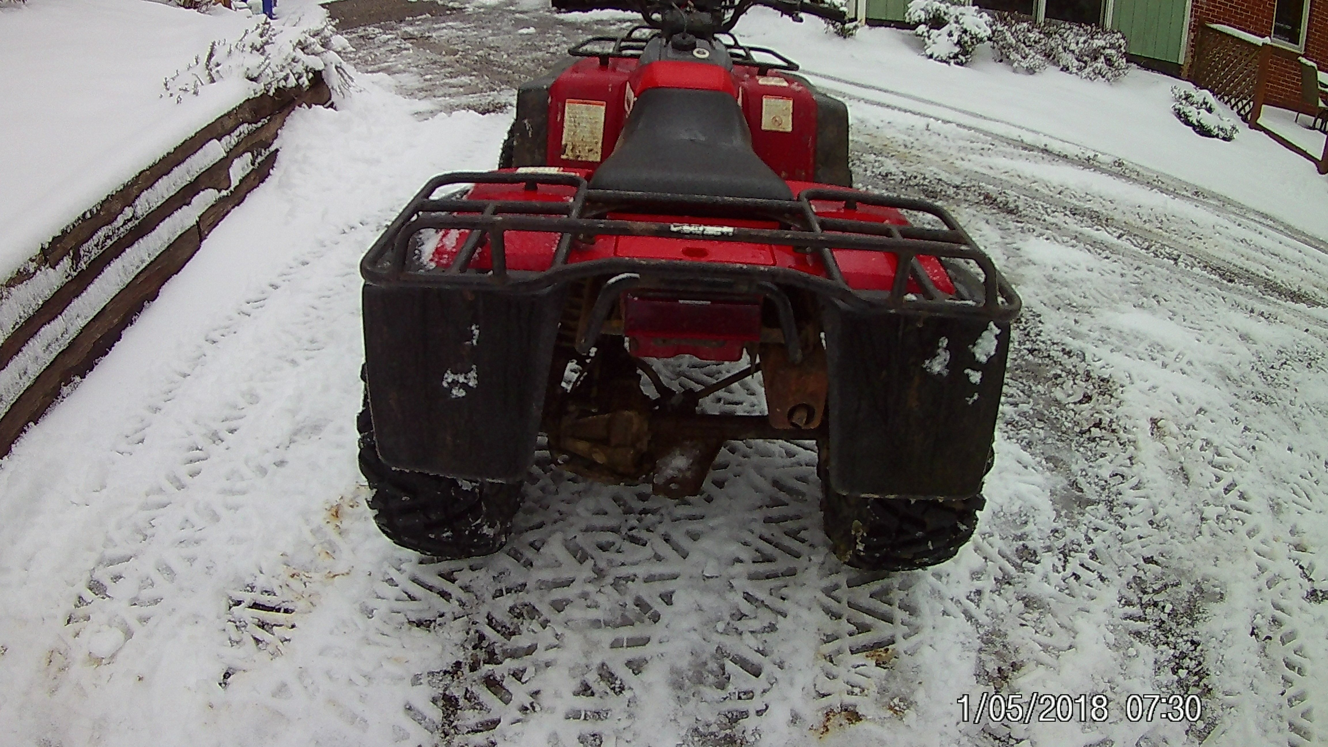

Btw, bayou is for officially for sale for $800 first come first serve lol  if you read this thread, you know all of it's history as far as I've owned it...  massage me privately if interested.
