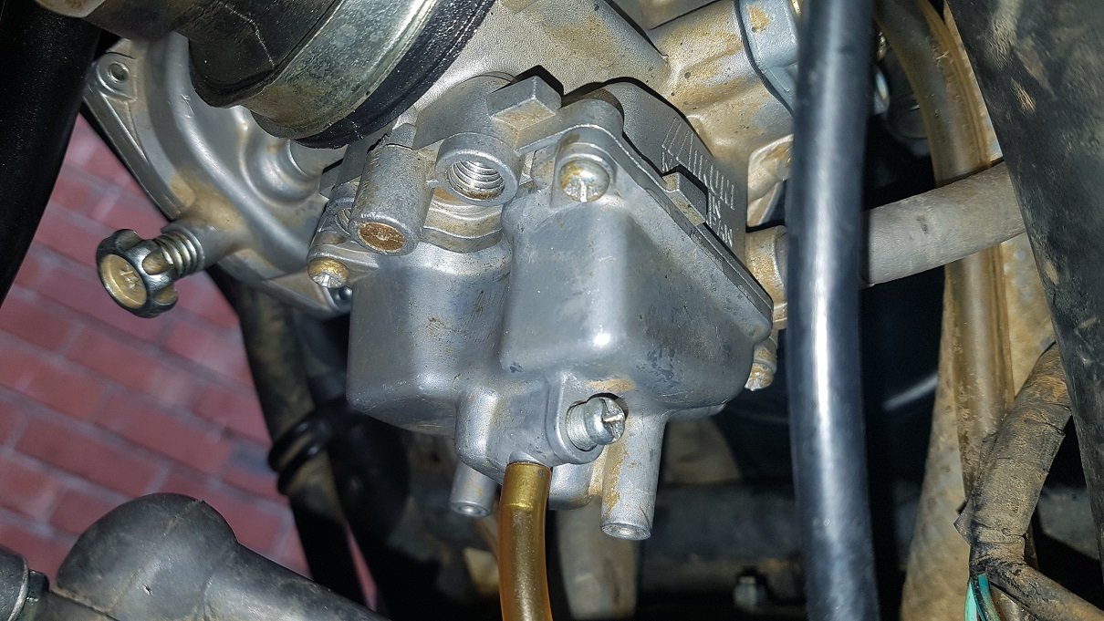

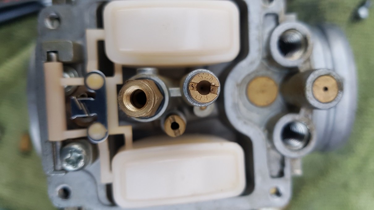

20190124_144001.thumb.jpg.d2dc3470259904ae574261eb94719a78.jpg20190124_132331.thumb.jpg.0c306f35d943c99e0d801afef64dee60.jpg20190123_151409.thumb.jpg.22d21c1da25b0ff292d52151f4aad1ab.jpg
Something does not look right on that carburetor.  There should be a jet inside that middle of the carb the main jet . Was it taken out? Also is that the factory carb the oem ? It looks like it’s a Mikuni
Ok that looks better. I didn’t see the last pic. See the  main jet in the middle.

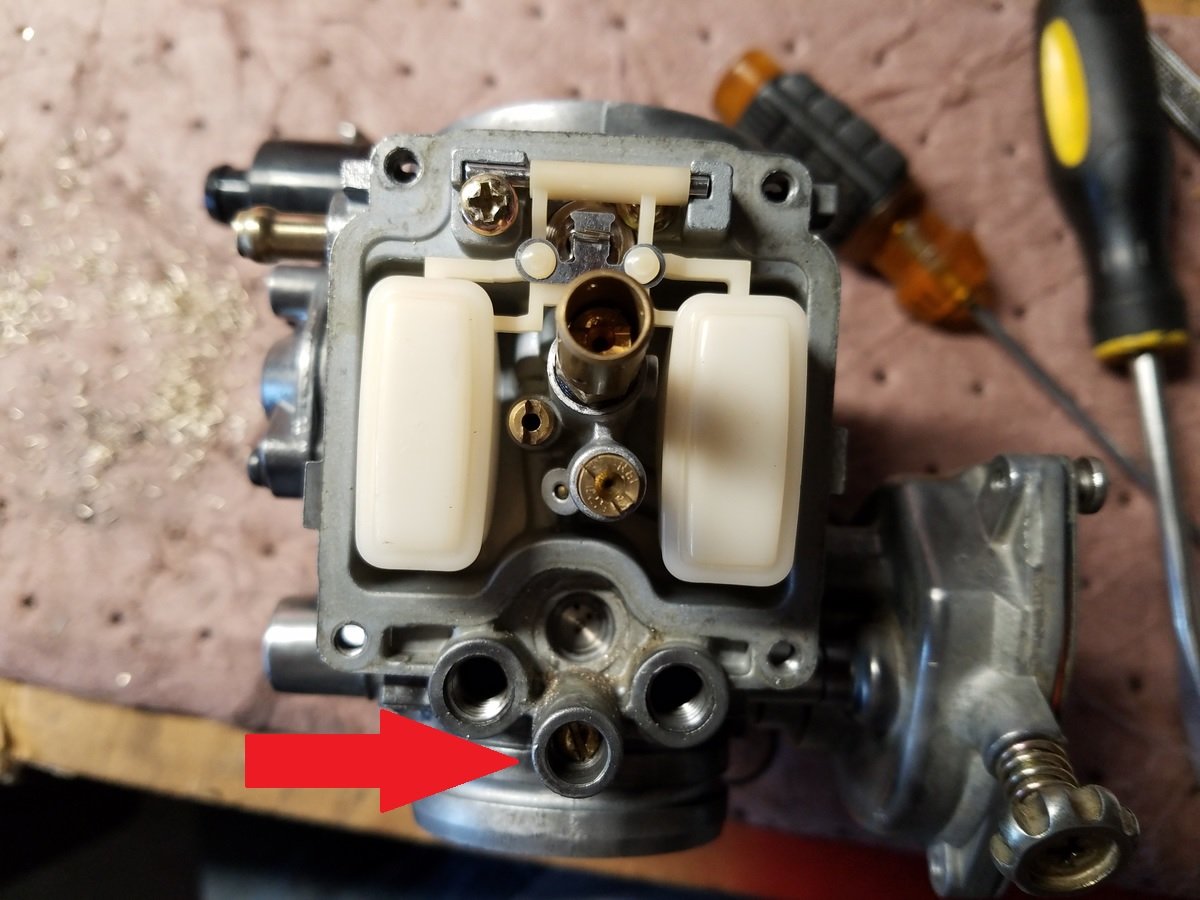

The one you have the arrow pointed at is your air fuel mixture screw.   You have to get the right screw driver to fit in and uncrew it.   Was it tightened down all the way ?
if the brass plug is in there yiu have to get a small pick and pull it out.
Is that your carburetor or an image of another?
Edited by Frank Angerano
The image with the arrow is one I found on Google. The large photos are my carb and there are 3 jets inside the bowl, I had removed the one to clean it and took the photo to get the number of the other jet, so all is normal internally.
I will have to strip the bike..........yet again 🙄 to get the carb off and try remove the brass plug. Bloody nightmare lol
I drilled out the brass plug and the jet was set to 105 minutes, not 150 minutes (2.5 turns out which is factory setting).
