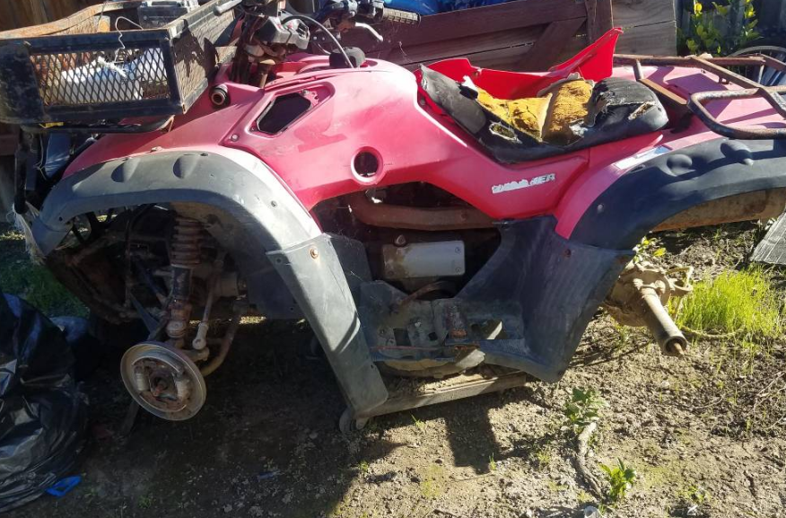

 I'm going to push the one that doesn't start: https://sfbay.craigslist.org/sfc/snw/d/west-sacramento-honda-rancher-350/6792299892.html
how would you test the one that we'd have to all lift or winch?

I agree that Hondas are crap as far as performance and durability.  If i were to drive a Honda like i drive my bayou (and that still doesnt hold up), the Honda turn out looking like the one above...  I know no life but the savage full throttle wound out life...  Polaris and Yamaha are the way to go
so.... debates aside, do ya'll pick up bikes like that wheeless rancher? and if so, probably no oil, so I'm checking mainly frame and suspension, possibly electrical? I should carry a spare battery now that I have a roll of bounty in the back heh

yea ok.  my main point was that a Honda could not stand how I drive atvs.  Did not mean to throw shade at anything, I would get a Honda to resell if I found a good deal too..  just wouldn't want it for myself.
