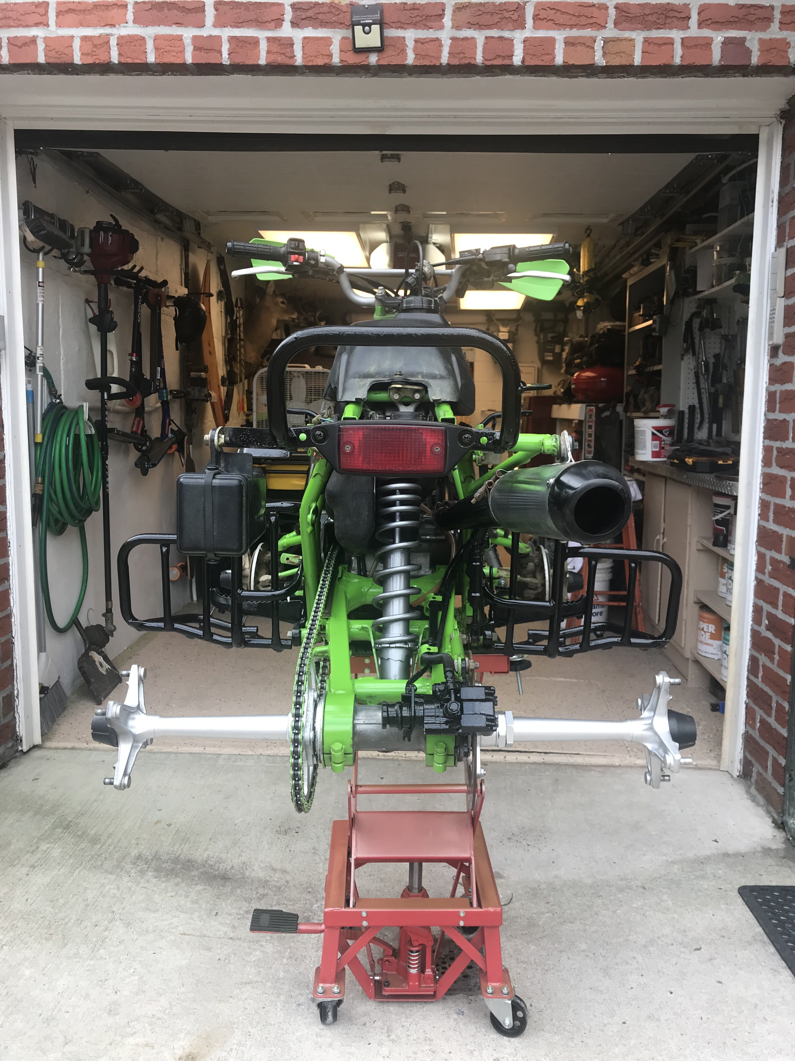

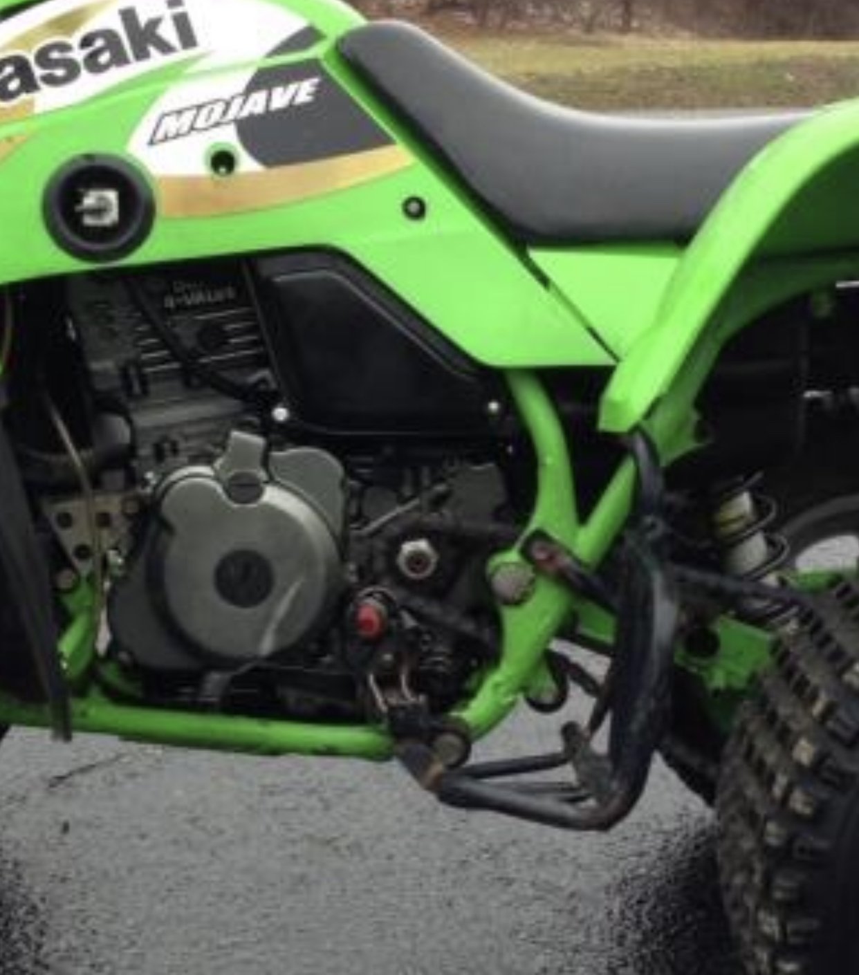

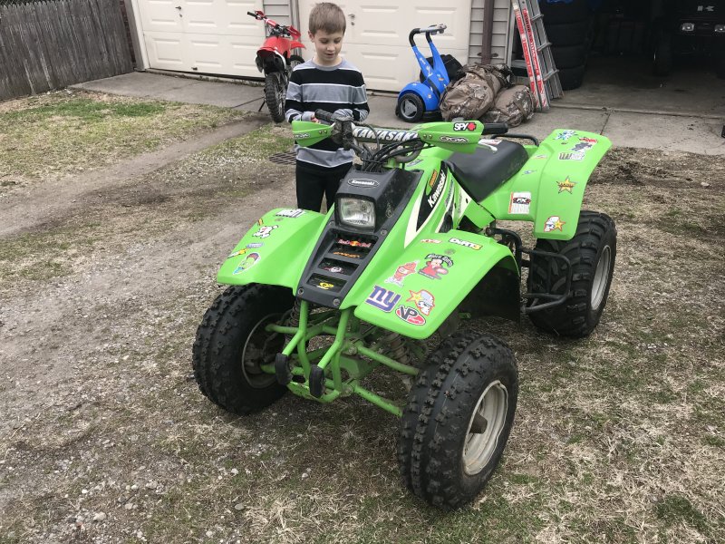

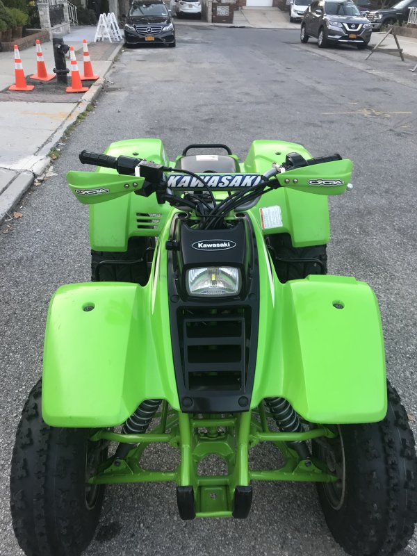

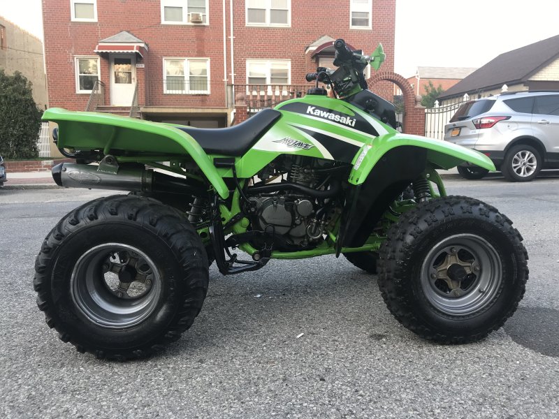

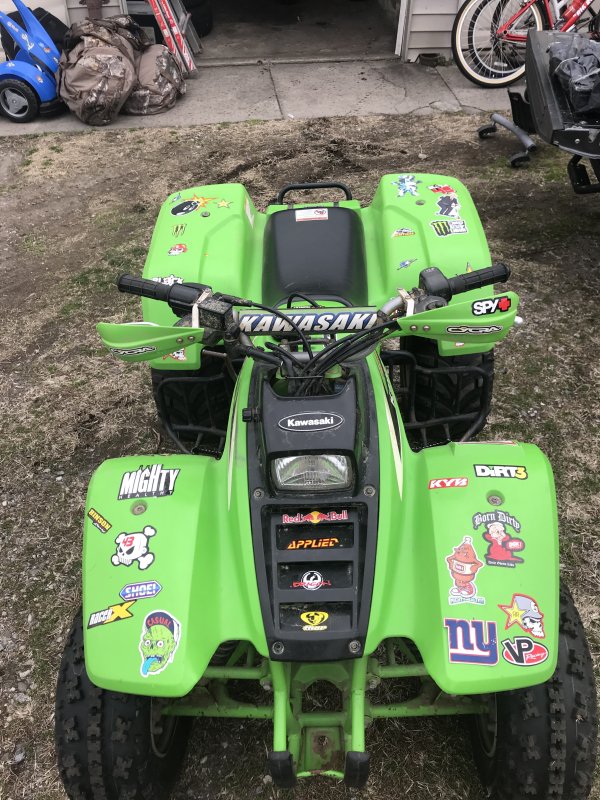

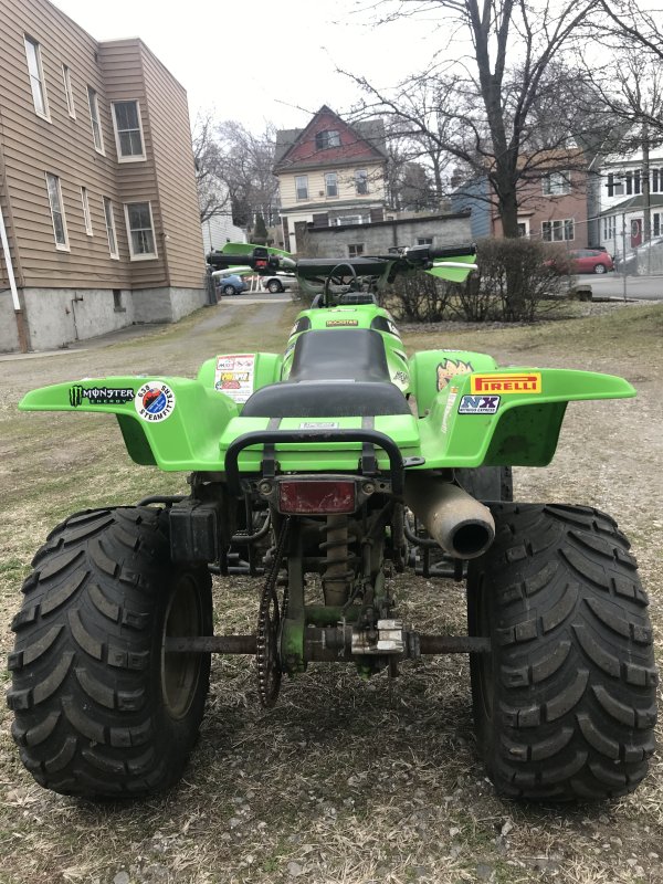

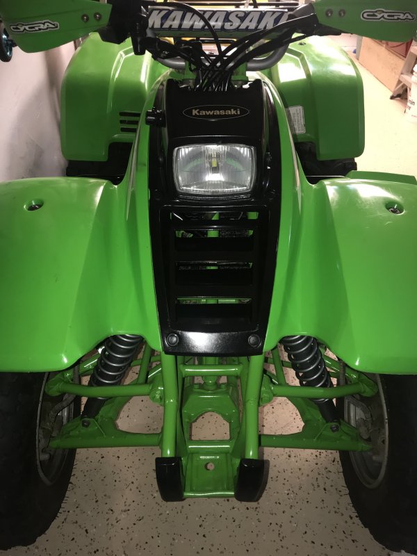

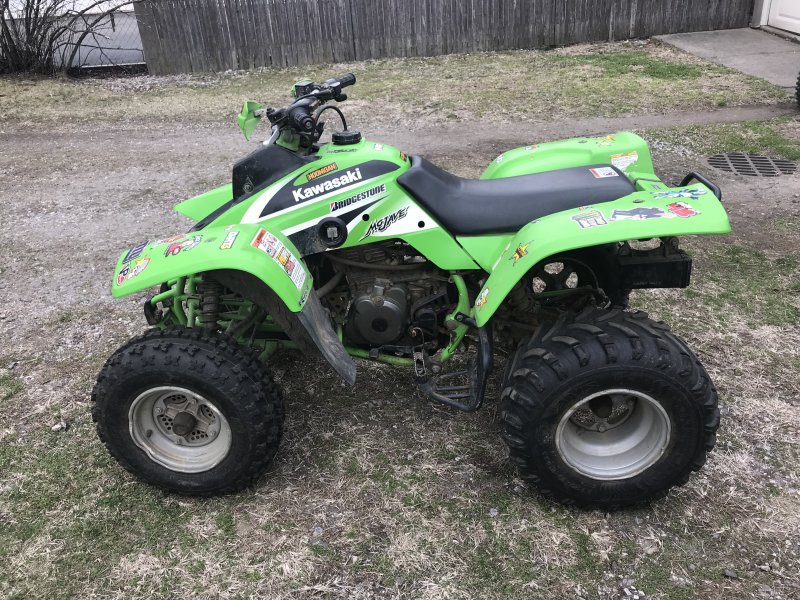

So here she is.  Finally dug it out and about to go into tear down. The last owner was a little sticker crazy 😝 aside form the NY GIants sticker!
The bike is in perfect condition mechanically and ascetically.  No cracks in the plastics etc.  just dirty and sat for quite some tome.  Going to wash her down and take it to pieces, clean it up and fire it up!  More pics to follow.

Awesome bro. I remember that quad from way back in 91. I even had a matchbox toy quad.
I have a grill that doesdnt have the headlight in it if you want it.

Thanks @06kfx440  she’s all in tact! Just need to get her fired up.  I thought I would be able to work on it this week but temps are dropping.  Going to leave it be for a few days in my garage and take a few parts off for now. Can’t wash it down just yet.

I paid $300 if I remember correctly. I picked it up back in November.   Put it in a garage I rent a mile away from my house and it sat.   I wanted to wait until it got warmer out. So I picked it up yesterday and brought it to my house and it’s ready to be torn down a bit this week. But it needs a good wash down first.

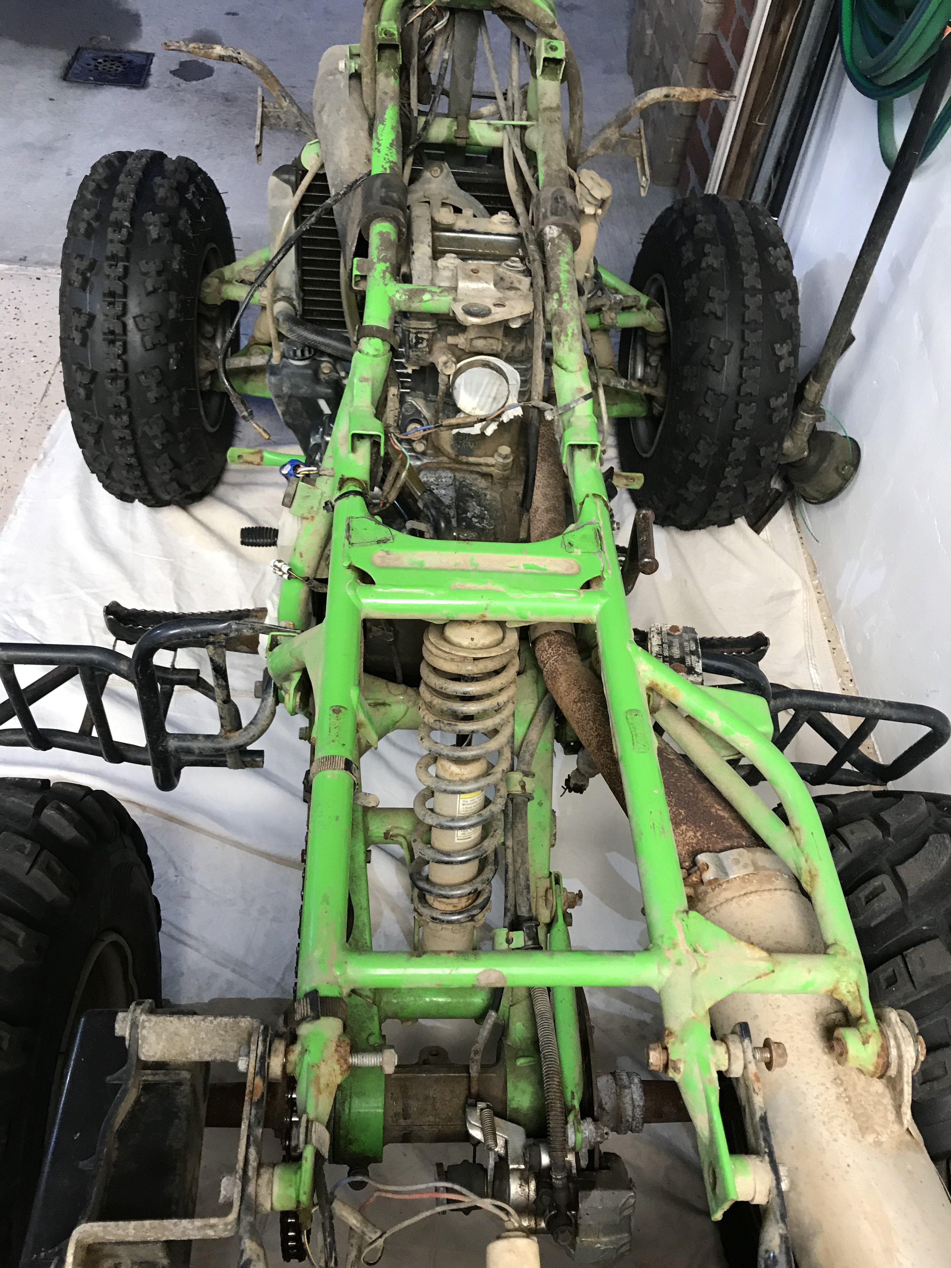

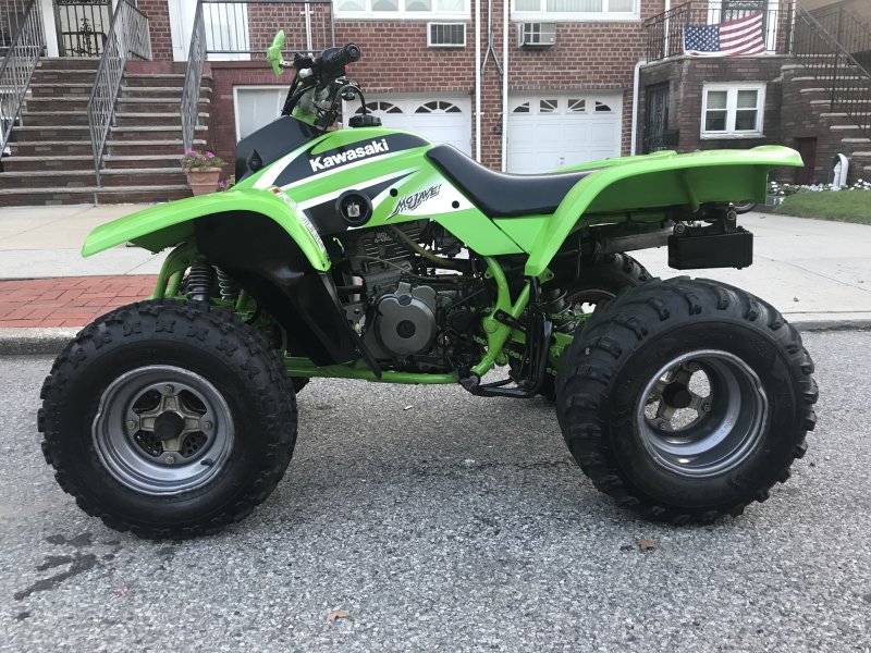

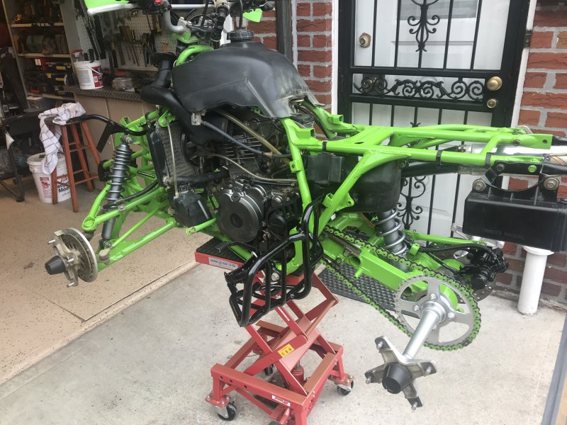

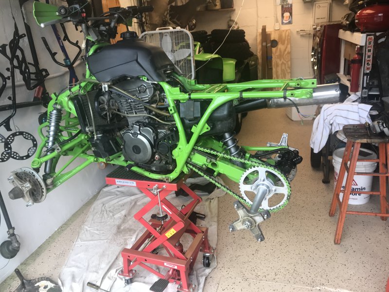

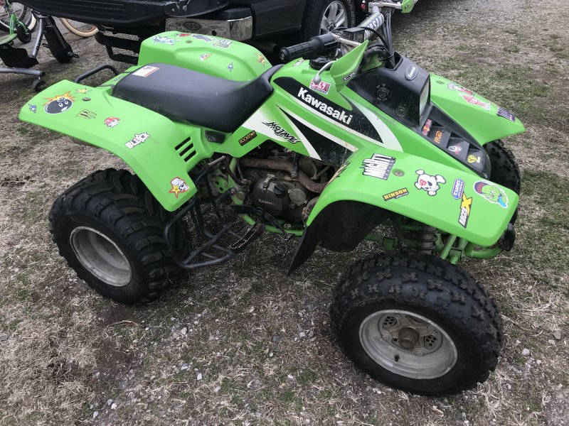

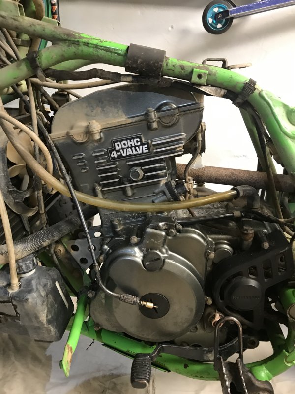

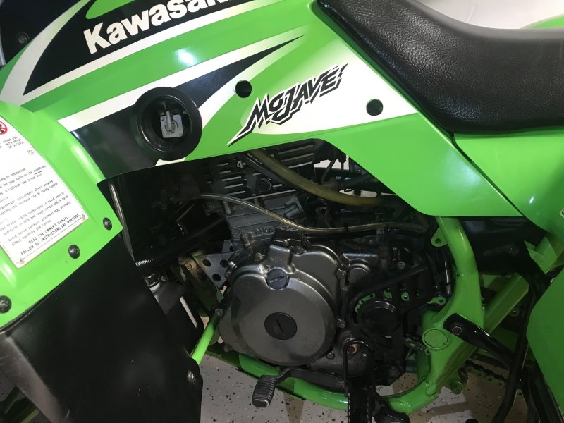

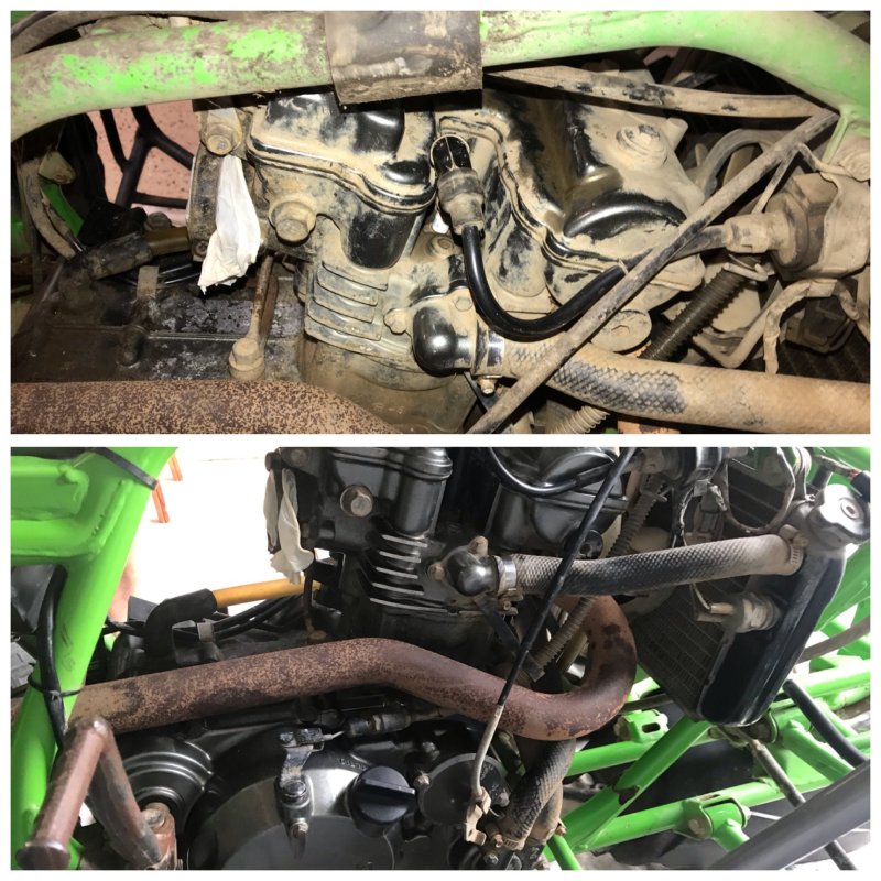

So here’s some updates. After a few months I finally got around to getting this thing into my garage.  I was in the middle of giving my garage a little makeover and needed some time to make some room, clean up and throw some old shit away.
The bike is in great shape just super dirty and in need of a what I like to equate it as a colonoscopy! Lol.
New parts are ordered and on the way. Clutch, chain, plugs, paint and a new bulb for the headlight.

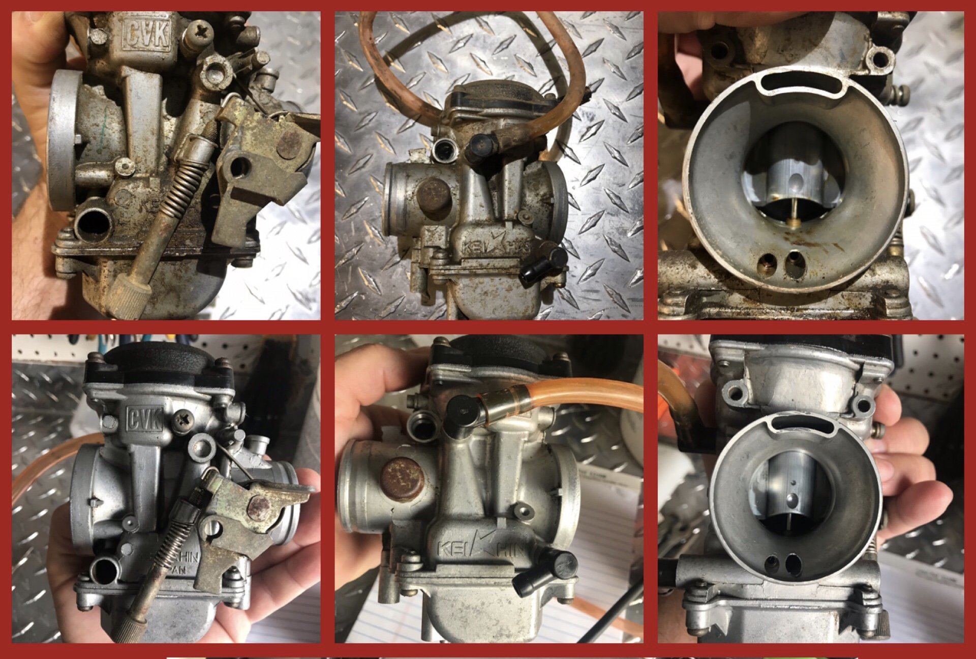

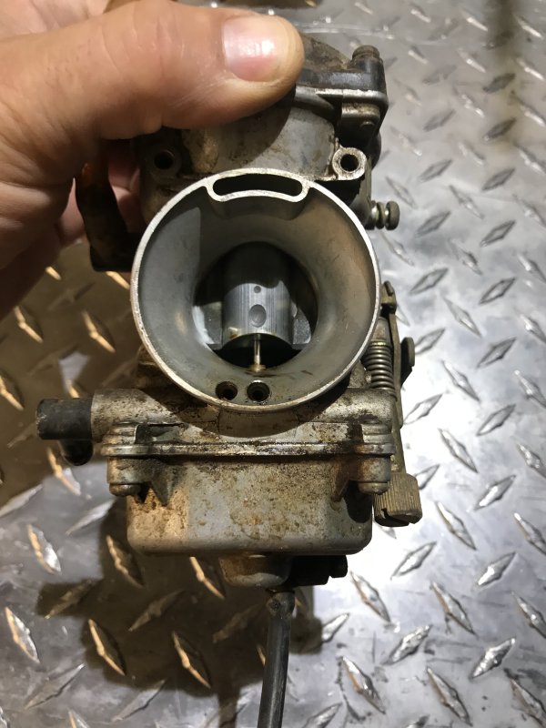

I found that the carburetor has 100% been opened up and tampered with.  I can’t read the jetting so I’m assuming they are the oem stock jets 🙏🏻   However the air fuel mixture screw was set at 2-3/4 turns out. The specifications call for 1-3/4 so I guess we will have to see after it’s all back together. I’m going to set it at the spec and go from there.

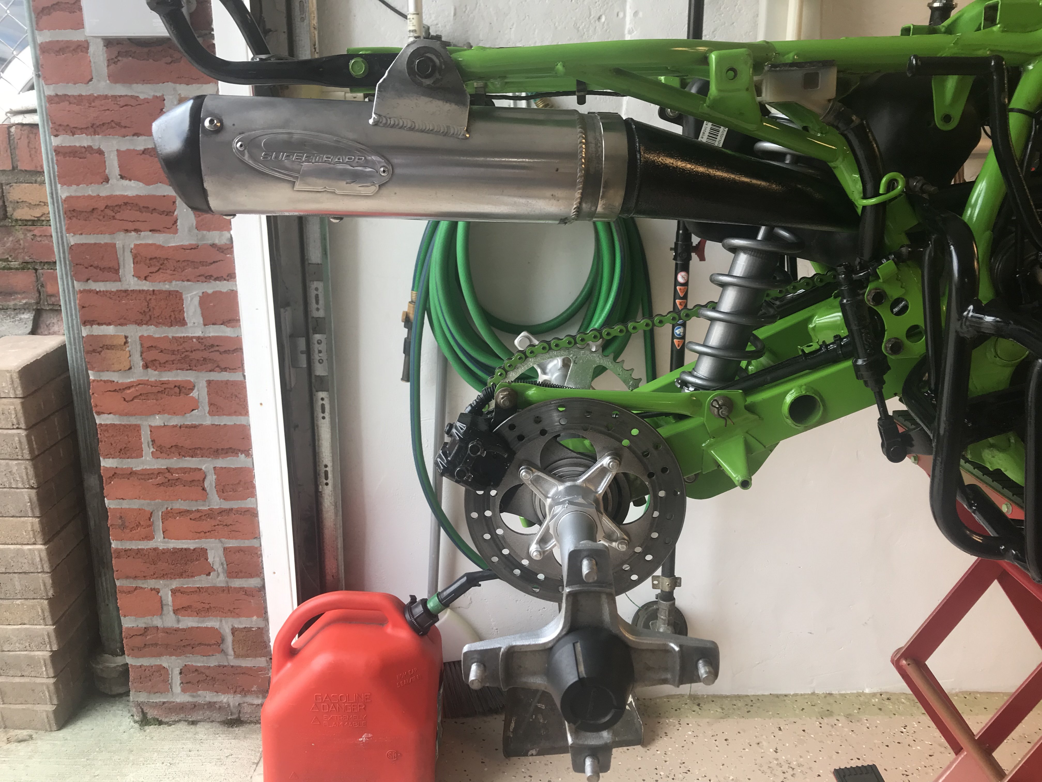

The machine has an aftermarket exhaust and I think that’s it for upgrades. I’m not opening the head up to see the cams or anything else because it seems to be in time as far as I can see and compression is good with a smooth turnover and the head bolts as well as all other engine bolts and nuts don’t appear to have any wrenching marks on them so I’m guessing it’s all stock.
More to come soon!

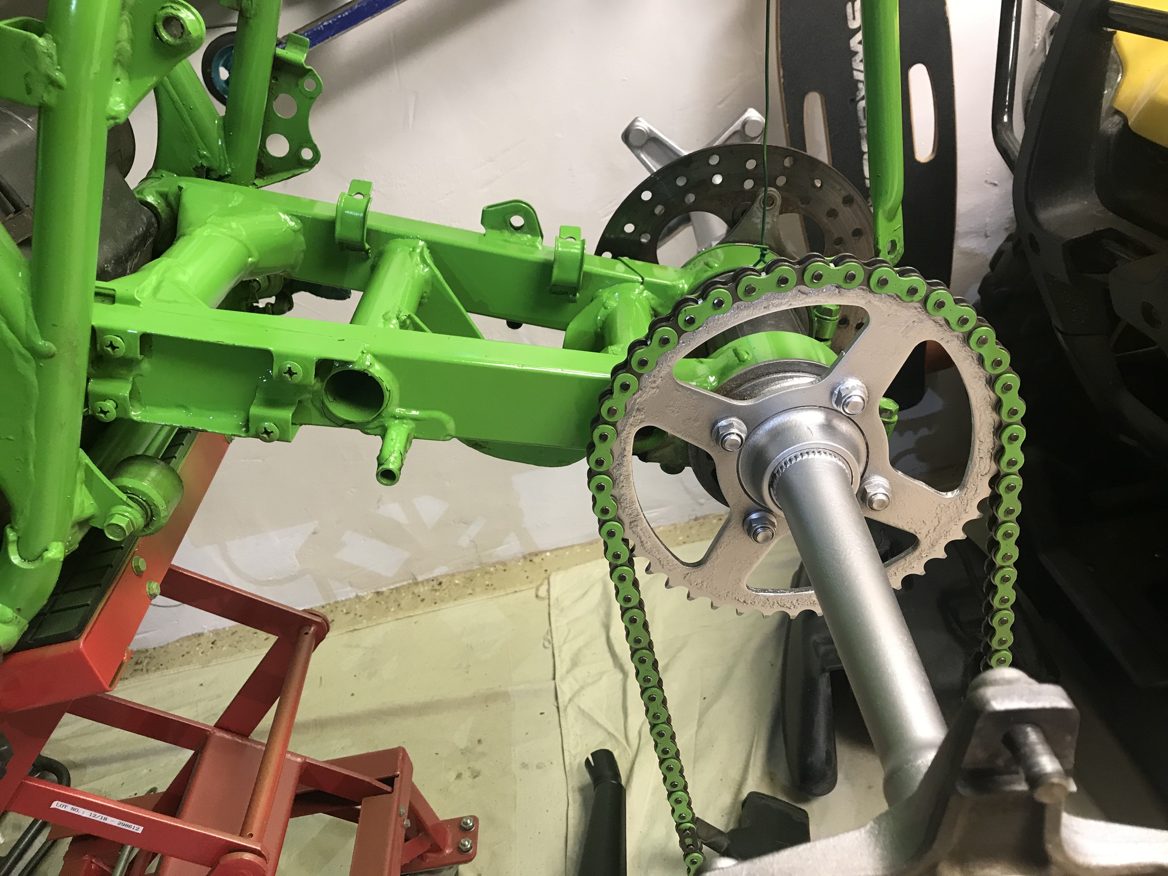

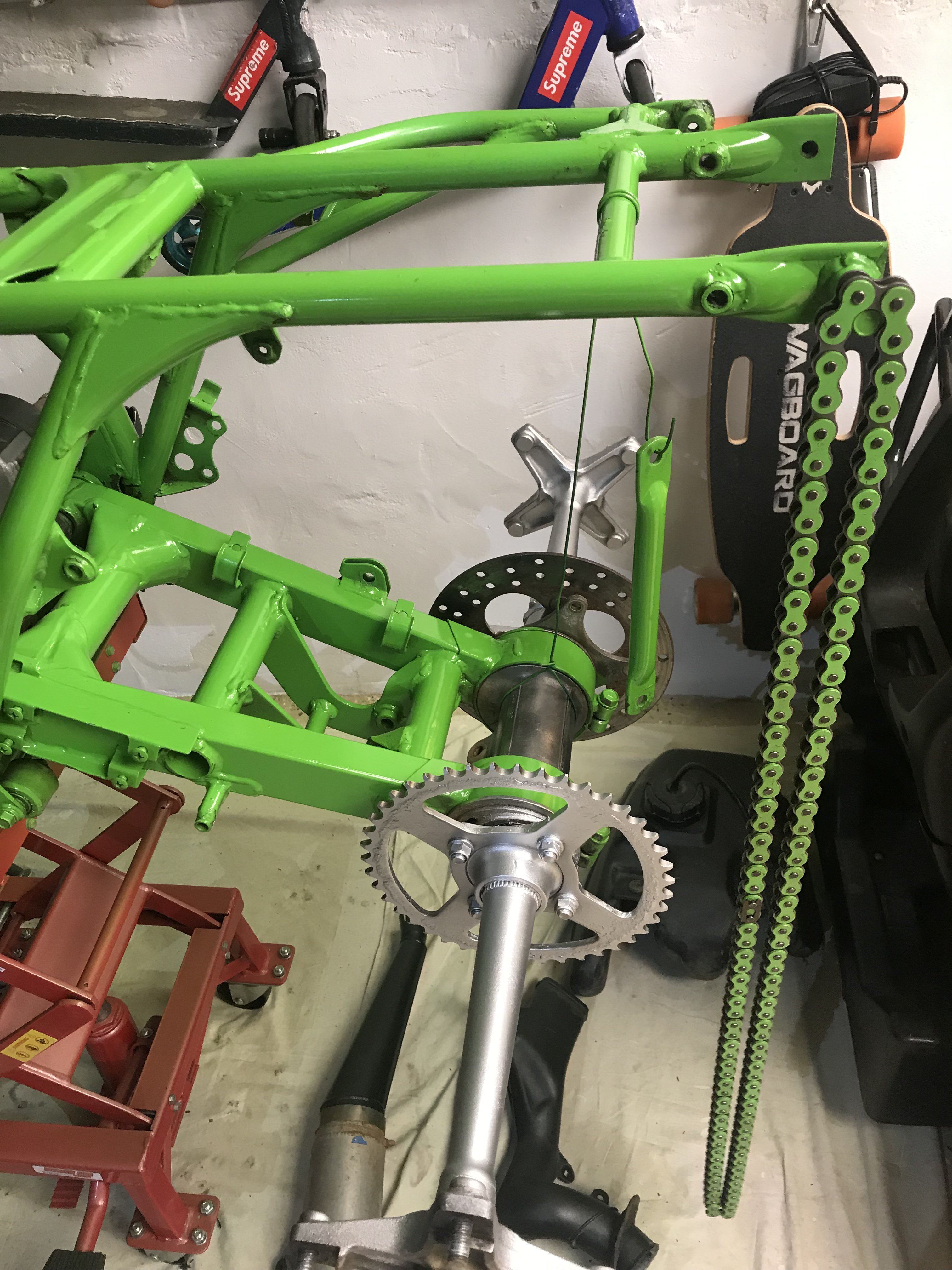

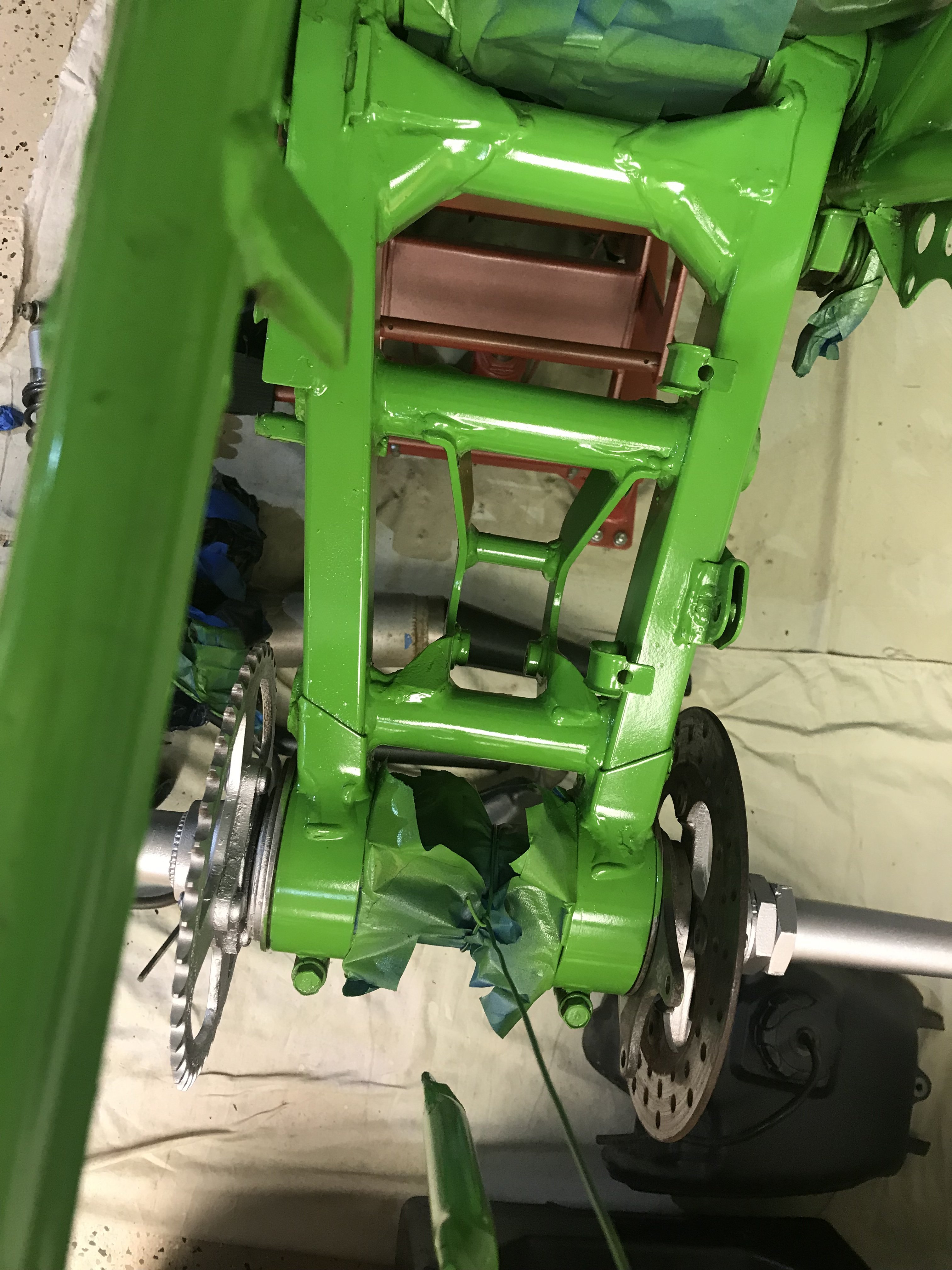

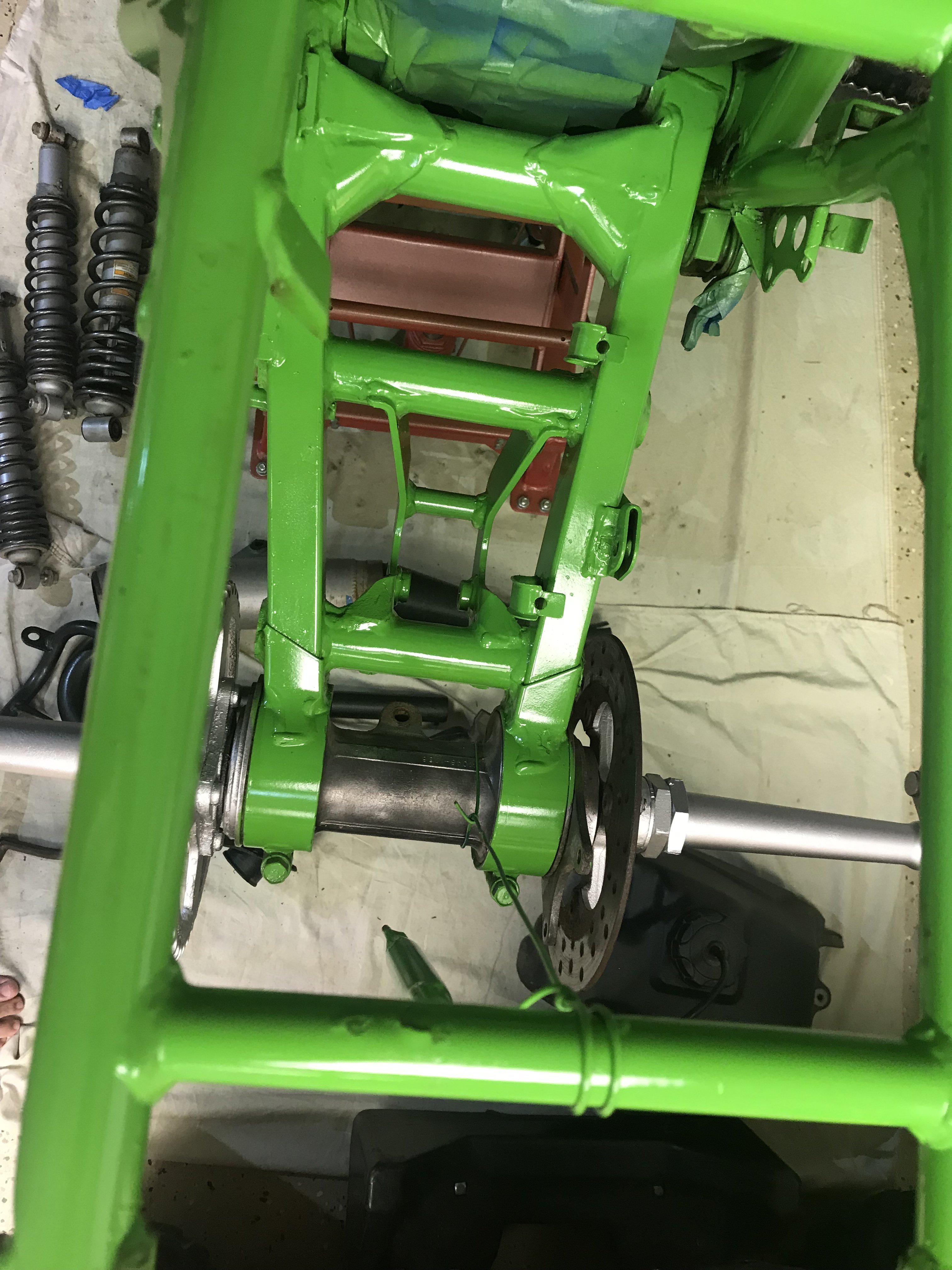

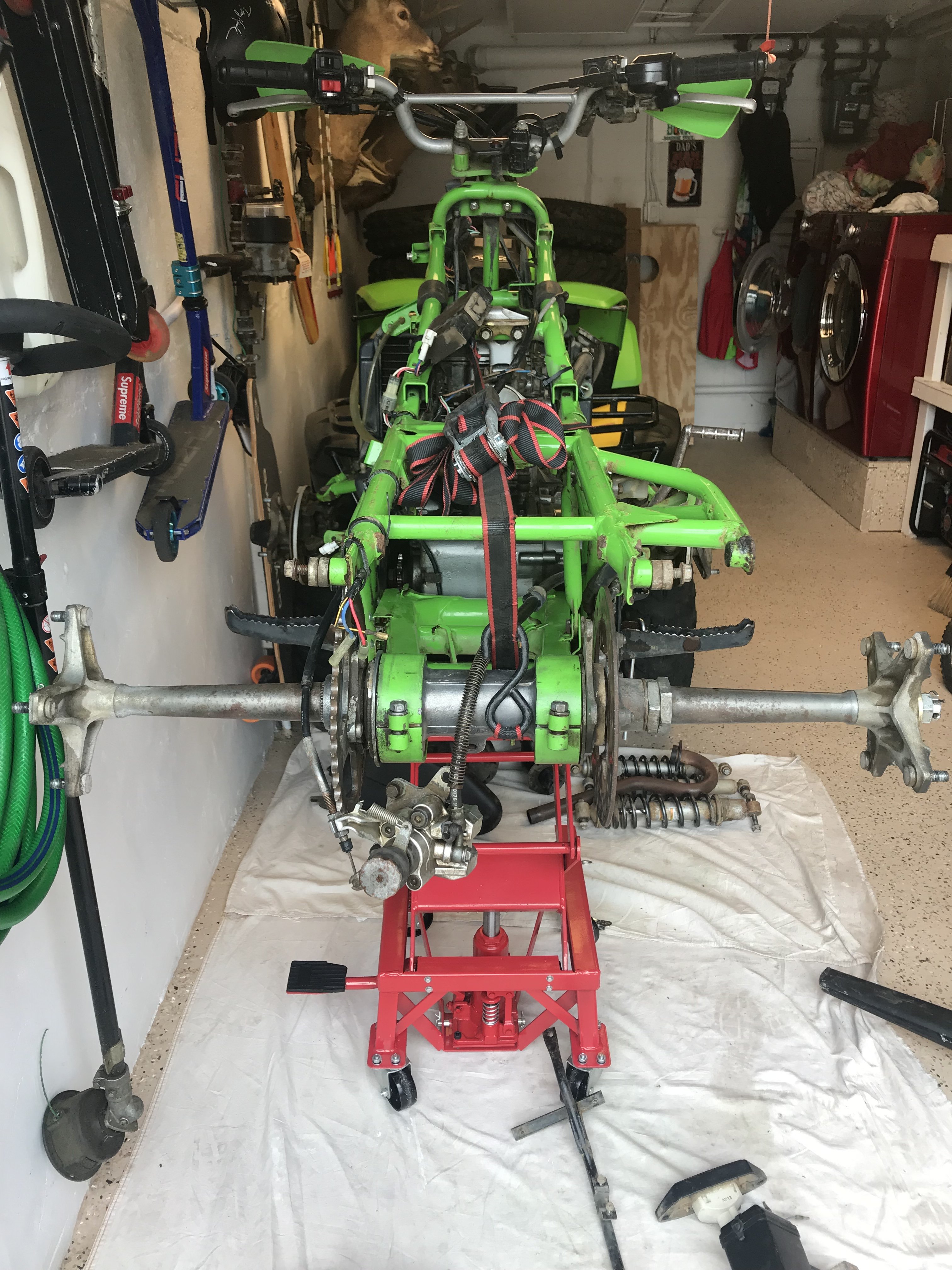

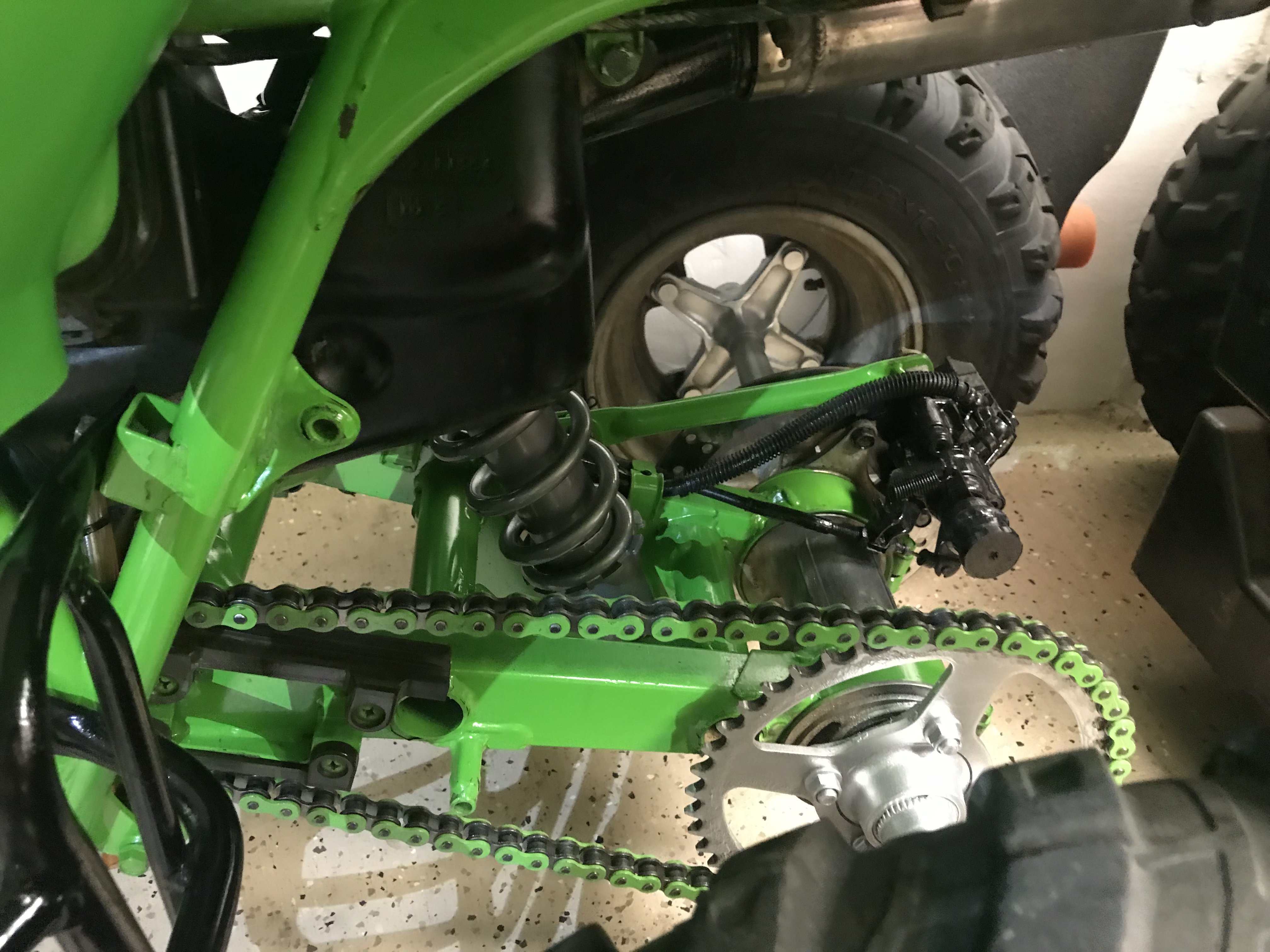

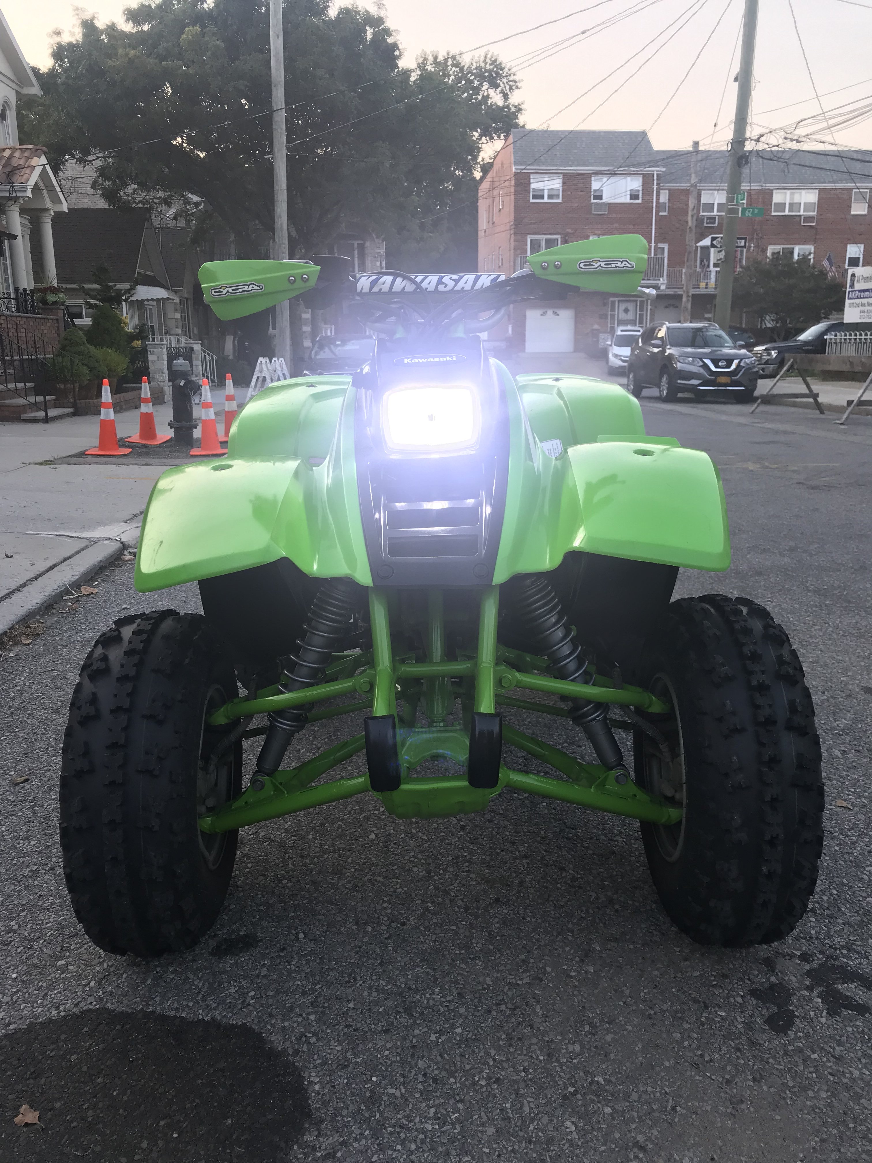

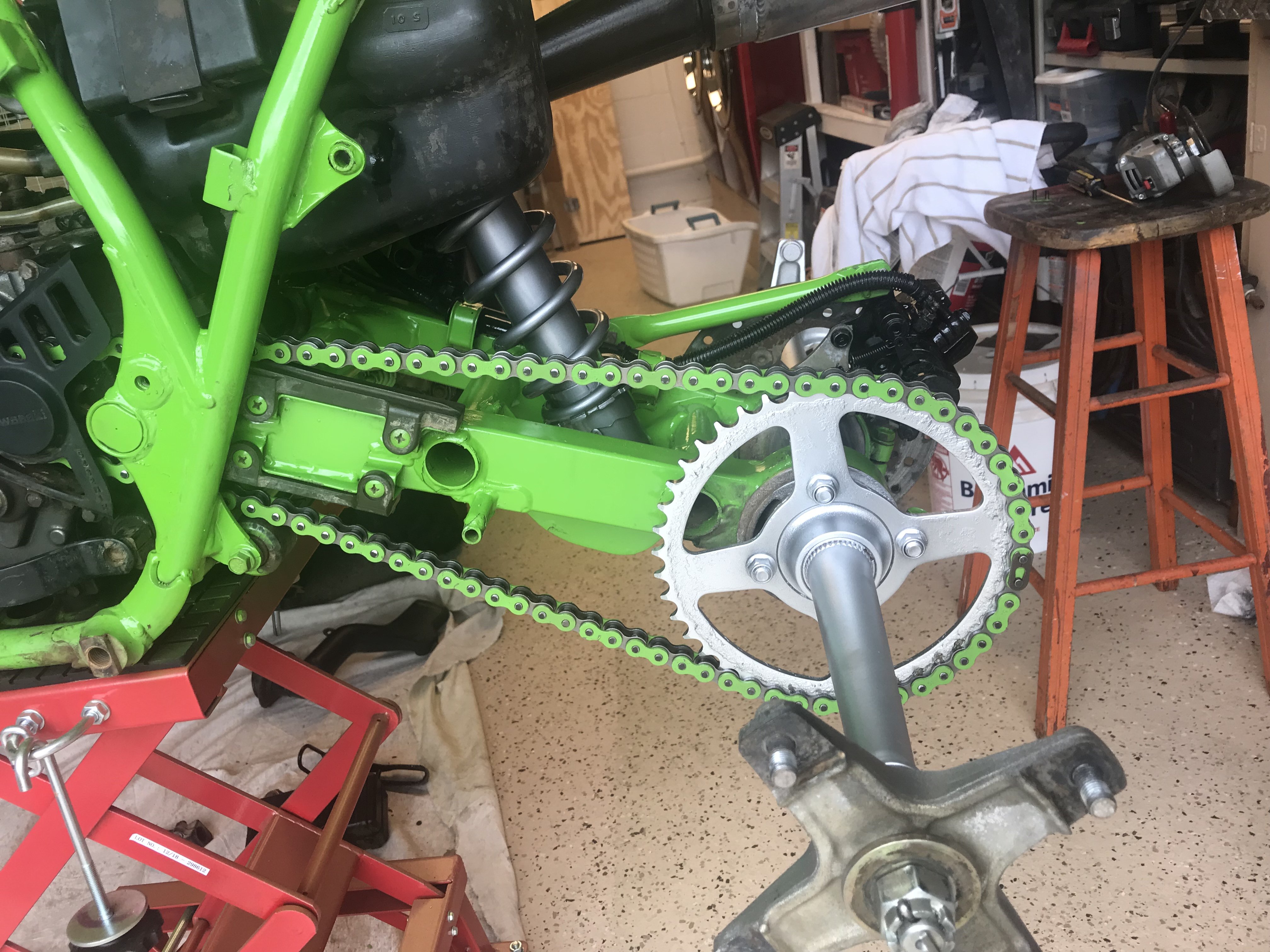

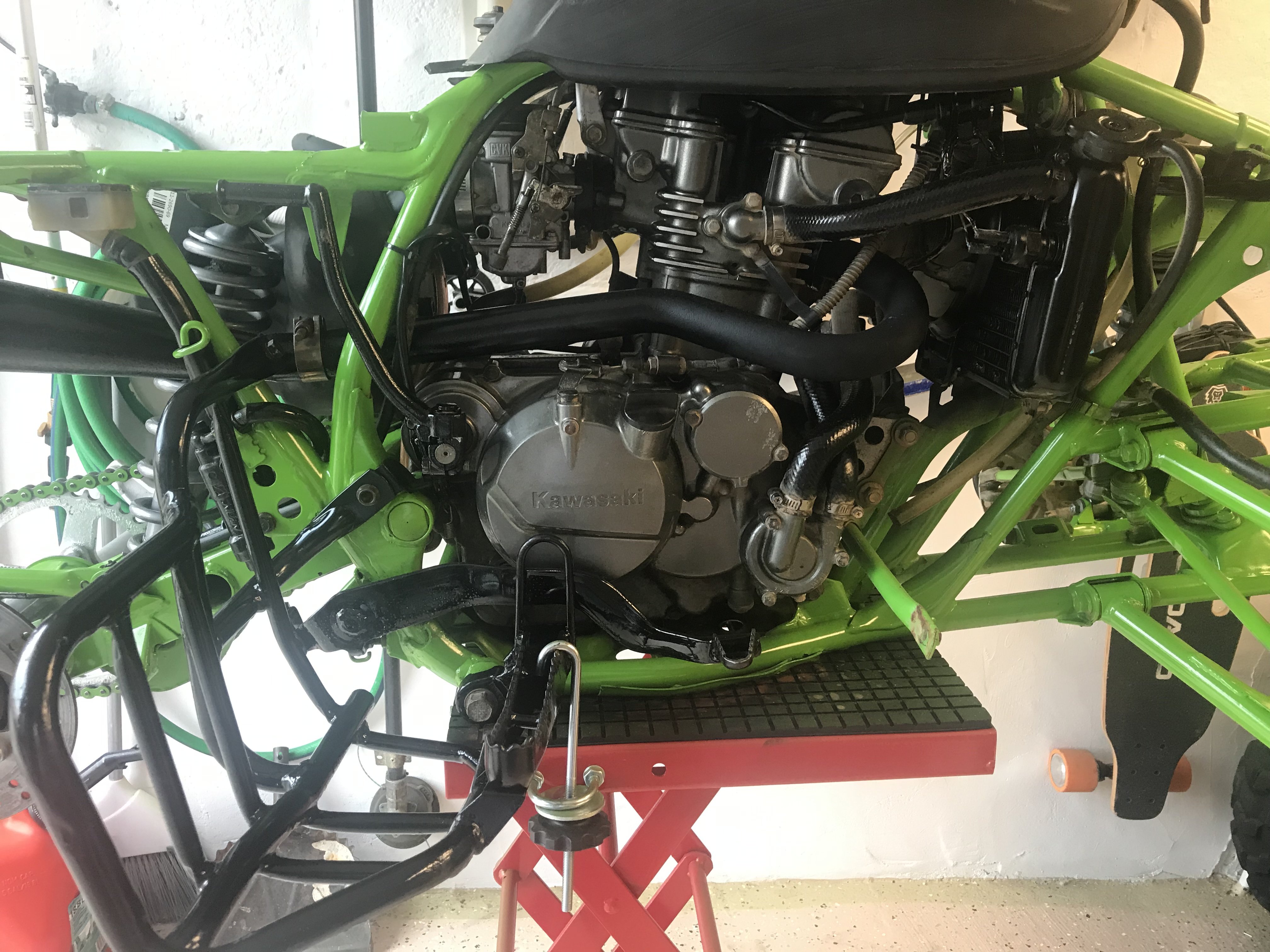

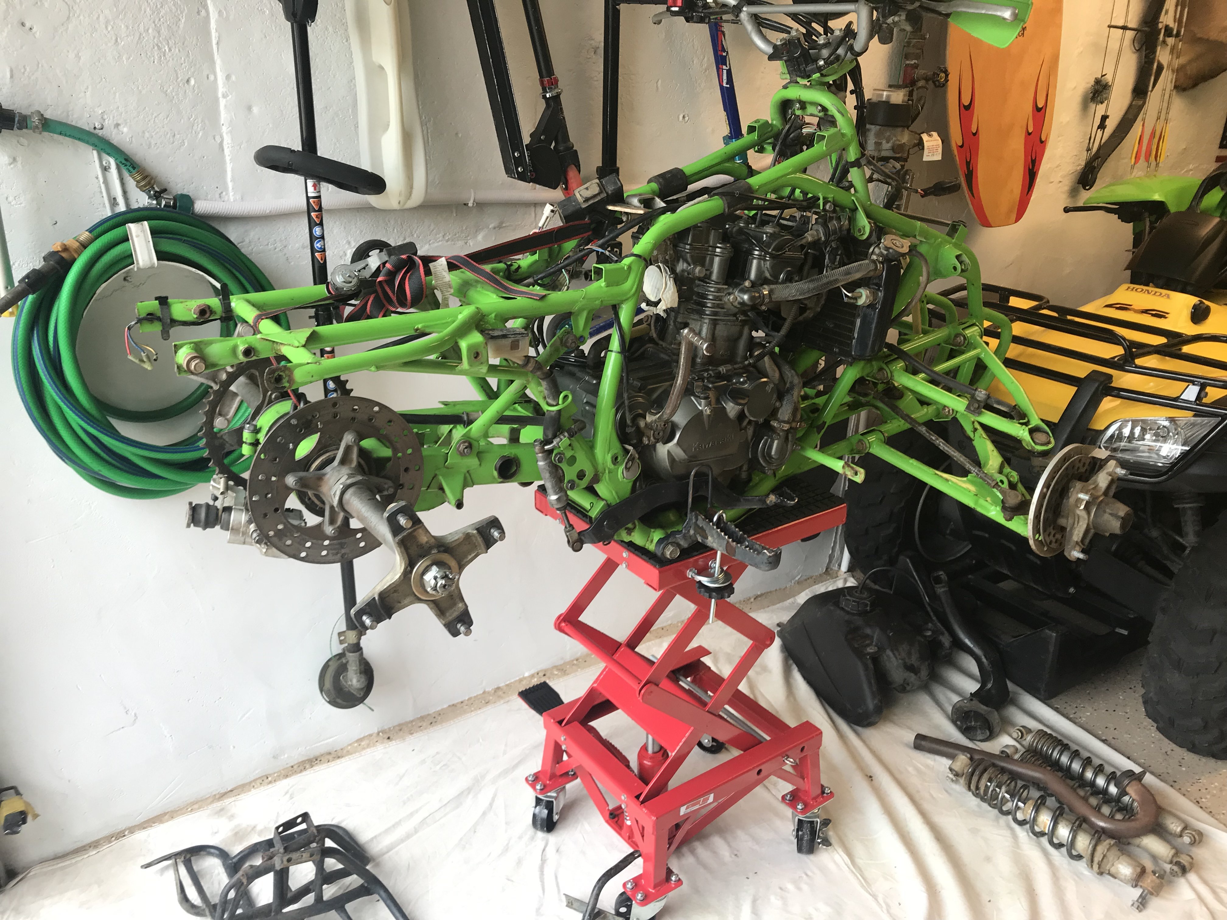

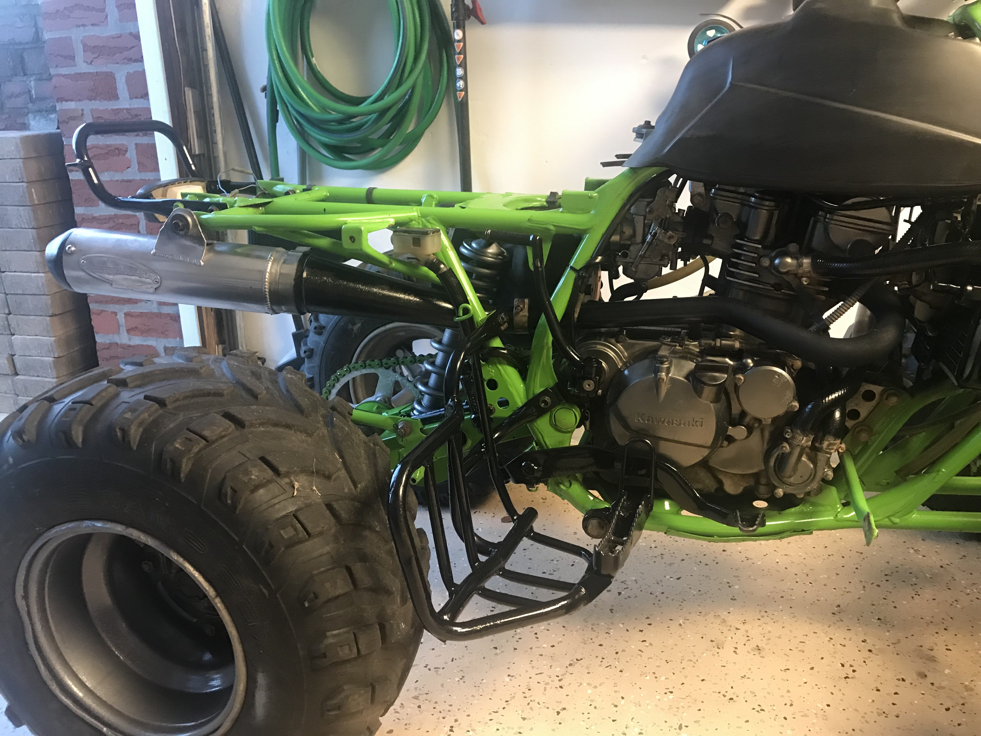

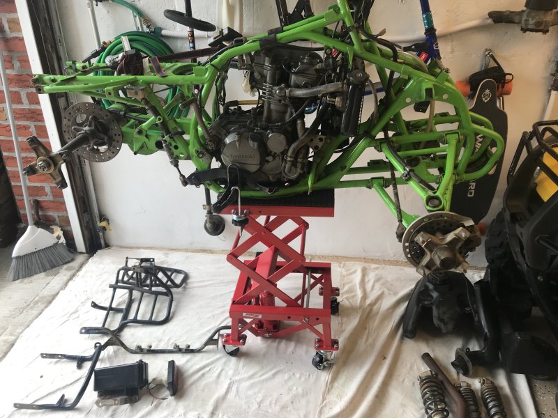

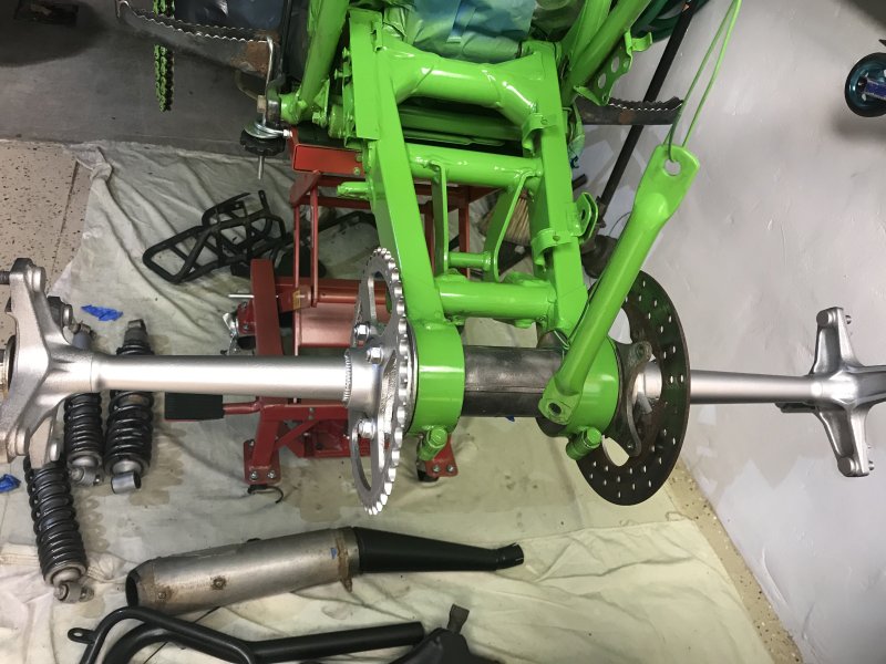

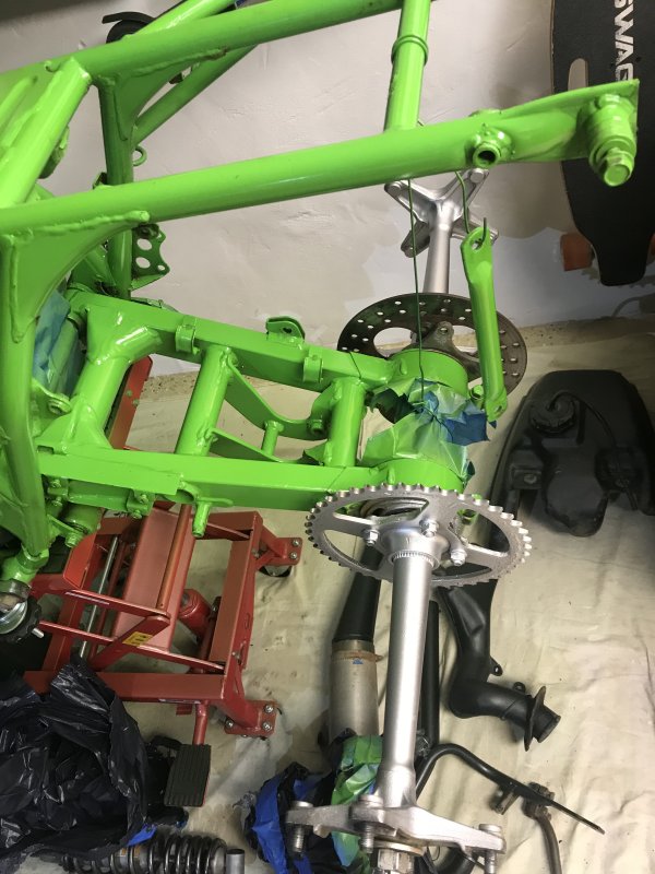

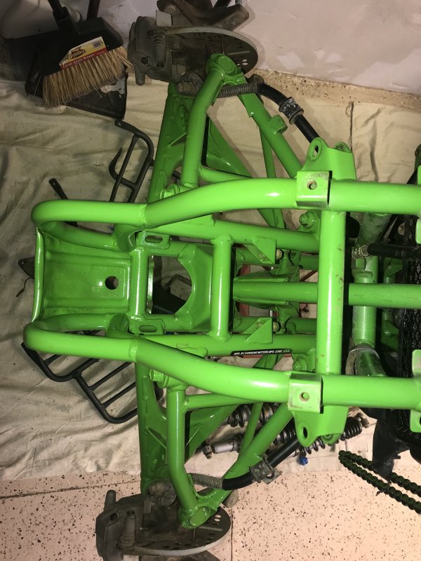

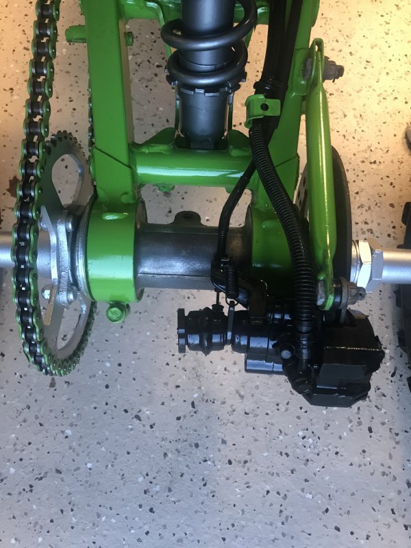

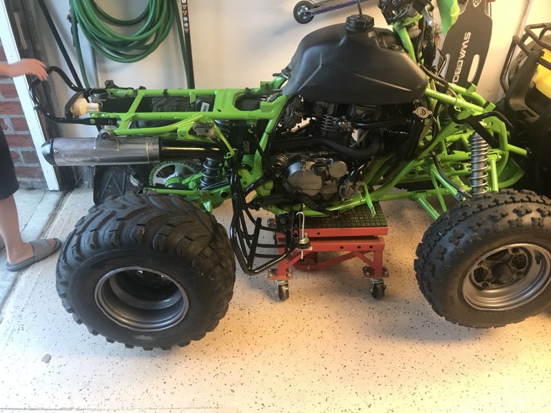

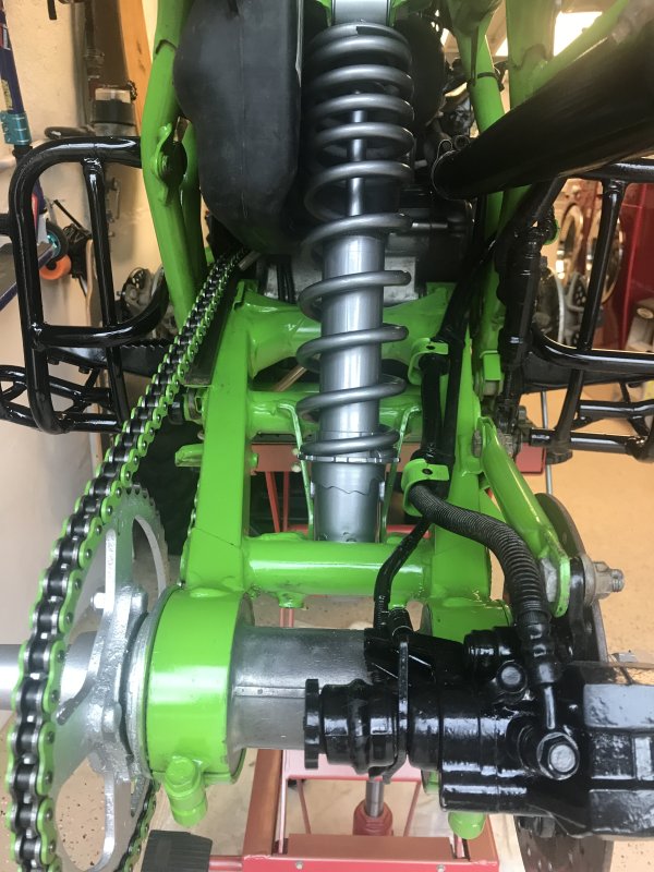

Got the carb broken down and rebuilt. It all seemed in tact and usable.  The jets were a little scared up from what appears to be marks from using the wrong screwdrivers on them.  I filed the scuff marks down and polished as best possible. If there are any performance issues I will swap them out with direct replacements.
Engine is finally clean and ready to come off of the frame.  I ordered a bunch of parts that are in route.  Oem Kawasaki green paint for the frame and a few other goodies for the engine and sole cosmetic stuff.
Overall it looks like I will be into this thing for about $700 to $750 bucks If I don’t need anything more, that’s including the quad itself and not my labor of course.
So not bad so far but that’s all speculation for now until this thing fires up and runs.
But honestly I absolutely love tearing these older machines apart that have been sitting around and bringing them back to life!
Little by little and more to come stay tuned!
