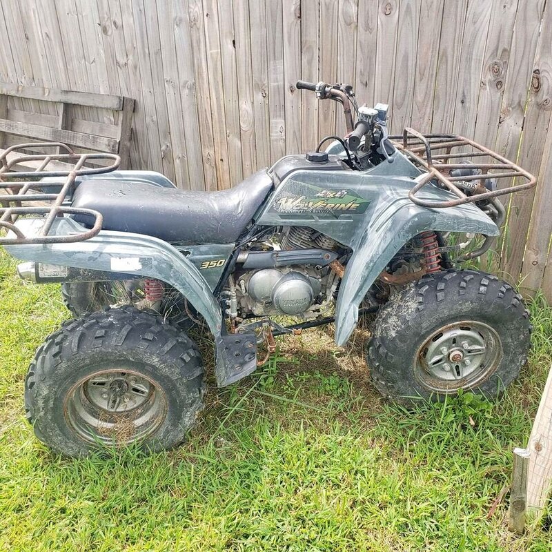

01 Yamaha Wolverine 350 Front drive Shaft
Go to solution Solved by Mech,
What years were the 4x4 made?
3 hours ago, Mech said:
I looked up wolverines for 01 and 02  and they weren't four wheel drive.. Might pay to get the frame number. I think it will be on the lower left frame right near where a foot gear shift would normally be.
I just looked it up and it says 4x4 was made 1995-2001.
Ok, so if you look it up in partzilla, and choose the part as though you were going to buy it, and then click a tab called "product fitment", it will tell you what other years and/or models the shaft fits.. And if you take that genuine part number and put  itinto google it will find you some driveshafts for sale.
Thanks, that is what I have been searching. So this is what I found. The 1995-2000 front shaft is the same as the Big Bear 350 and Kodiak 400. The 01-05 front drive shaft is listed only for the Wolverine. Not sure what changed from 2000 to 2001? Trying to find something I can modify to fit.
