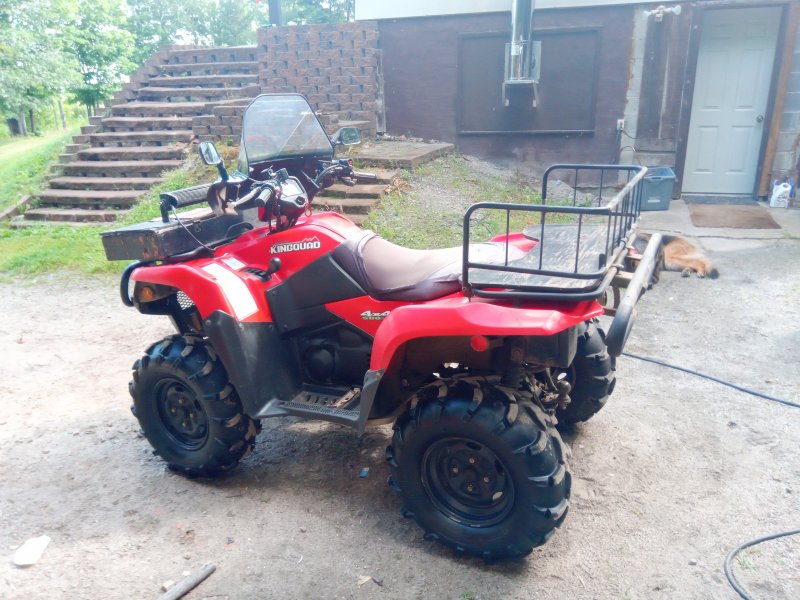

    • By captnunu
      I have a 2007 kingquad 450 fuel injection. I try to start it with the hand crank and almost flip over the quad. I have taken the hand crank off and cleaned it but this did not fix the problem. I believe there is a decompression valve that is supposed to engage when pulling it over by hand. How can I check this?
