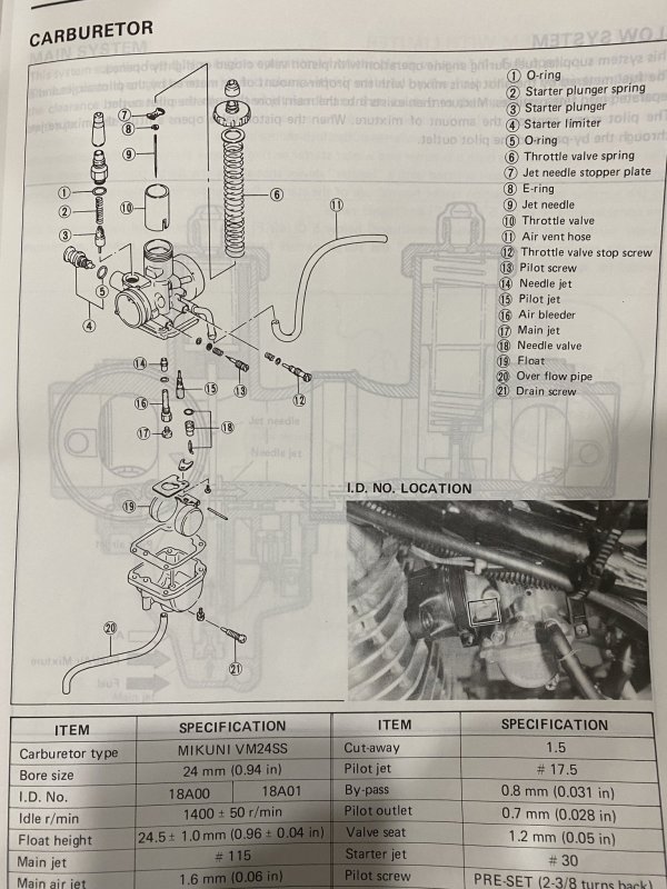

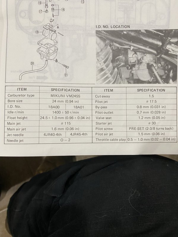

I have a86 LT quadrunner 230 shaft drive and I decided to do a rebuild on my carb a few months ago so I ordered a Shindy rebuild kit witch I have used on other machines in past and always was very happy with results. So problems start right after rebuild on my Mikuni VM 24 ss carb right from the start I had high rpm i couldn't control I found a hole in intake boot on fuel side and changed boot then I couldn't get enough fuel to carb I changed and used a OEM fuel pump I changed all fuel lines all vent lines all air box ducts and all parts are OEM also new throttle cable new fuel valve new fuel strainers in tank basically total new fuel and air system all OEM ! So I wind up finding a guy parting out same exact machine on ebay and has 2 OEM carbs so I buy both and 2 Shindy rebuild kits and rebuild them and still have same problem machine bogs out under load, finally fed up I buy a cheapo Chinese carb for 35$ and machine is running good not great but good ! So the other day cheapo carb starts leaking and I pull it off and take all of the OEM carbs go through them clean them again, not that they were dirty I use non ethanol fuel but they never worked anyway I install one same problem I go through all 3 same problem bog at load and one wont even idle at all so I fix leak on cheapo carb put it back works fine. Here is my thing im not a proffesonal mechanic but have owned and done enough work on machines that  I have owned in my 54 years of life and  I can not see me rebuilding 3  exact same carbs wrong I used Shindy rebuild kits on all 3 so are these kits reliable? I feel my main jet needs to be drilled out but why when im going stock with machine and its supposed to be 115 ? Anyone else experience problems with Shindy kits are there jets sized correctly ?Very frustrating
