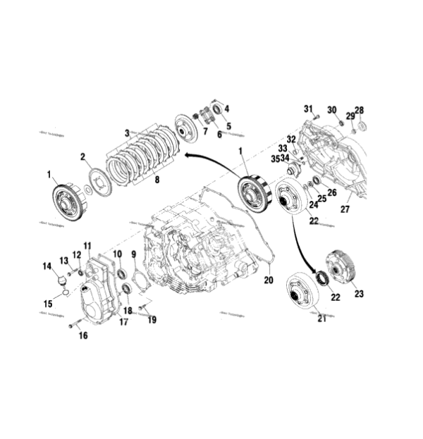

Hey guys, I'm new to this so I hope someone is willing to help me out. I have a 2002 Polaris Xpedition 425 and it is shifting hard. I have taken the clutches out to replace the shift lever that snapped off on me. It is shifting very hard and it was even before I took things apart. I got it back running again, but I am wondering if there is a clutch adjustment screw on the bike that I adjust how hard it shifts? I have been looking around but have been unable to locate it. I'm afraid I will break the shaft again if I have to keep shifting it as hard as I do. Any help would be much appreciated. A pic of the location would be helpful if possible. Thank you in advance for your help.
Cant find any adjustment instructions, but if there is an adjustment I'd think it would be by undoing nut #29 and perhaps the bolt/shaft in it might be slotted.. I'd look there and if the shaft #29 is on is slotted I'd have a play around if it was me.
