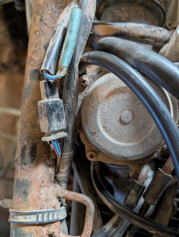

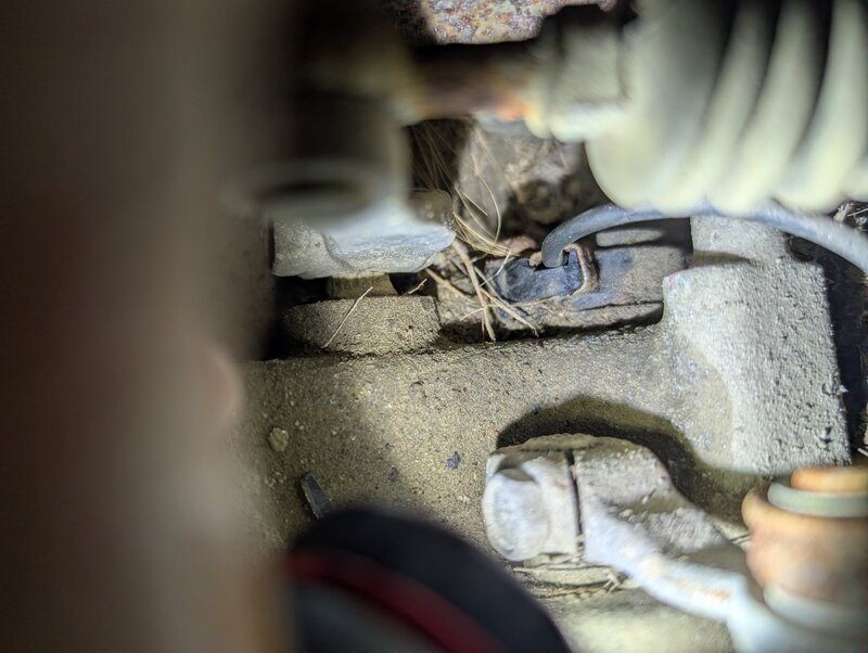

So this first image there is a connector with 2 wires coming from forward (the male part of connector) - one blue and one blue w/ red stripe. The blue continues down to a post near where the gear shifter enters the housing. (Second image). I was wondering about that.. I opened up the connector and the 2 wires (coming from forward) show continuity when I put my probes on 'em. Thought that was weird, but maybe supposed to be like that? I turned on the key and tested for voltage but didn't find any.
I'm just unaware of how to test for anything. Would be interesting to put 12 volts to the starter, but not sure about doing that or how. The wires going in are kind of hard to get to. I suppose I could take out the starter.. but wanted to ask if there is something easier to check first.
