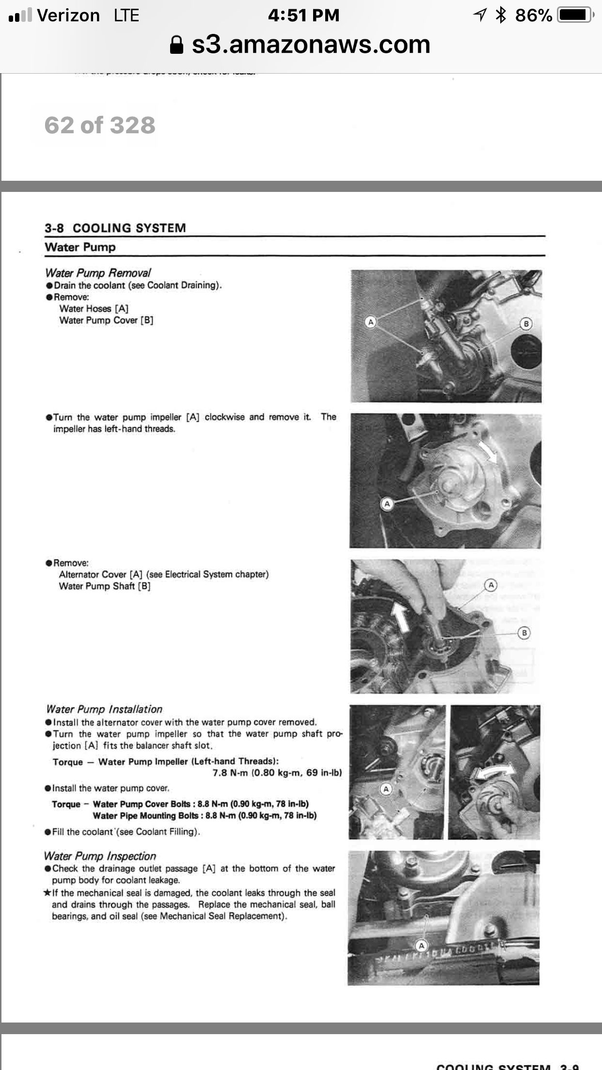

Hey jerr welcome to QC. There really is no trick to it.  The cover comes off and the impeller is attached to a shaft that is a separate part. Maybe it’s a little stuck. Pull on it it should come out. Either way go to the downloads section of this site you will find the manual for that bike. The 400 Kawasaki bayou 98 model is the same engine. That’s the bike I have and I have changed it.  So that manual will work as well.
