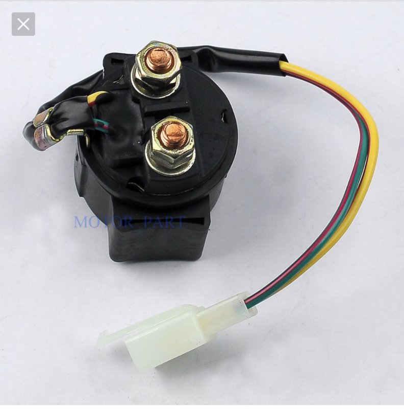

Welcome to Quadcrazy, sounds like one of two things.   Starter relay or the starter.
If you can, locate the starter relay.  I attached a pic of what it should look like.
It should be near the battery. The red wire + positive is coming off the battery and going to the relay. From the relay the wire goes to the starter. The relay has two big nuts on top holding the wires on it.  You can take a piece of wire and jump the two wires.  Make sure it’s a good size piece of wire and only do it for a few seconds.
See if the starter cranks. If so then the relay is most likely bad.
If not then you can take a tester and put one lead (red) on the wire at the starter. Take the second lead (black) and put it on the negative terminal (black) on the battery. Hit the start button. If you see 12v at the tester that means you have voltage at the starter and need a new starter.
