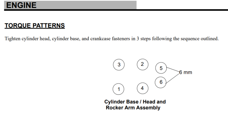

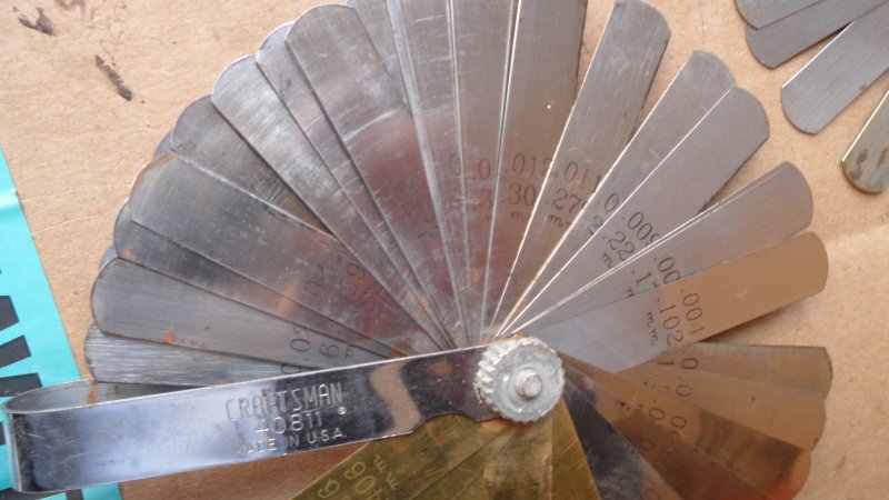

I never use these strange torque specs i posted above//i will post a more usable torque specs list down below for if you took things apart to work on adjusting the valve clearance with that thin metal feeler tool
