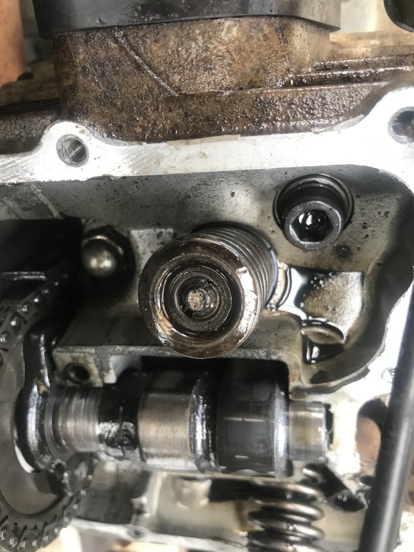

pulled the valve cover off and the cam and head are chewed up. If this was from low - no oil then anything is possible.
Just for fun the socket in the starter gear to turn over the engine broke.
Just for fun the starter reduction gear that turns the motor over for timing check - the one that the allen socket is on - goes into the main case so I would have to split the cases to change the shaft to time the engine. Anyone want to buy a parts machine?

You can put it in gear and bump it forwards a couple times to turn the engine over to time it. Take the spark plug out so it'll bump easier. Not ideal but it works.
Or bump the kick start.
