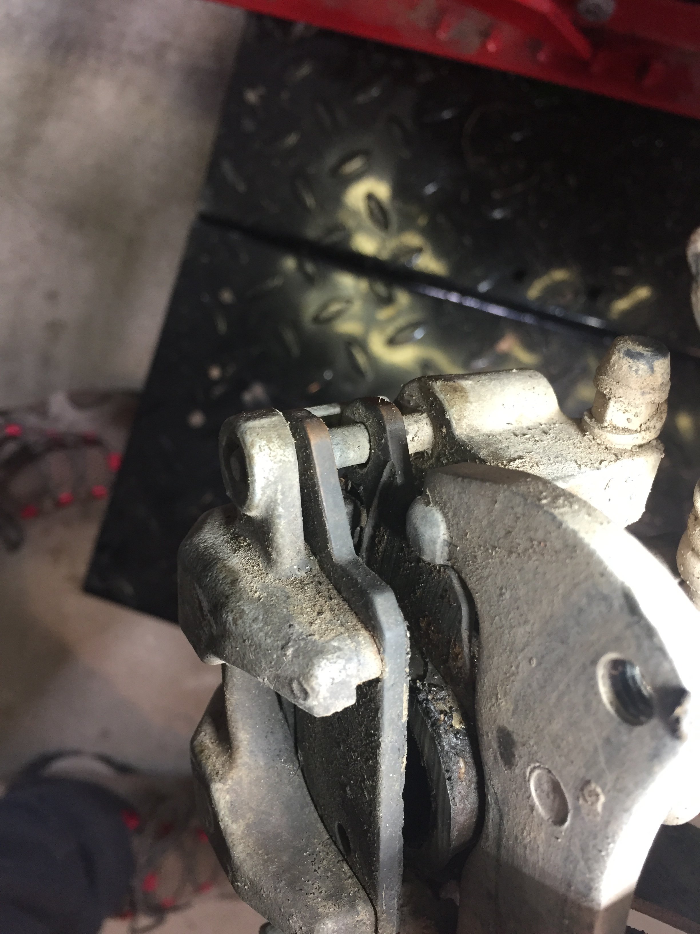

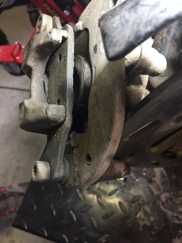

This quad is 15 years old and used daily by a rancher. Fortunately he brought it to me for repair before it was totally destroyed, haha!
Because of a loose ball joint I have to replace the steering knuckle/spindle and the upper A-arm as well as the brake caliper, pads, etc.

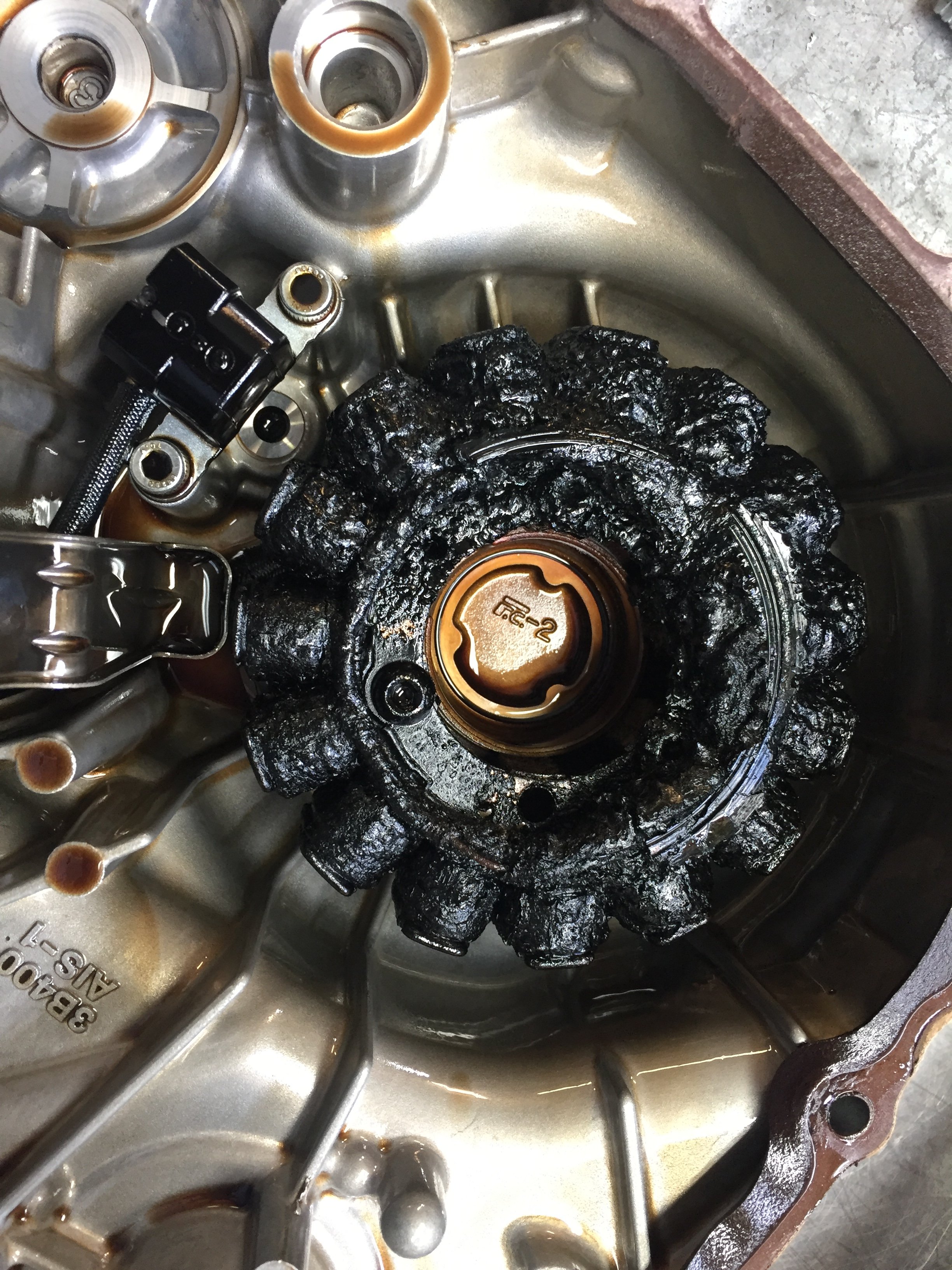

Surprising enough, the motor ran fine - even with over 10,000km & thousands of hours on it. Most Japanese quads are pretty durable.
If not swamped, most all of the Japanese motors before the early 2000's will almost run indefinitely.  I've seen old Hondas that the rings are so gone they look like a fog machine but still run like a top.  Been playing with a BRP lately and while the power is a blast, it's just not a Japanese machine.  It likes to kill it's own parts regularly.
