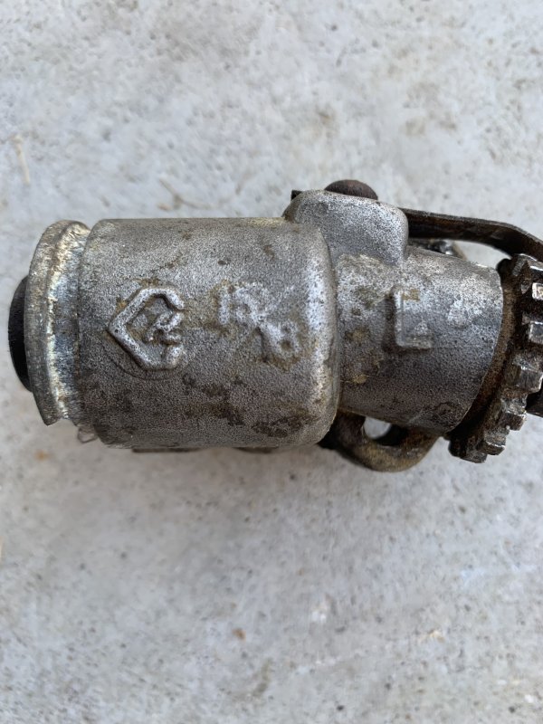

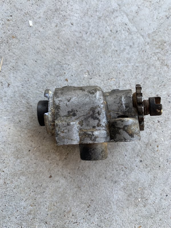

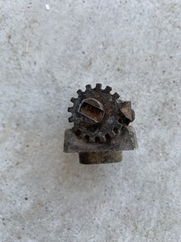

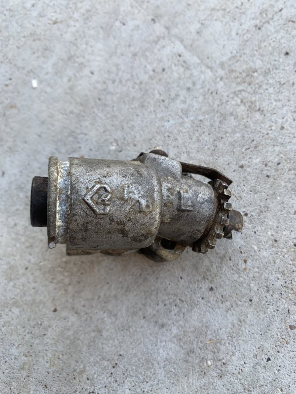

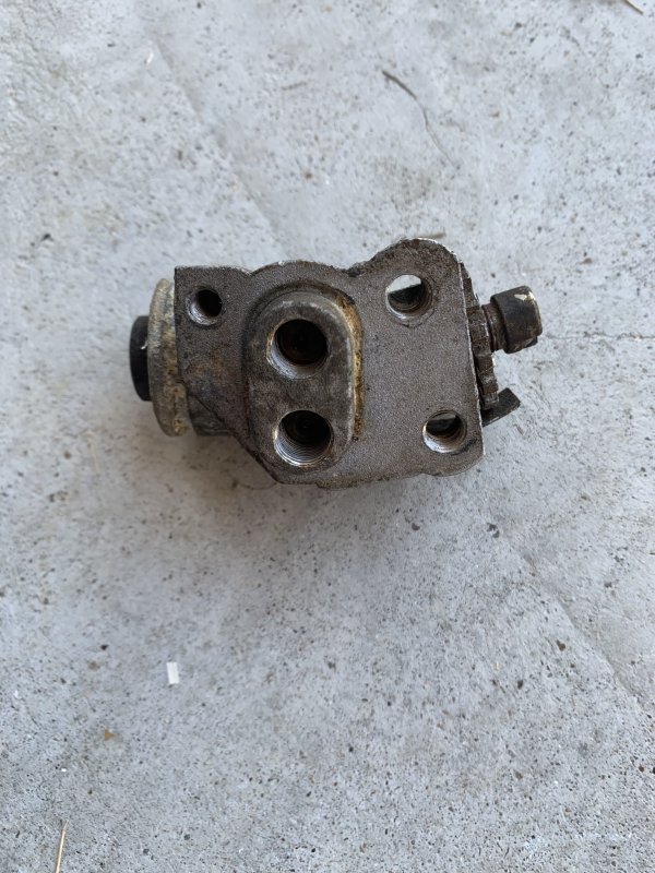

I know little about this machine but the brakes don’t work as the drum brake cylinders have seized up. Looking for replacement wheel cylinders. If anyone can help me locate a seller or other parts, I would be forever greatful. I’ve attached photos…
  • 5 weeks later...
They look mighty common.. I bet they are made by some other company. I'd take them to a brake specialist and see if they can match them up, or ask an automotive parts supply place.
If you have to get them apart, attach a grease gun and pump the pistons out. Make sure you wash them really well after though.
