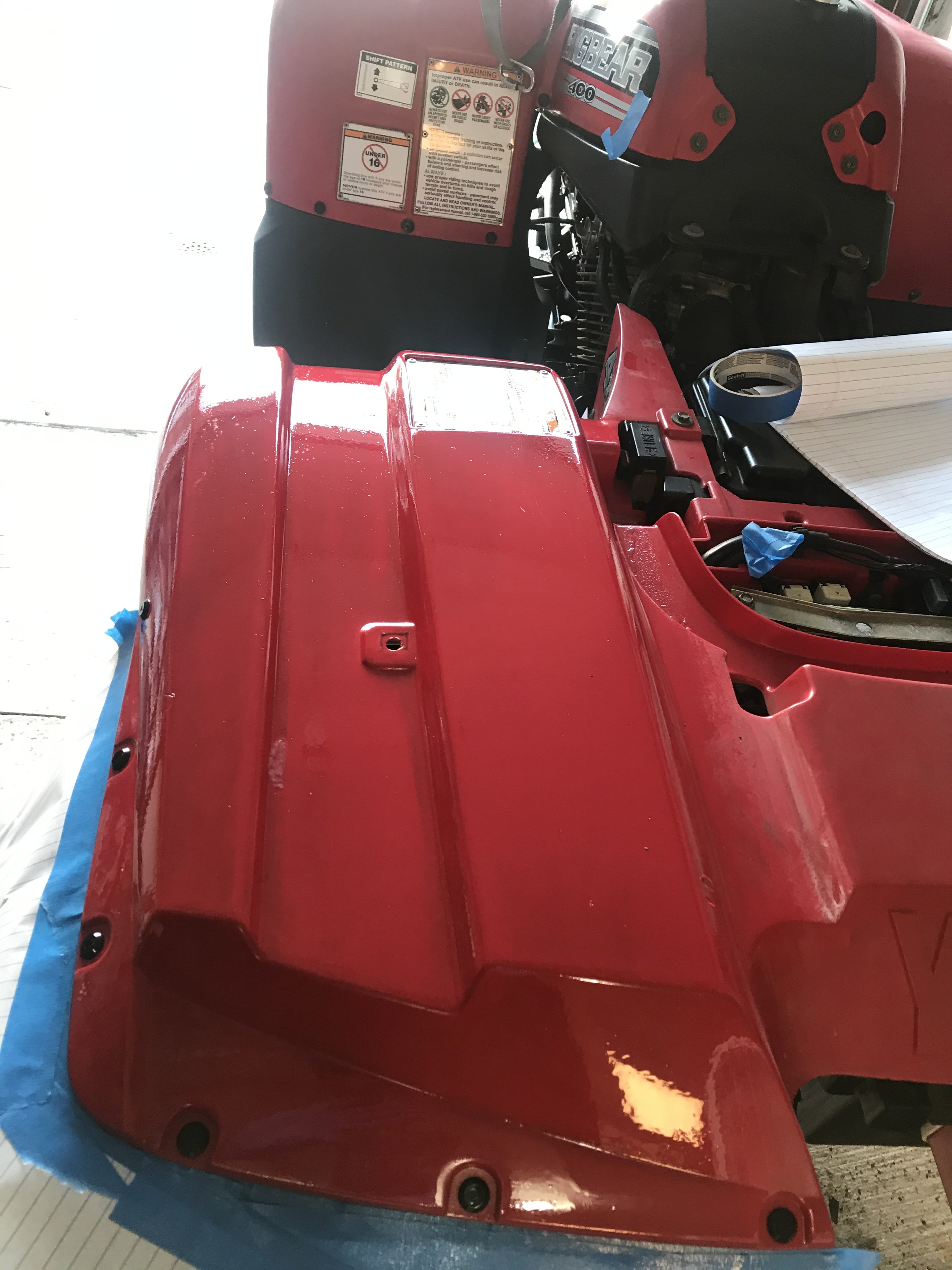

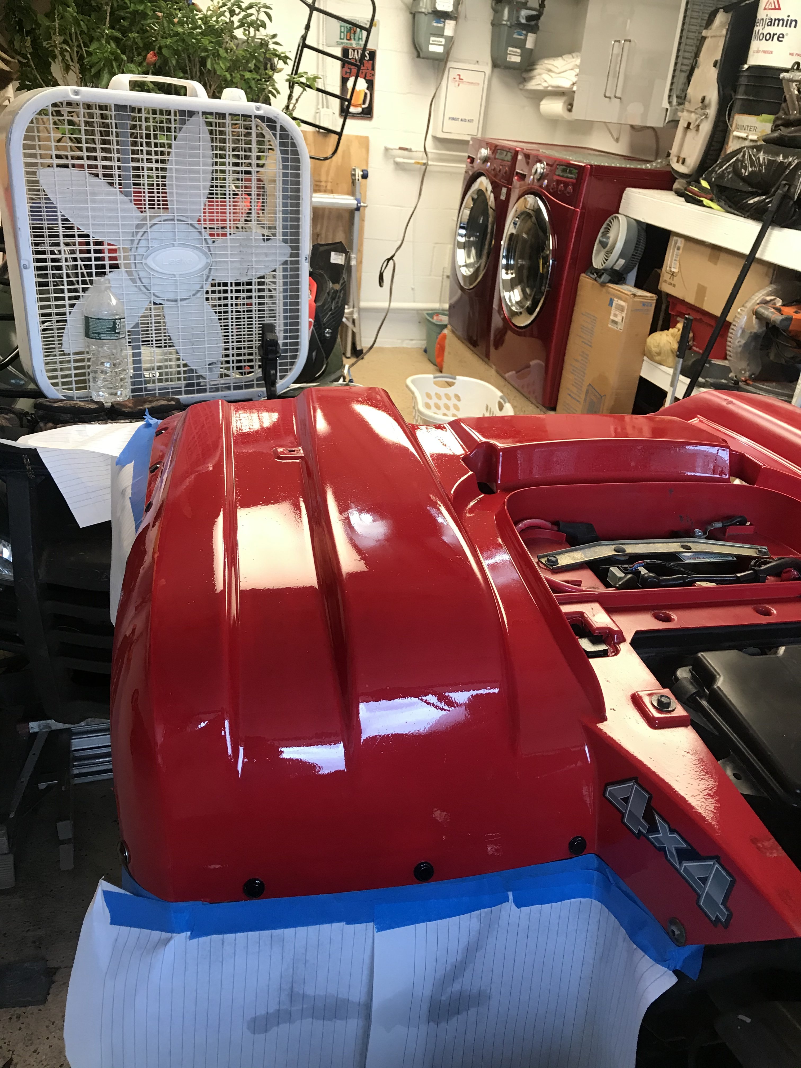

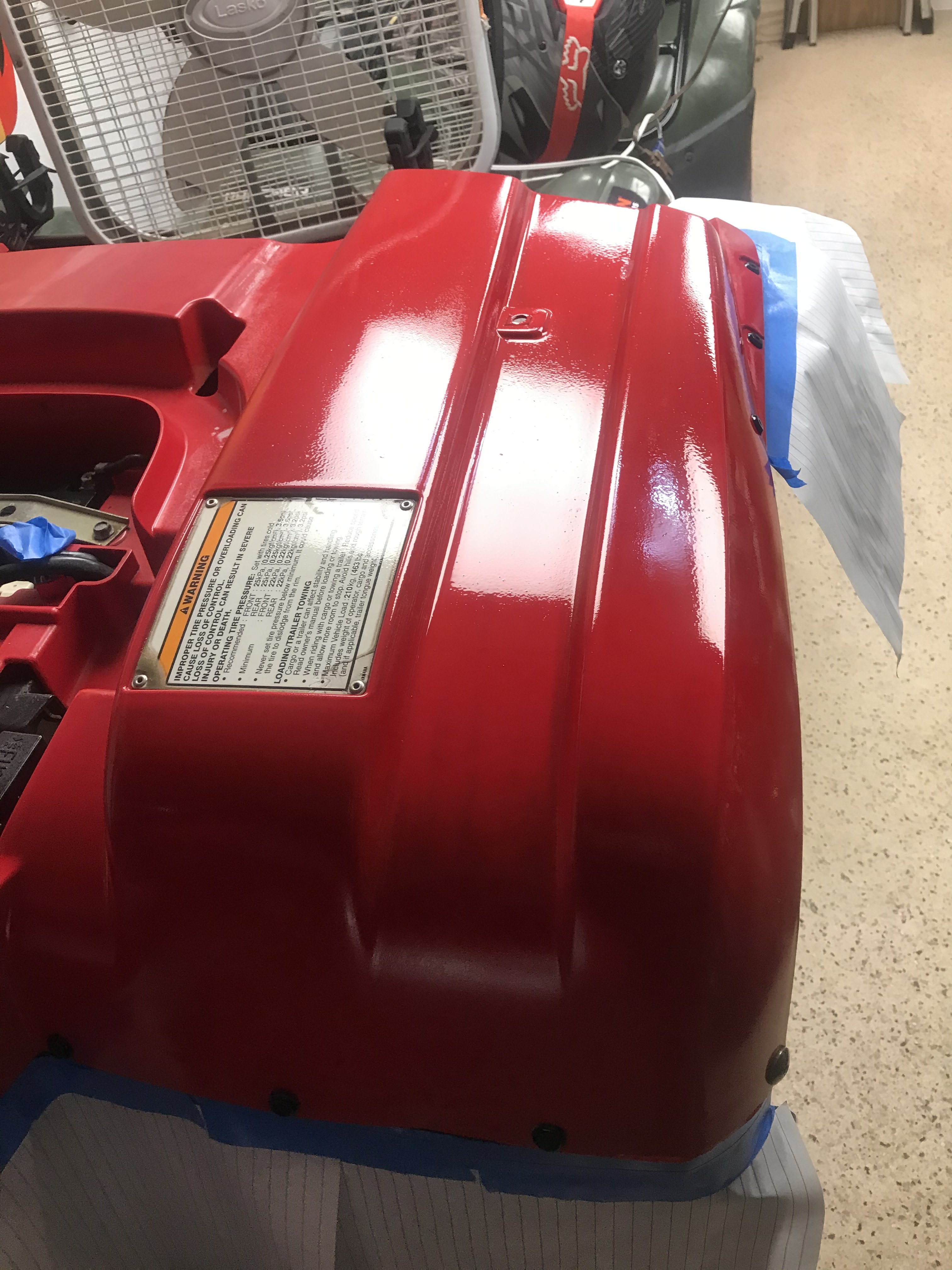

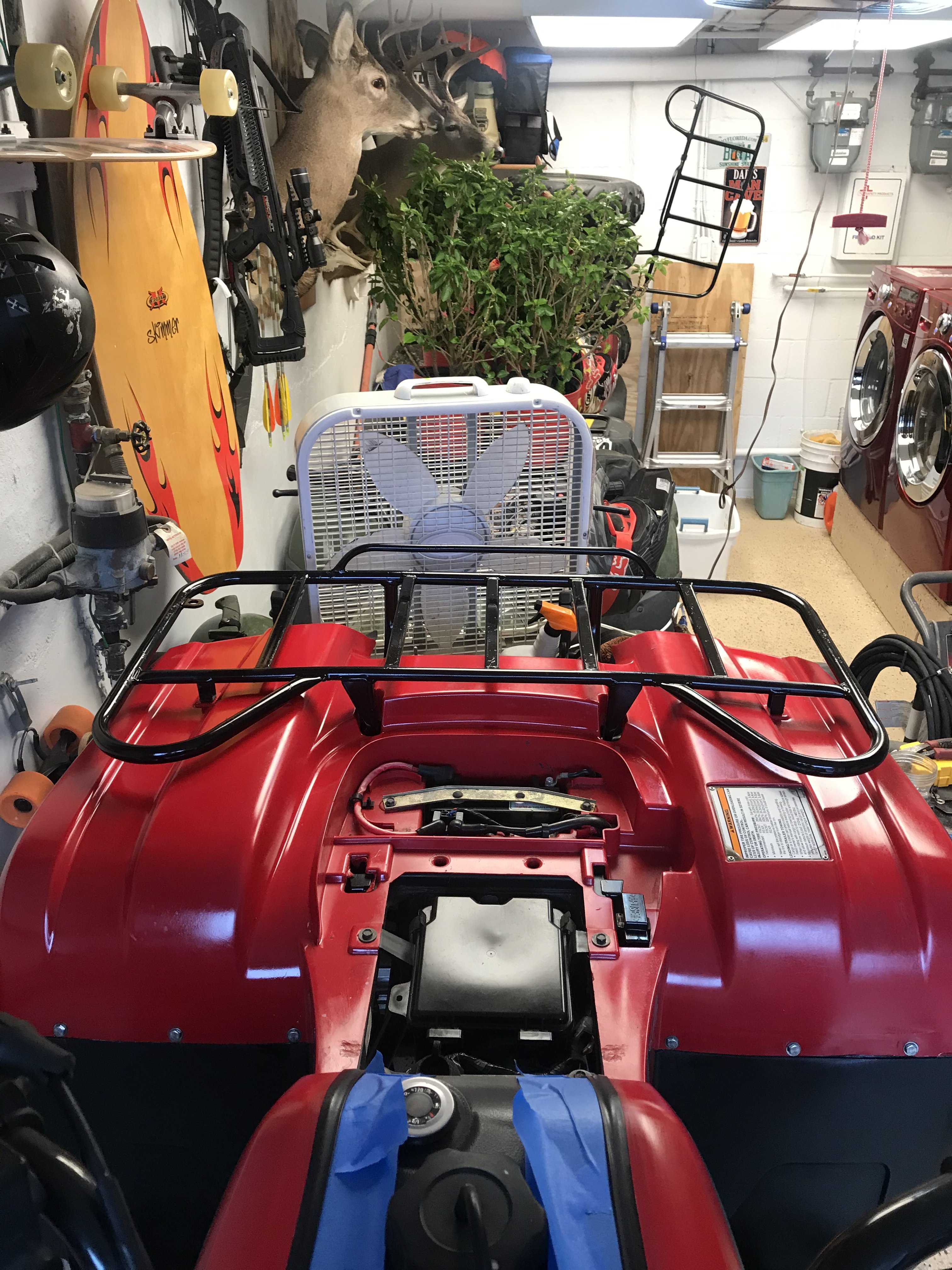

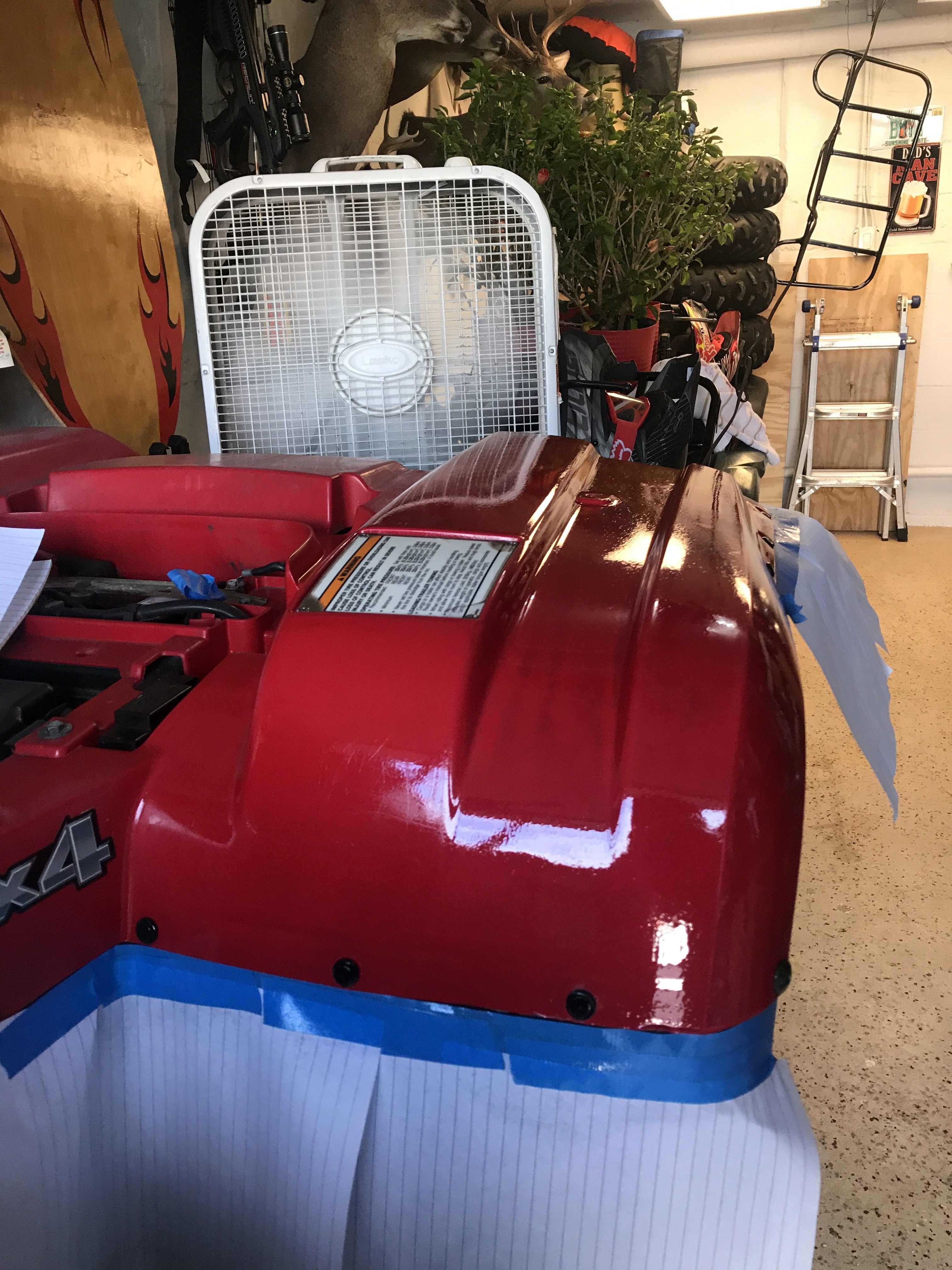

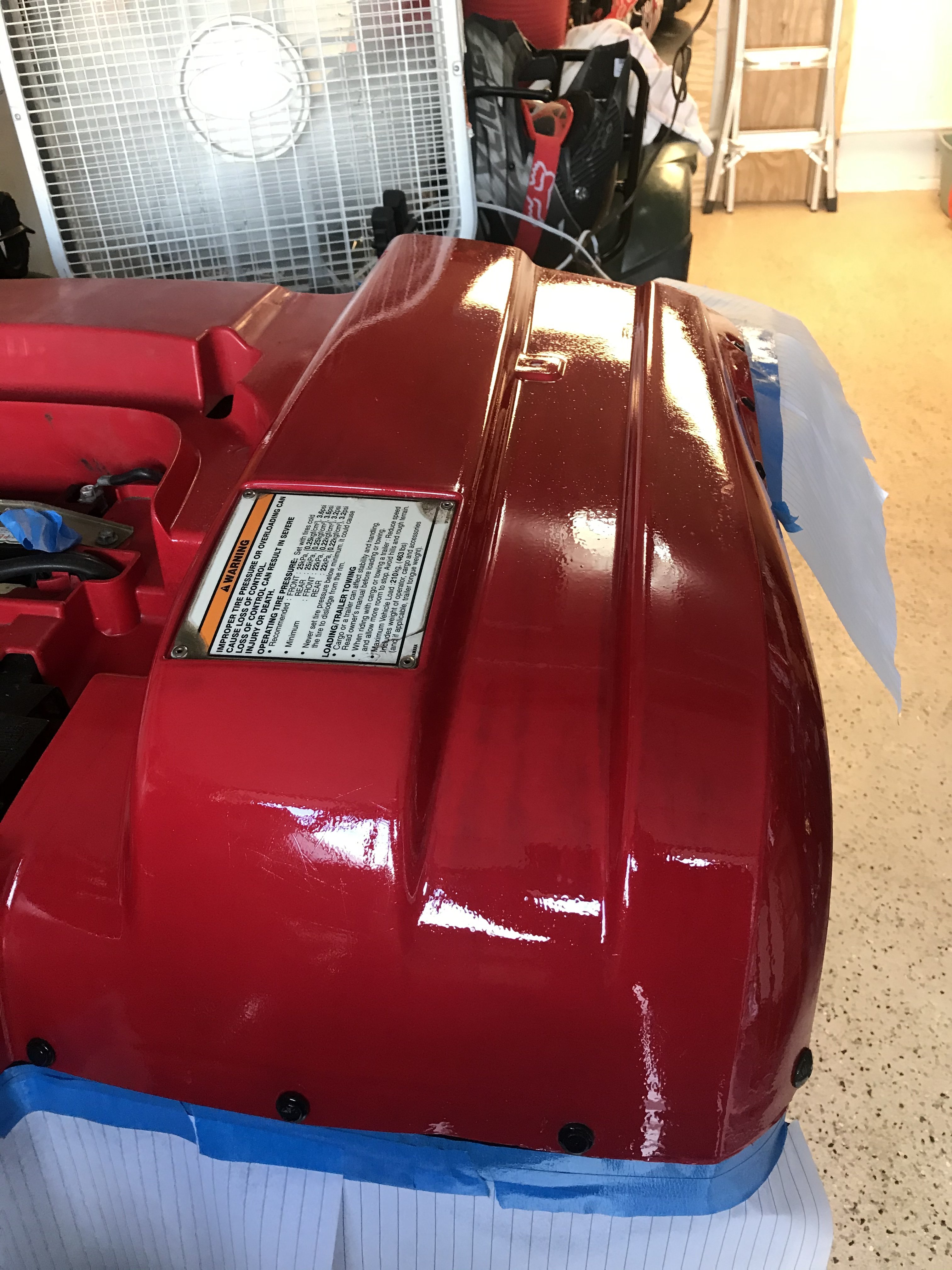

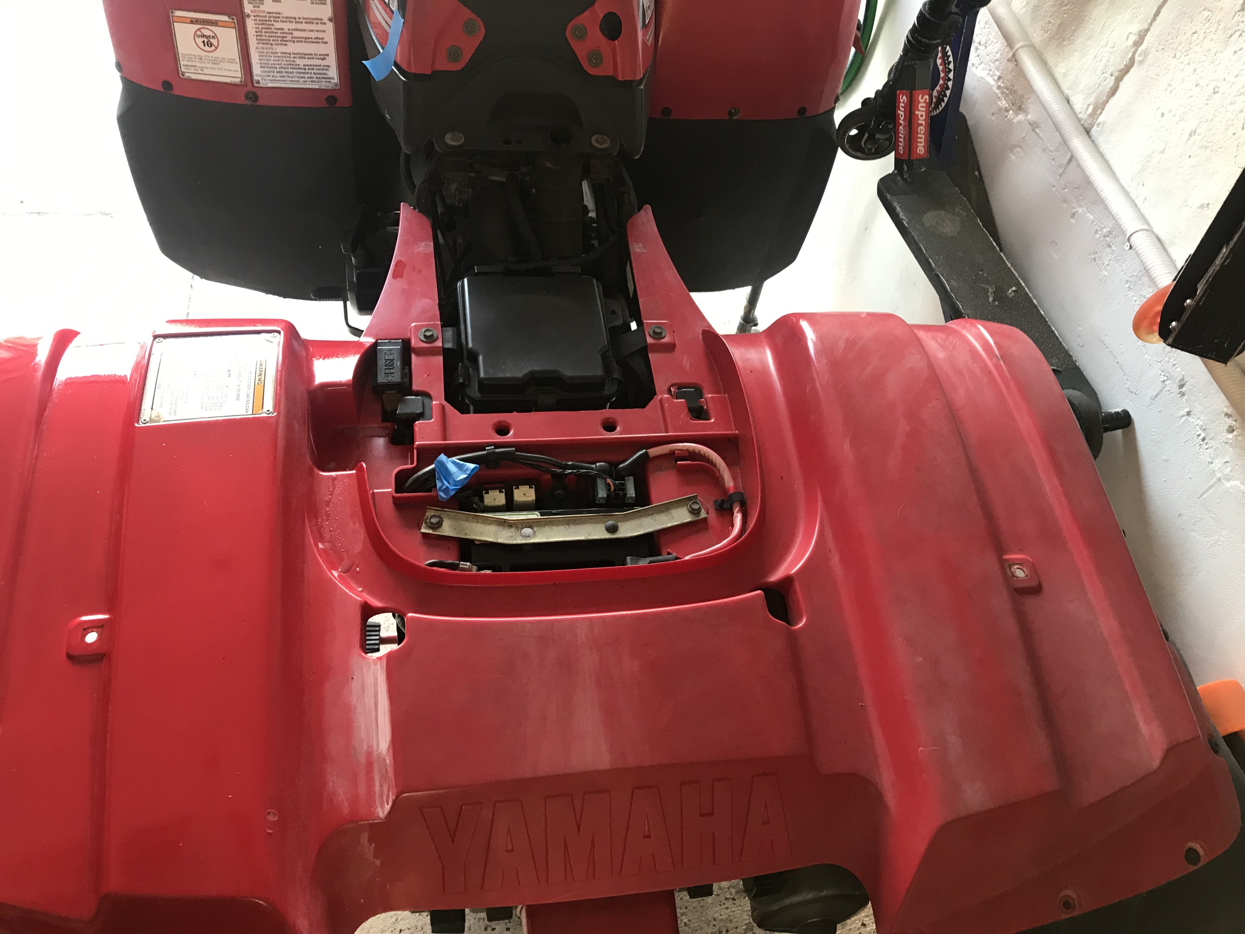

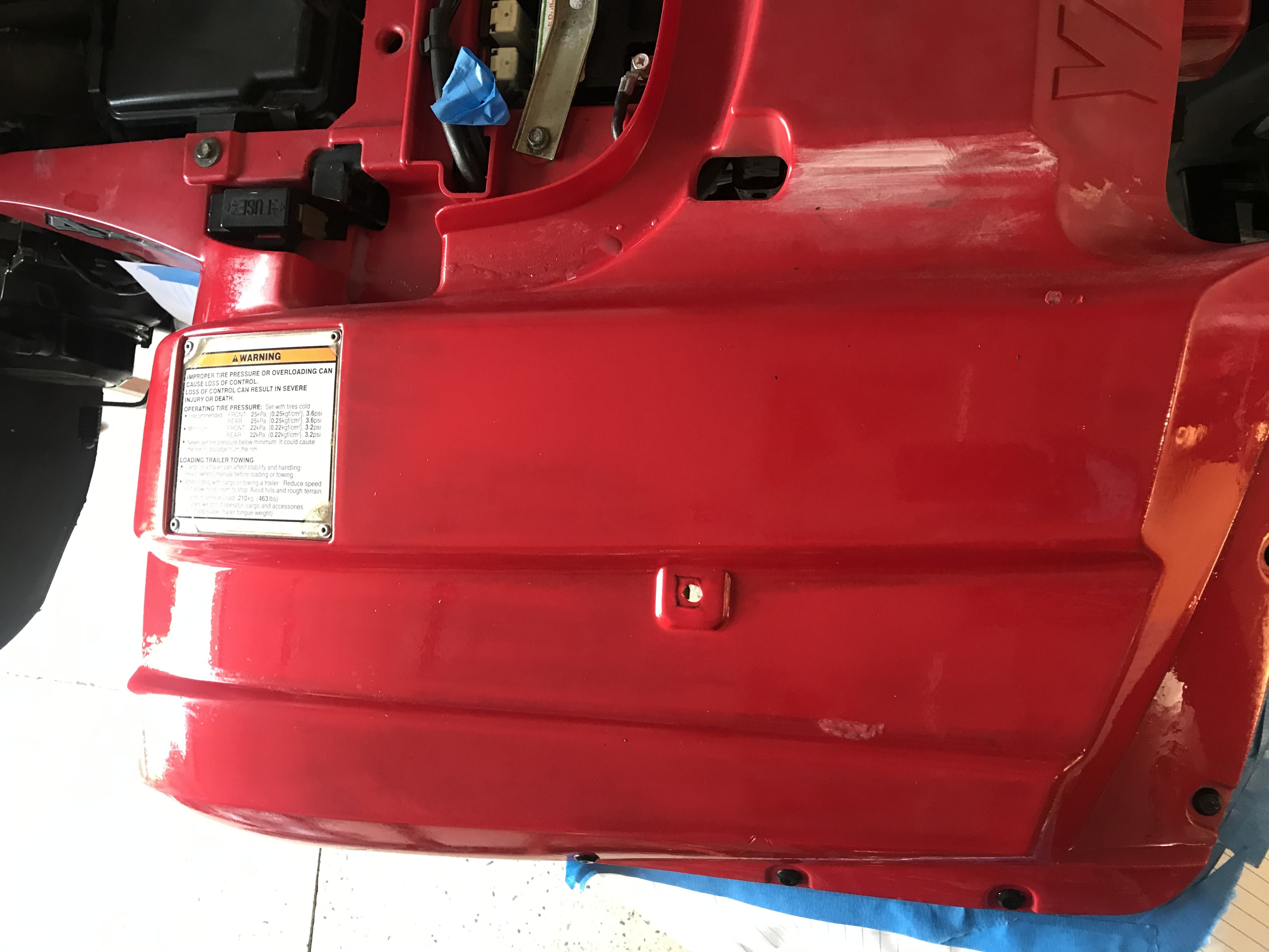

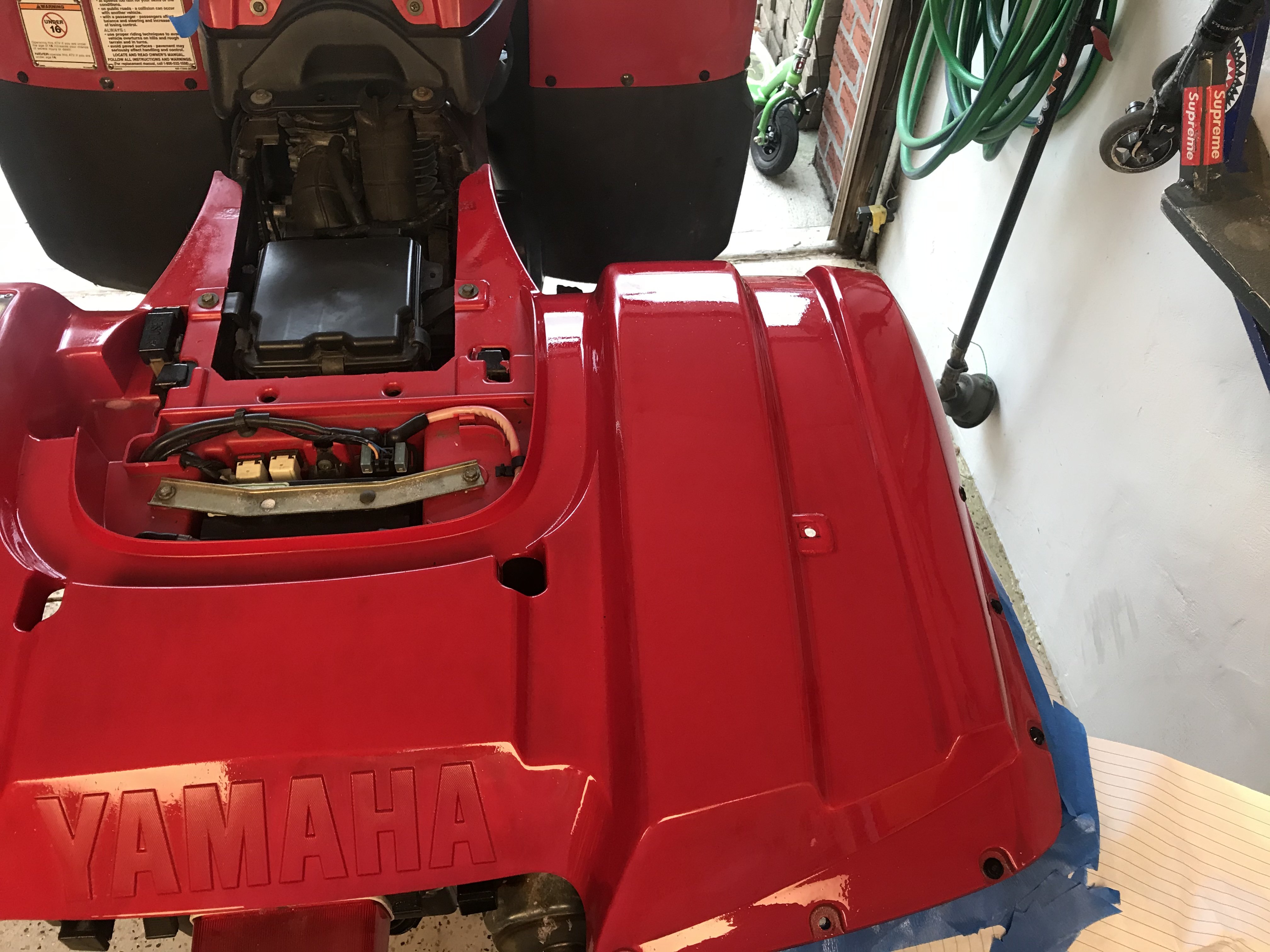

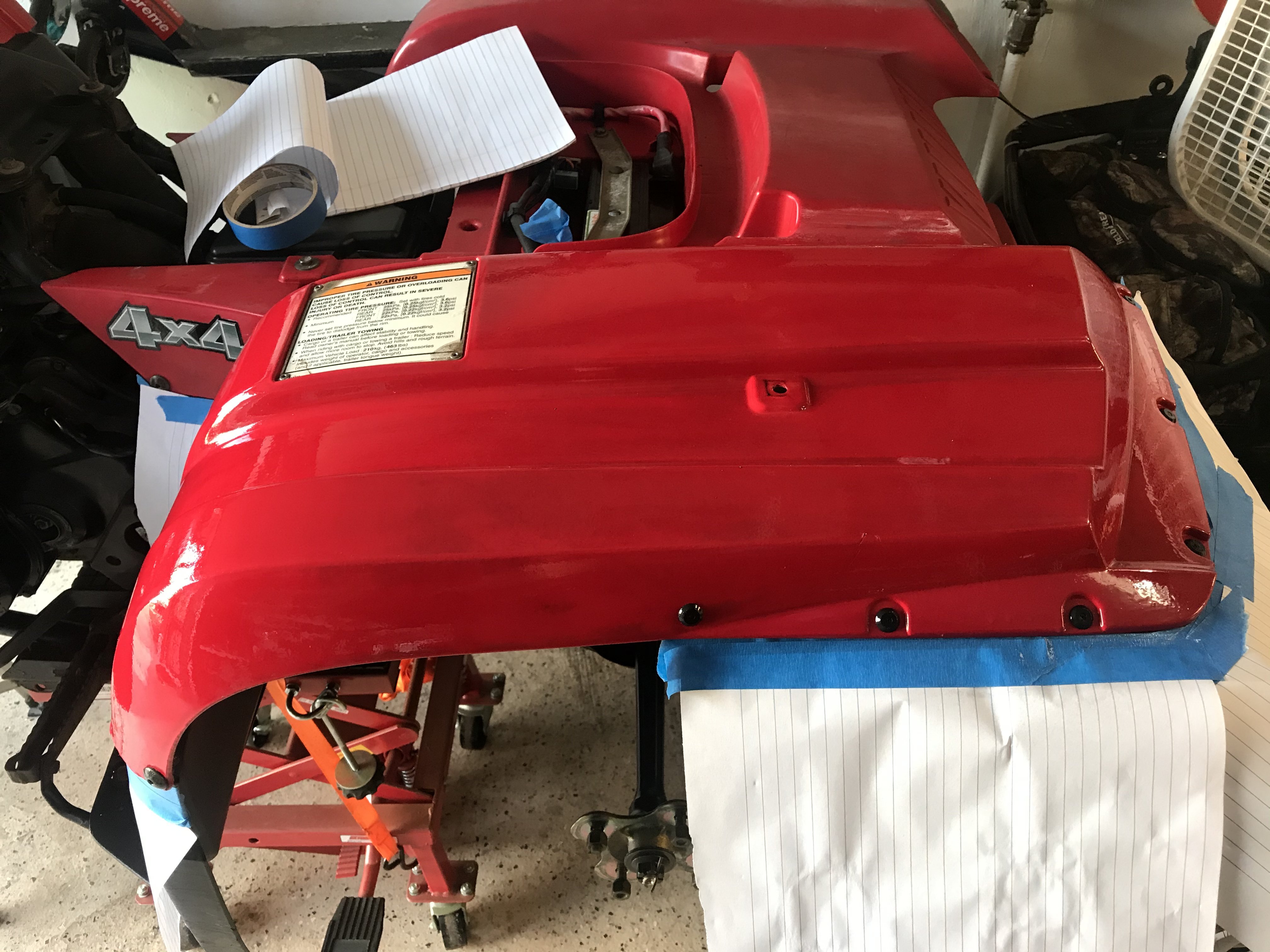

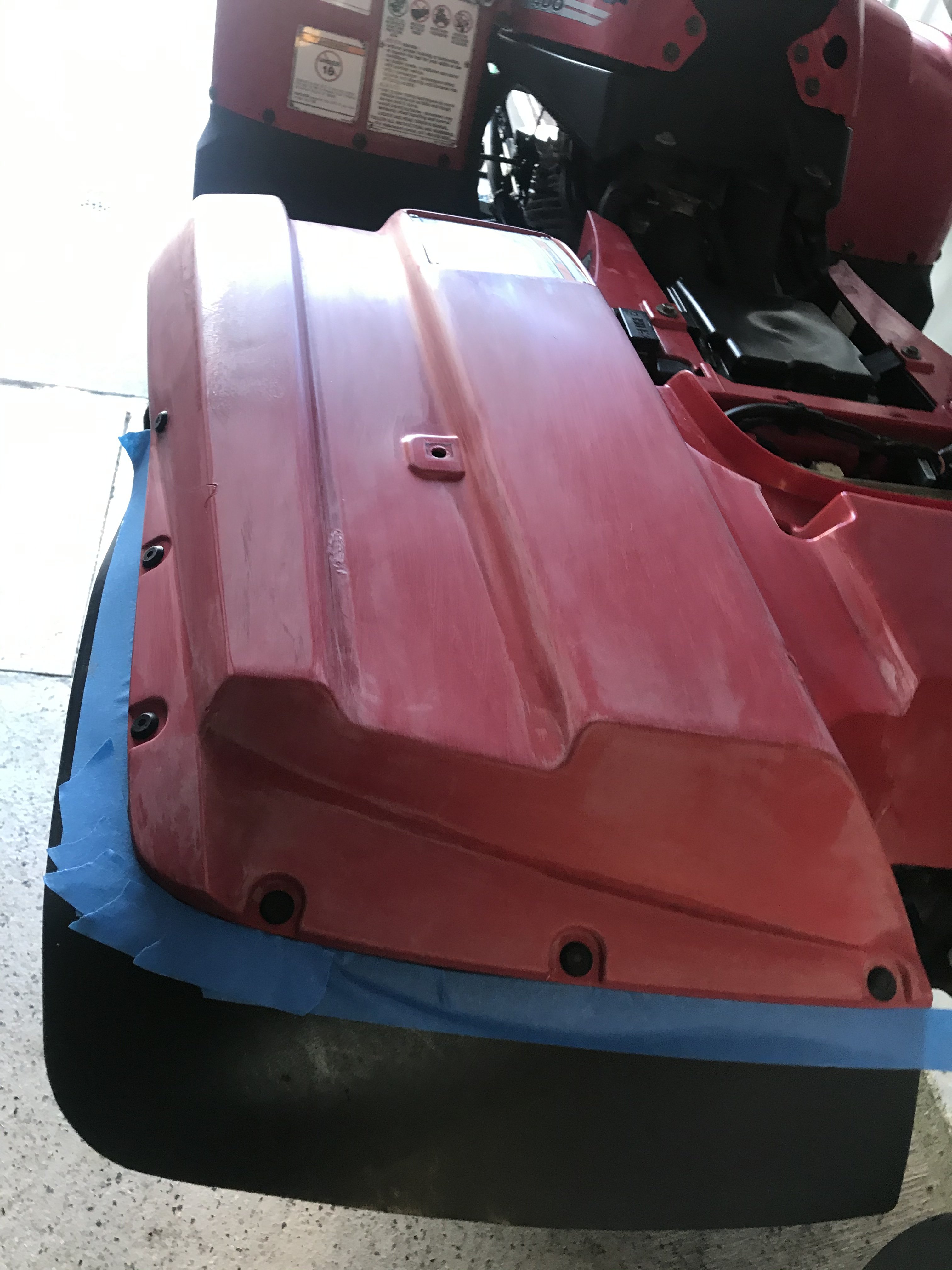

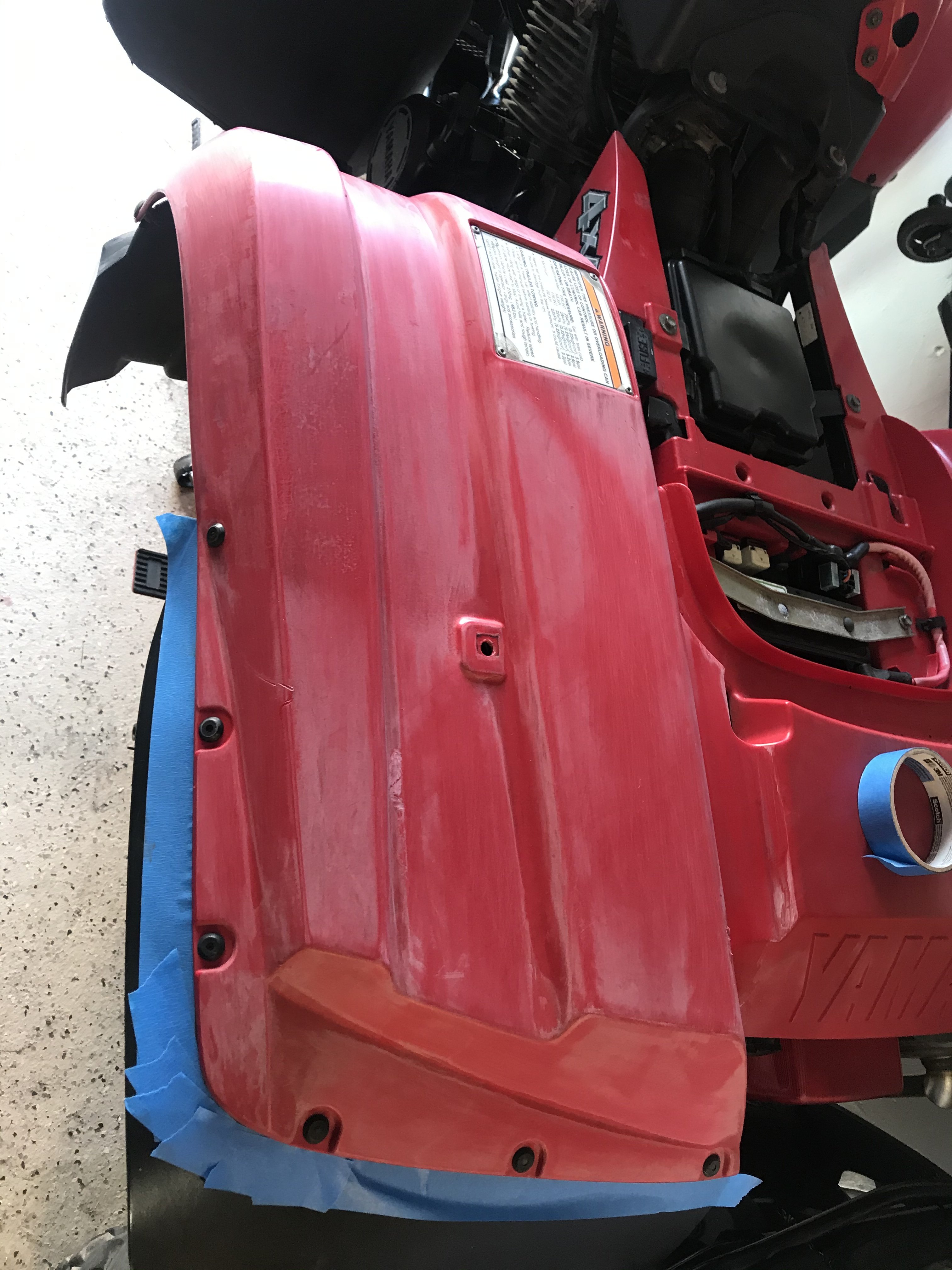

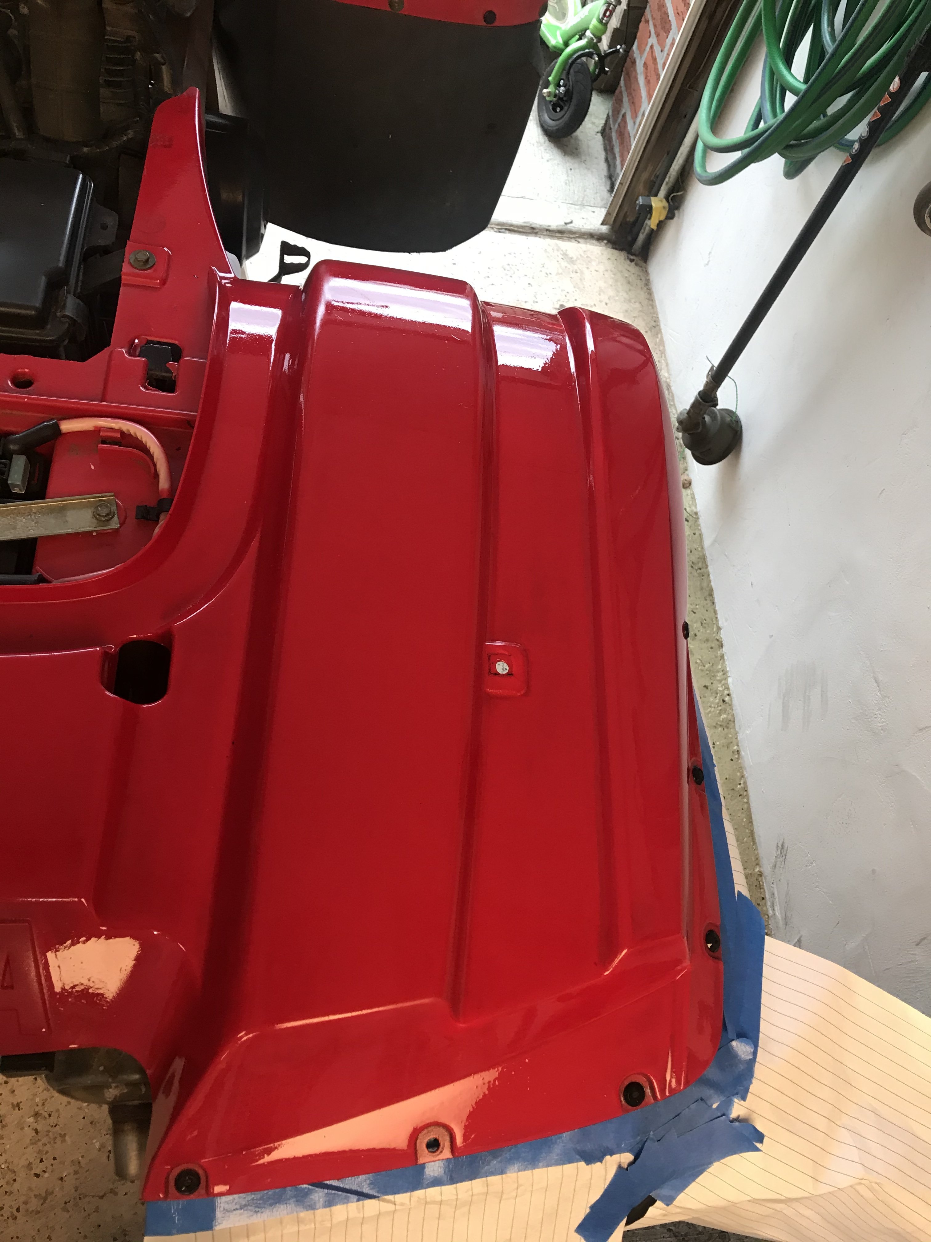

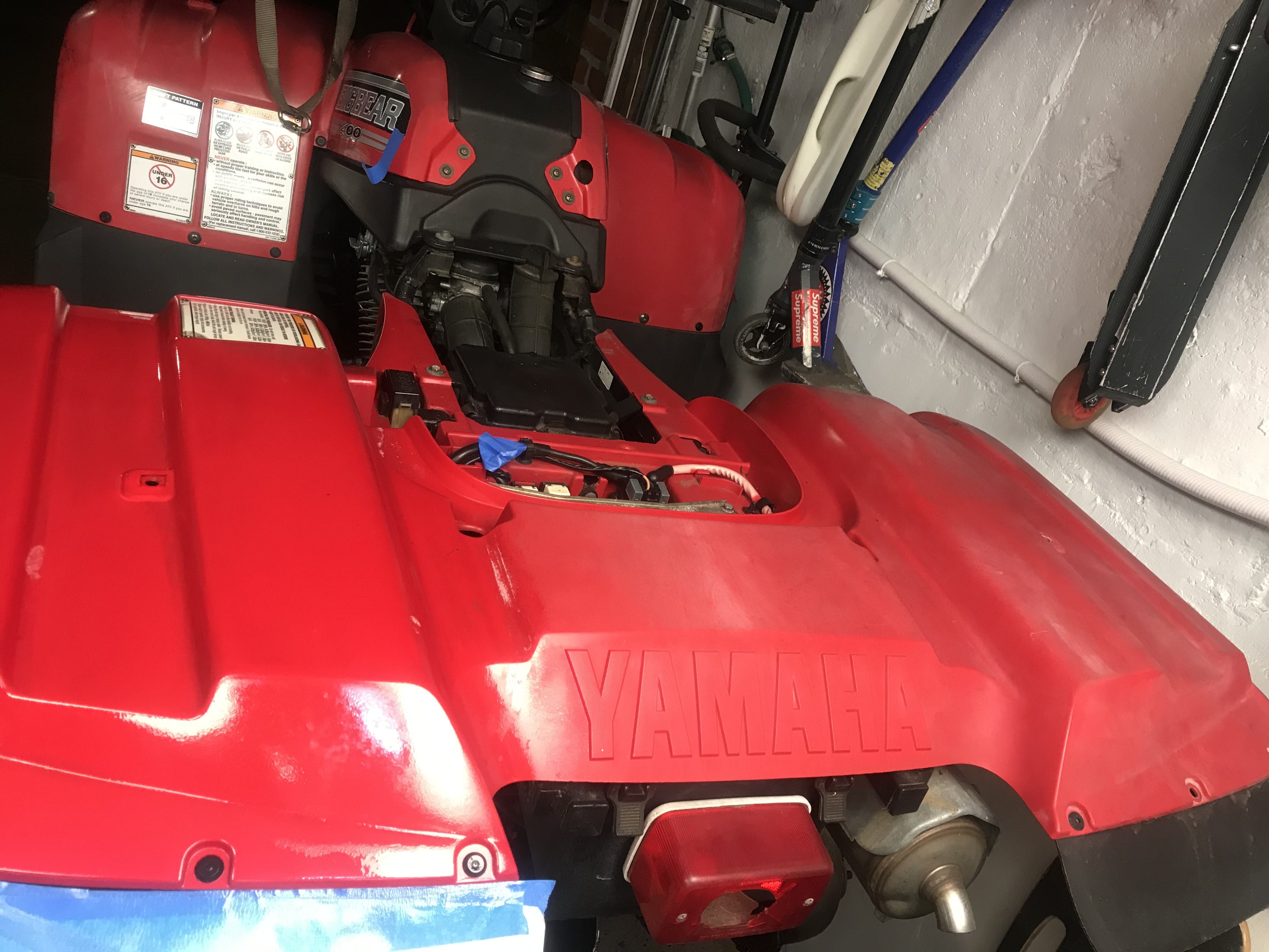

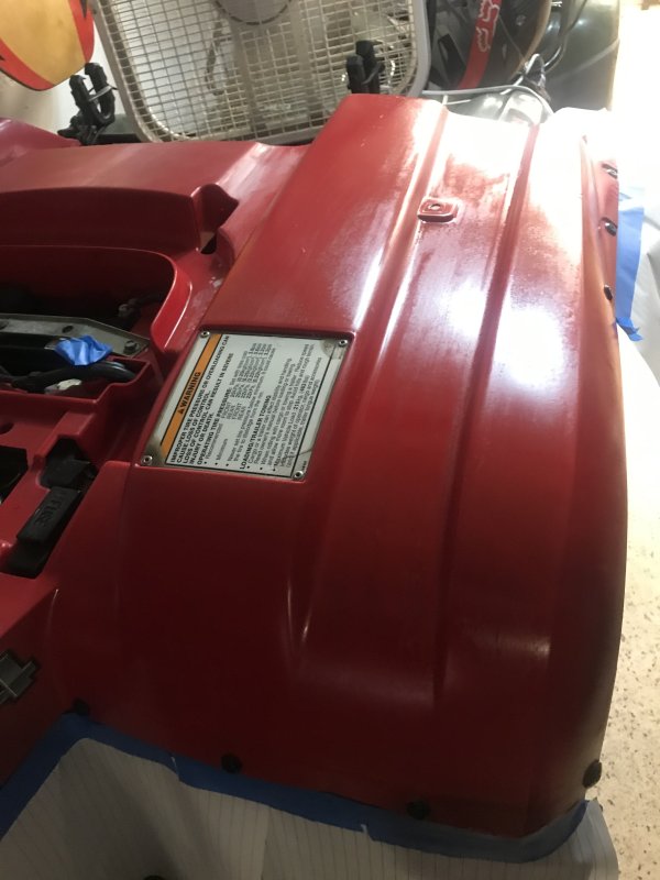

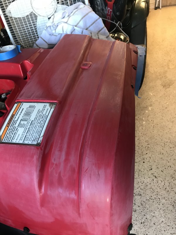

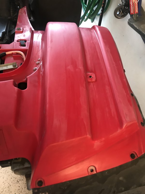

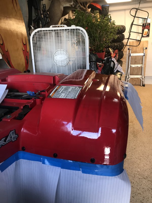

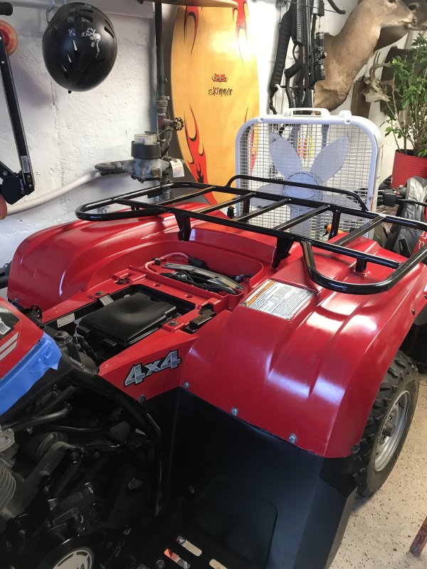

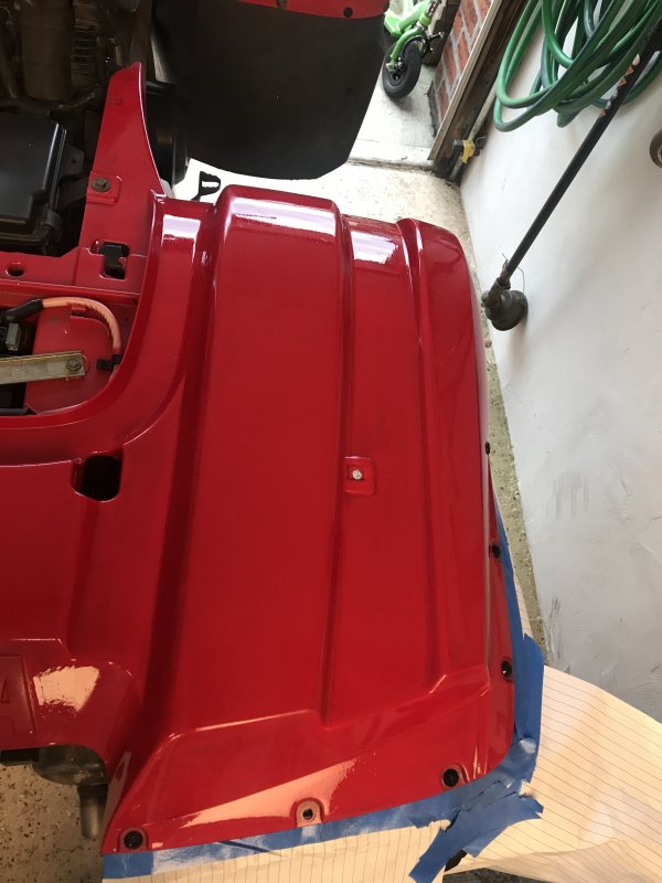

So i decided to give the water sand thing one more try with 1200 grit and it took all the surface dirt and faded white residue away.  Thin i  hit them with a flexible oil based clear coat spray can that i had my local place order for me after asking her to look for something in that ballpark.
I tried a small spot first and then tried to remove it with gas and a few other things including a light psi pressure wash.  The results were good enough to try half the rear plastic.  I think it worked out great. Im going to do all of them and see how they hold up since the atv is going to someone i know and can keep me up to date.
The pics are not in any order except for the very last one. Thats finished product of one side of the rear plastic and you can clearly see the difference. In person it looks and feels great and seems durable.
So i got what i wanted to get done and a little more.  The clear coat works great and it's definitely flexible. However  I'm hell bent on and close to having a process to restore plastics like new without any paint or clear coat or chemicals.  Gotta wrap this one up and get it gone asap but I'm going to  get me some old plastics (Where not sure)  and going to have at it.  I plan on recording the process and share.
