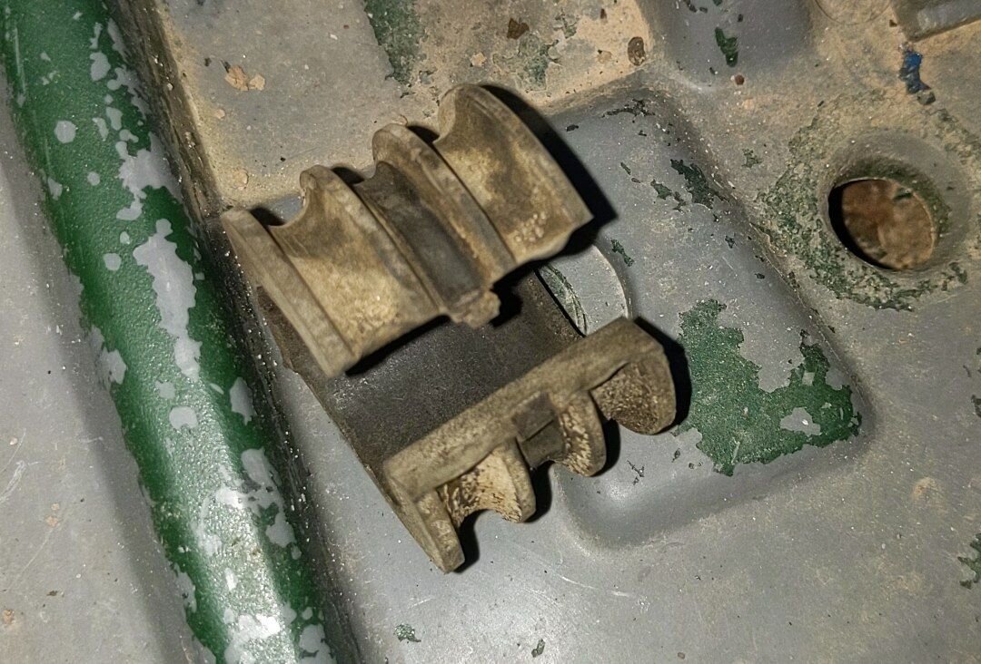

Funny rubber part came with the box and hoses, not sure where it goes. And, I guess the airfilter gets sandwiched in the box? Is that how it seals? Against the inside face of the box?
There was also a single missing clamp, out of the 4, as stated correctly in the Seller's item. Where do I get more of these clamps?

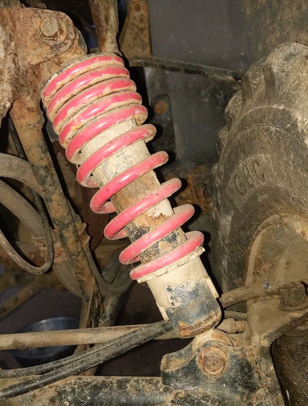

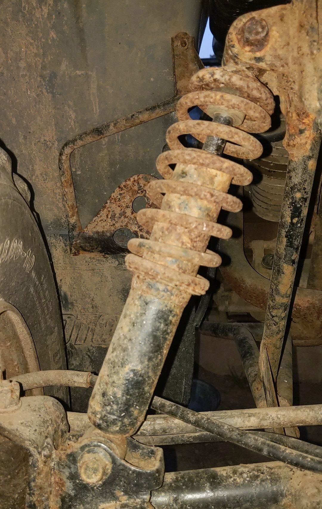

I havent bought any shocks lately, but they are expensive, many aftermarket ones on Amazon, you can just measure yours or find ones that  fit a 90 model.

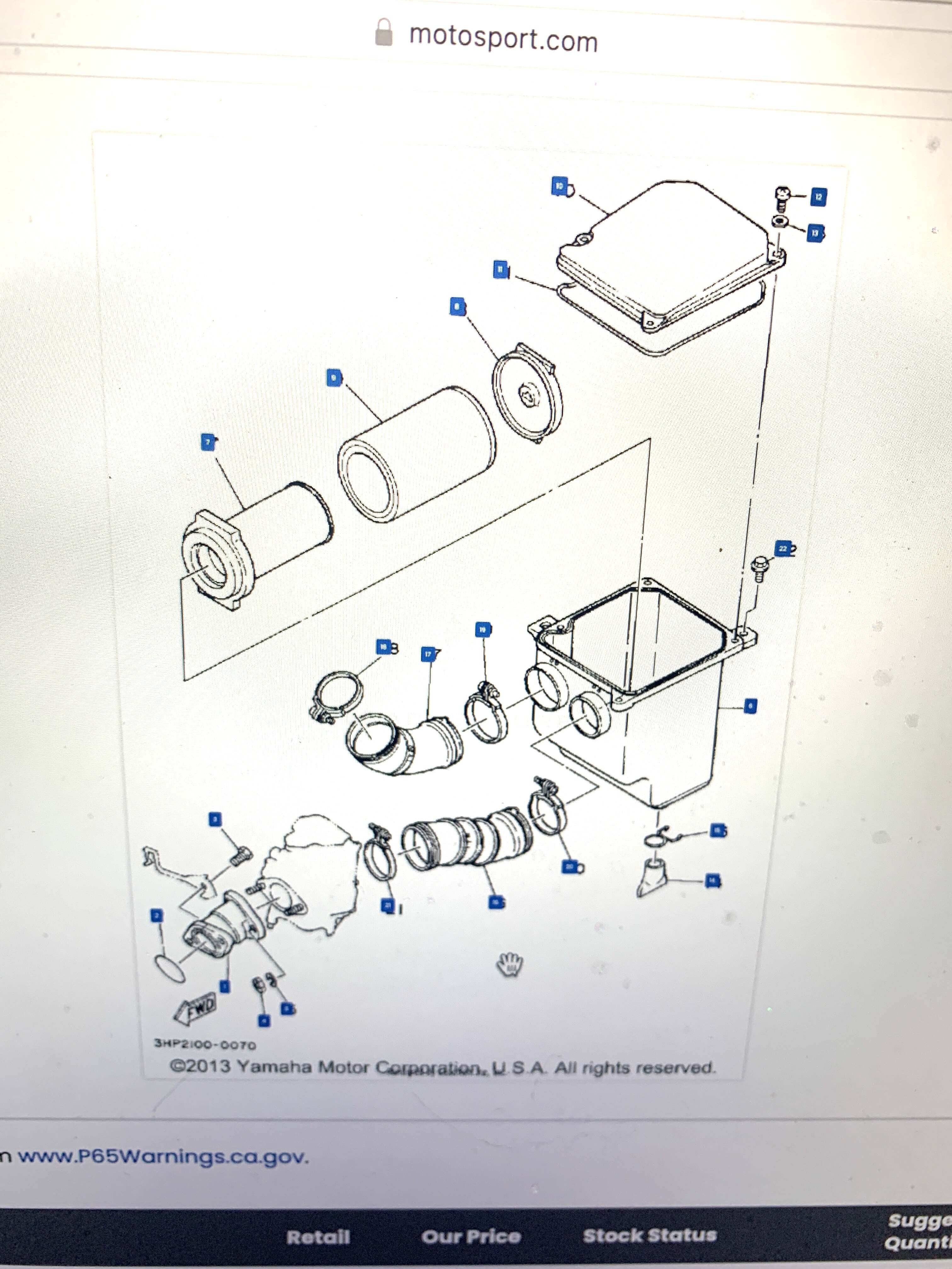

This diagram is from a 92 model like the one you purchased you can look it up on any OEM parts dealer Like Motosports, Rocky Mountain, or Parzilla
Here is a clearer diagram of the filterbox and hoses. The part with the rubber hoses and clamps and box are the same as the '90.
18, 20, and 21 are all 90450-56001-00.  Whereas 19, the inlet to the airbox, is 90450-58002-00, and that plastic opening, as depicted in the diagram, is slightly bigger than the carb/airfilter side. Both ends of the carb-box hose, and the frame/steel pipe end of the intake rubber hose, use 56001.

The air Box has its own little seal that fits in the grove for a watertight seal.
Ok I don't think I have this. It looks like an O-Ring that goes all the way around, right? I may have it, might not. Didn't look really close when I went to go measure clamps and openings. Later: It's part 1VJ-14462-00-00, and it just a piece of rubber cord, like an O-Ring that isn't connected to itself. Instead of $15 with shipping, I can probably find that in the aftermarket.

Not really sure about the rubber part i could not find it on the air box diagram bit it appears to be a smaller hose adapter or clamp.
That is the rubber bumper that fits around the YFM350 frame, where the box has the inset (where the airbox narrows in the front to accommodate the frame). It's to support the airbox and prevent it from rubbing. A zip-tie goes around the center of the the bumper/sleeve, to secure it to the frame tube.
There's a lot of pairs for the Yamaha Banshee 350 YFZ350 1987-2006. I wonder if they would fit.

I meant part # 7 in the diagram, but you have it with the new filter from amazon, great i didnt know they came with that part, no i didnt mean you should buy that part thats why  isaid you could adapt it but dont have to with that filter, nice kit, i must have missed that when i was adapting one to my Big Bear, but it mounts differently from mine, good find!
 The shocks you found look nice i would measure the ones on there now to see if they are close to the same, may work they are adjustable to some degree.
