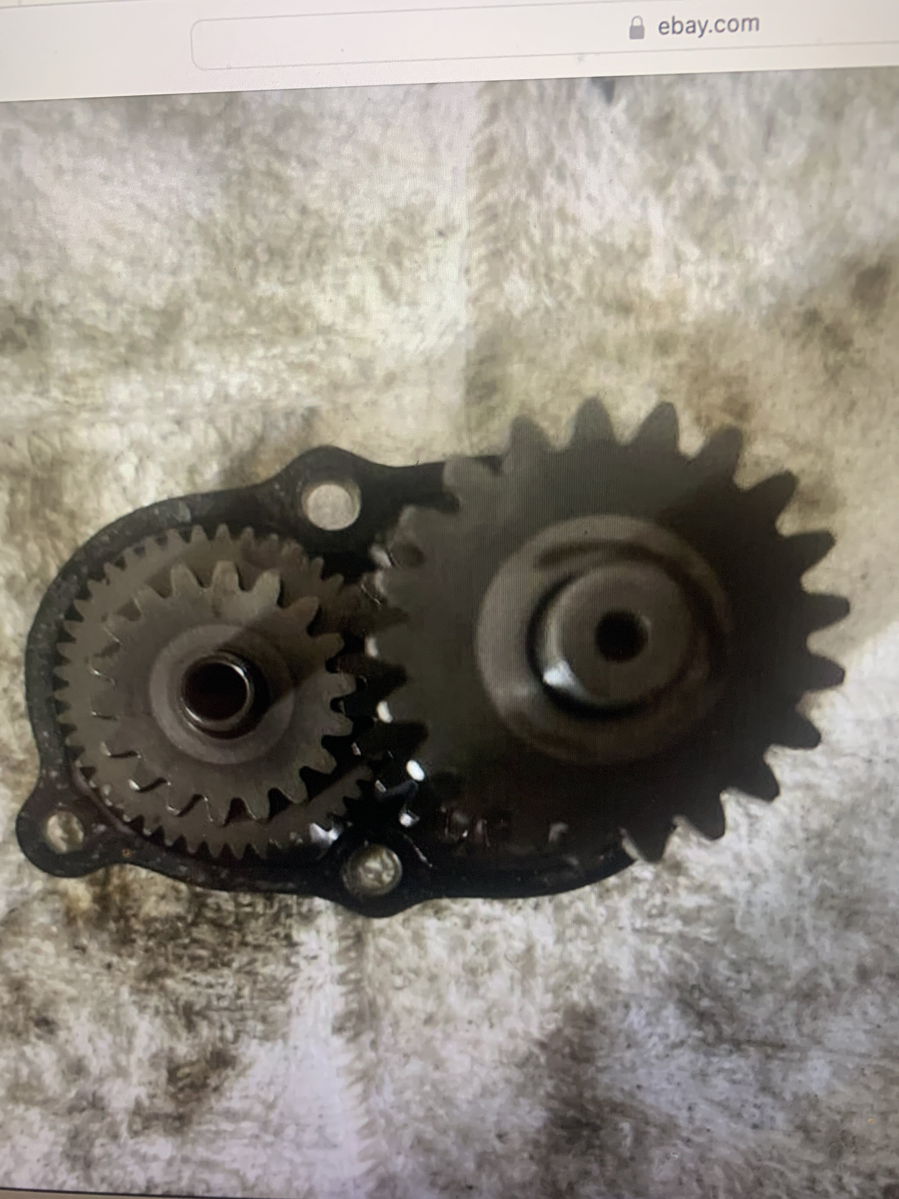

Ho yeah, they are quite a bit different. So the other gear in there must be different too or it would be chewed up.
You'll suss it. If it's not a market difference(thinking starter motors) then it must be some after market I reckon. Those chunky teeth don't really look like what a honda would have..  haha..  maybe. Or a honda mod.. There's probably a "old new stock" dealer somewhere with a set. We have one here called Anaconda.. They have a lot off old stuff.
I was asked one time why have all your problems have to be so complicated, well my answer, if it wasnt for bad luck i wouldnt have any at all.
This is a perfect example clearly a straight forward fix, instead i find gears that dont match anything i can find and completely does not match anything sold to fix the problem, but when i find that larger gear that is unavailable i should be good. Then i have to find why its shearing the gears and i suspect its the one way bearing on the clutch side not doing its job.

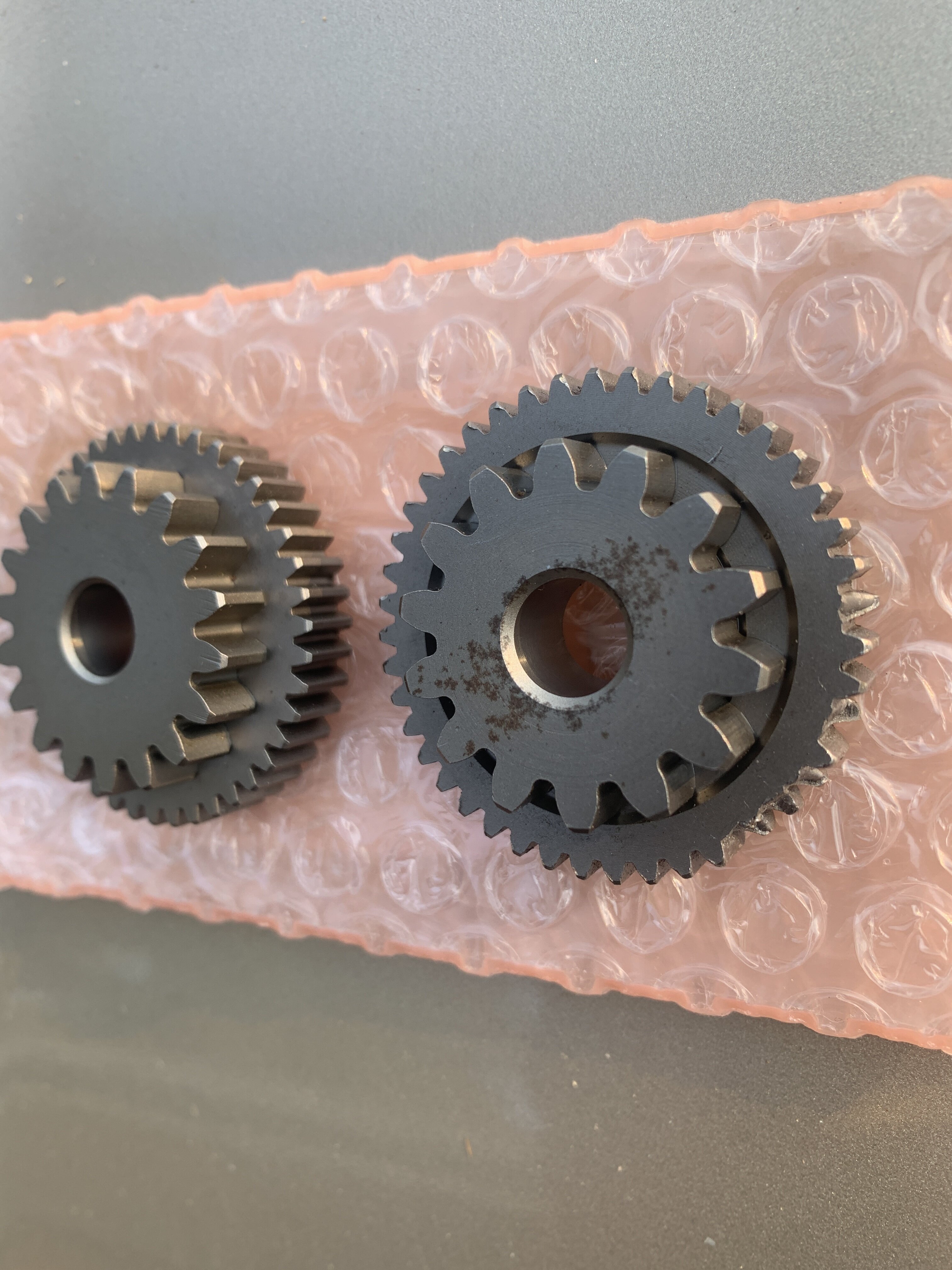

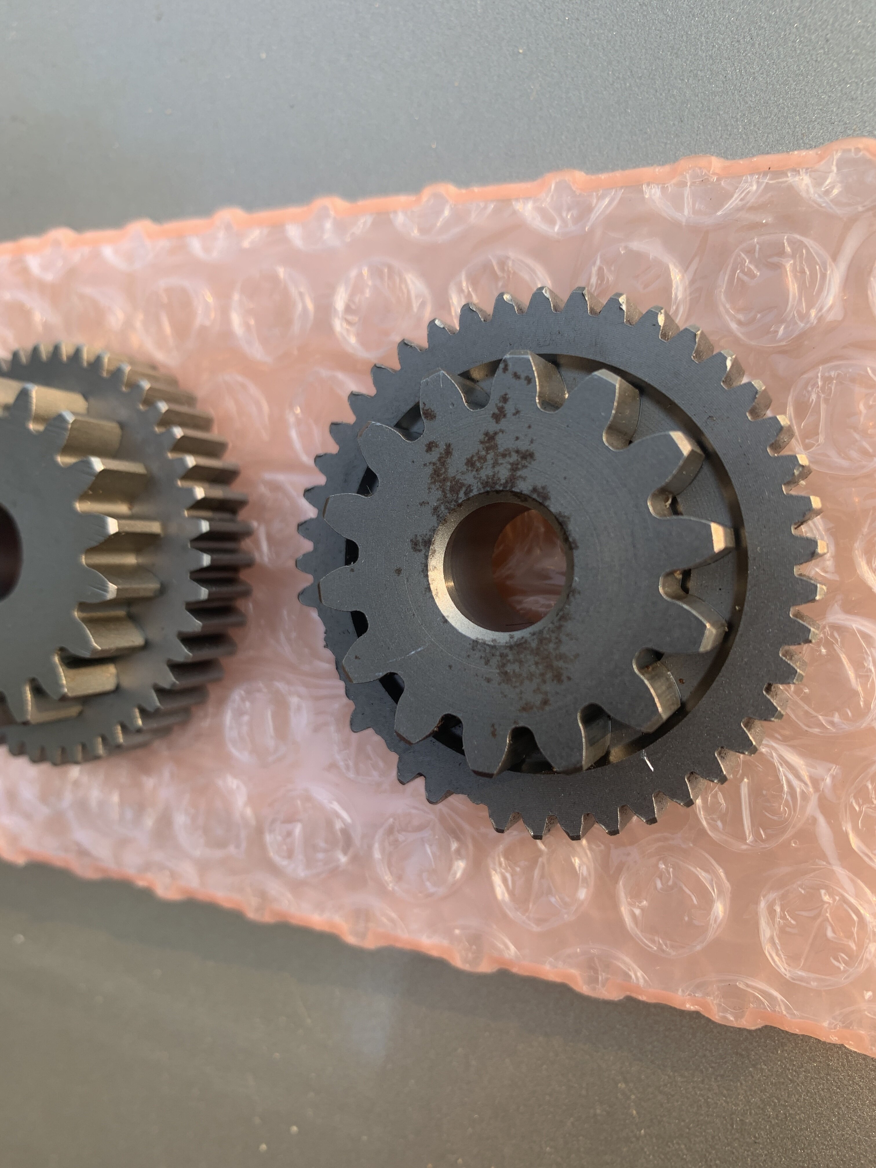

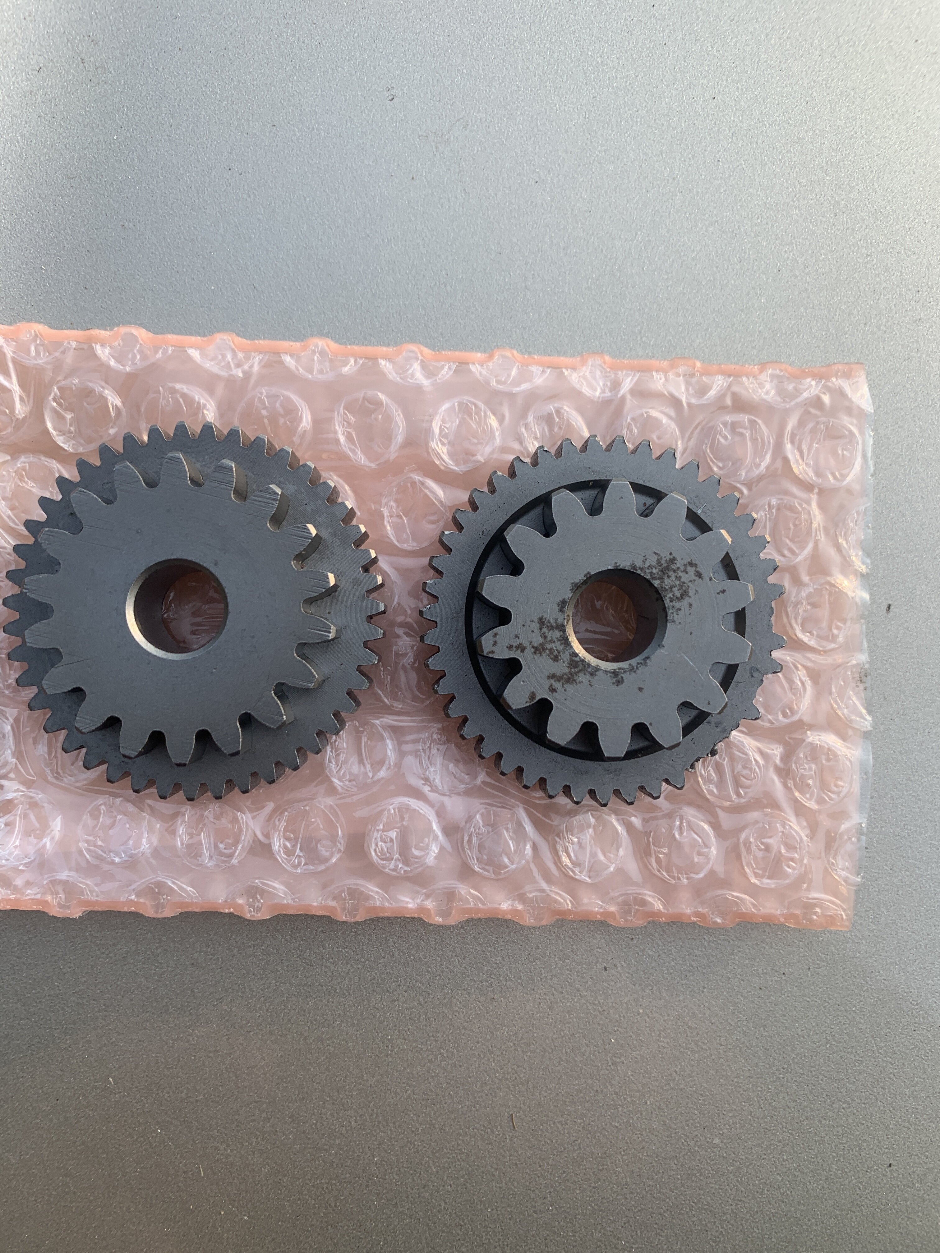

Well finally getting back around to the TRX 250. I found a gear set on ebay . Gears look good hopefully this will solve my problem. Soon as they arrive i will get them installed and smoke test it.
Finally got back to the 86 Honda TRX 250. Got the starter and the correct gears installed. Everything work great. But it still has this clunking noise when starting, once started everythings good, except it would only run on half choke, hadnt been run in a year and wouldnt start so my brother left gas in the carb, i powered some of my Berryman in the tank and in 15 minutes turned the choke off ran great. I hadnt riden this thing in years and i noticed a few thing when going up a hill if you let off the throttle it will roll back down the hill unless you apply the brakes. Also if it in in gear you can push it backward but not forward and i have no engine braking. So im not done yet, it was supposed to be an easy fix, i think the starter clutch is not working.
