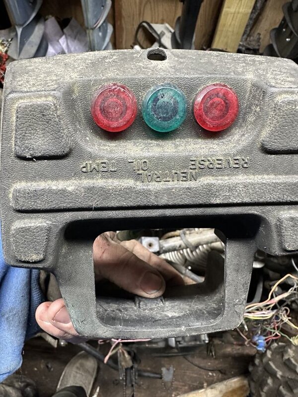

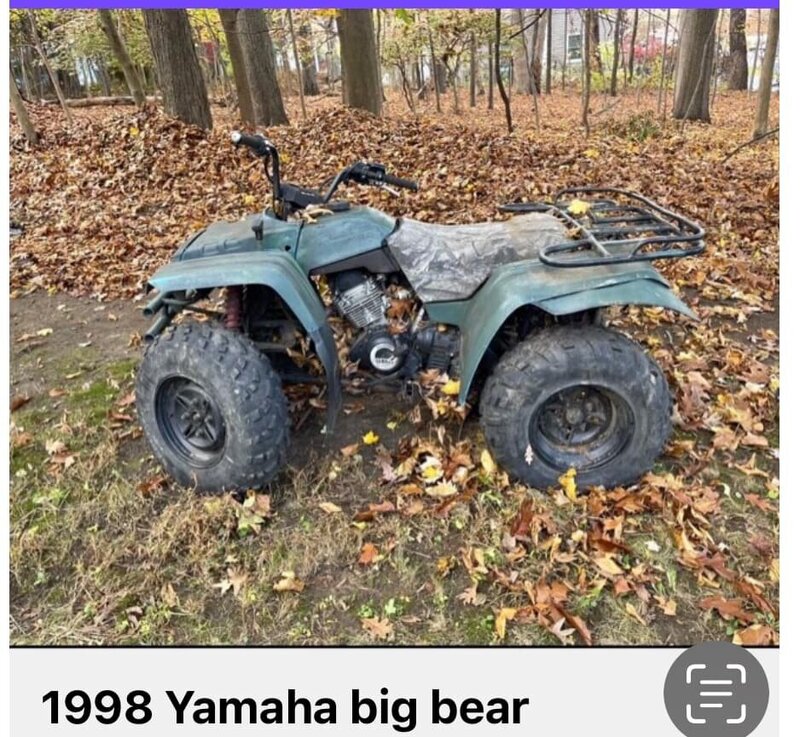

Forgot to say I was told it is a 1998 Yamaha Bigbear 350 4x4. Has a shifter on left side in the fender H/L/R
the rack has a cut out or bend in it to allow the shifter . Hope this helps

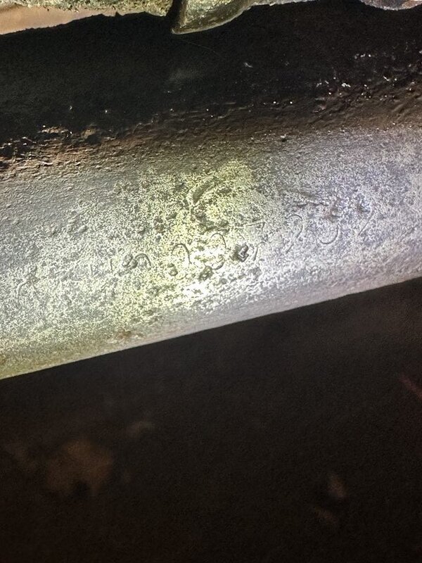

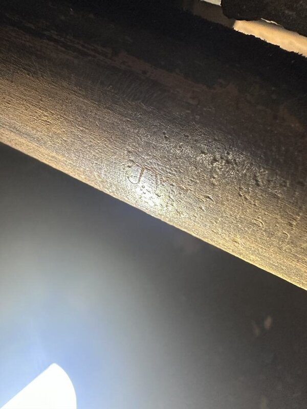

I agree late 80s early 90s the 10th digit of the vin would be the year, i couldnt really make it out , great machines, their flagship model at the time, full time 4 wheel drive and a fairly bullet proof engine. They were tough as nails and i liked the mechanical fender shifter better than the newer ones, easier to work on with fewer problems. Hopefully it hasnt been abused too bad , they were ridden hard and neglected a lot.
