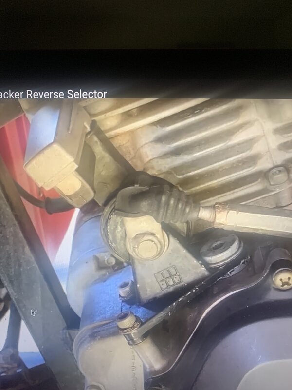

'Gidday.  An issue I can't find discussed already - my Bear Tracker selects into 1st gear fine. Selects other forward gears fine too but all above 1st gear are slipping. Can select reverse but nothing engages/happens.
Any ideas what I might be dealing with?
Cheers,  Jim.
Not sure if this is the type shifter you have not sure of your yesr. If it is you need to take the cable loose, or you may try adjusting it first, if no luck remove the cable, take the mechanism out, there is a small ball that gets corroded and sometimes wont let the shifter move correctly. That is the first place i would look.
