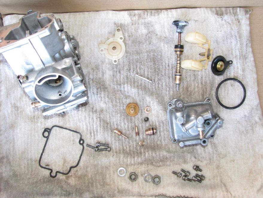

i cleaned it as best i could with conventional carb spray cleaner and put it back together. The bike didnt respond to the treatment. It ran, but wouldnt idle etc ...

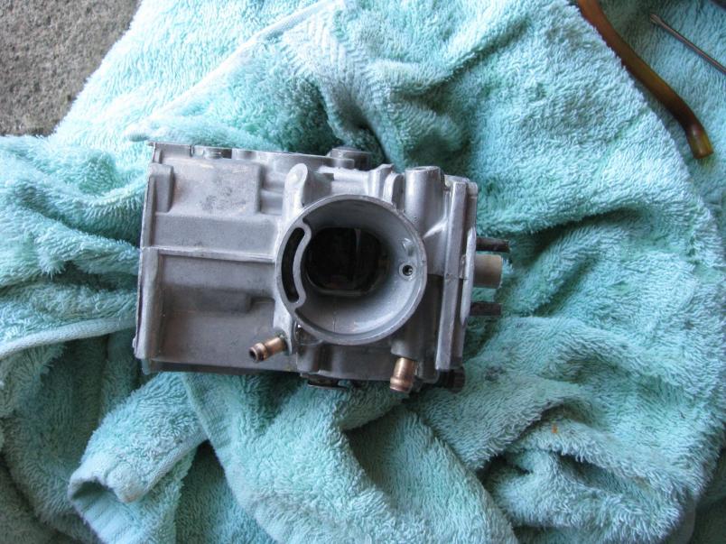

As of right now, my carb is soaking in about $6 worth LOL. while it was in the pail for the first hour, i pulled it out to look at it, and was amazed ... the carb looks new. If it does to the inside what it did to the outside, i will have it made!!
i will let it soak 24 hours and install back on the bike and give an update. i may have to soak it for 48, but i want to get it back together now ,,,
