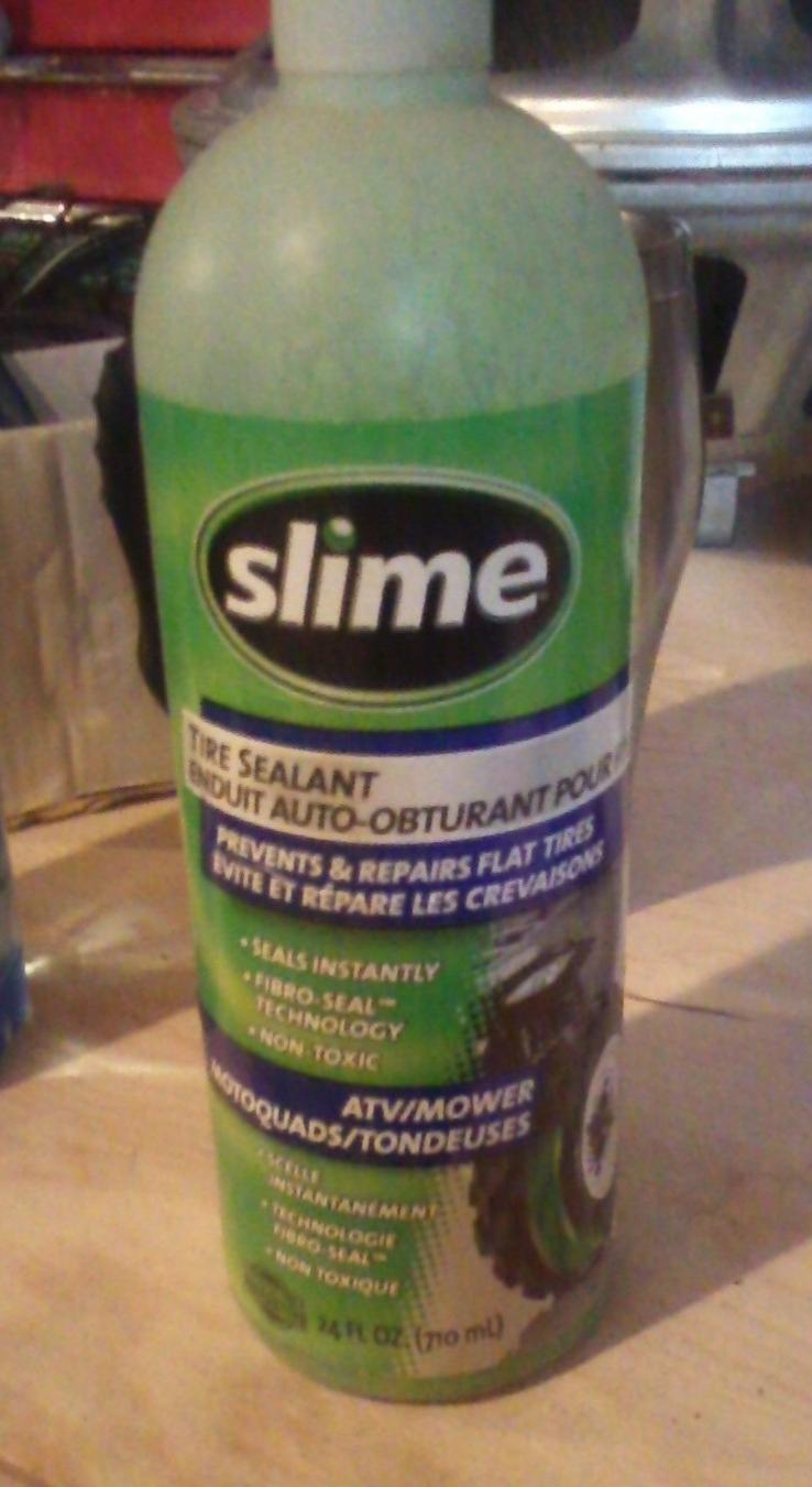

i had a problem with one of mine too, i ended up getting "slime" and running it around both beads ...
it worked ...
BTW, whats this slime you speak of?
No joy, gooed the Slime around and under where the wheel rim meets the tire. Bubbles up in 8-10 places. These are old wheels off an 86 quad runner. Polishing a turd. A guy on craiglist is selling a set for $50USD. Think I`ll go that route.
