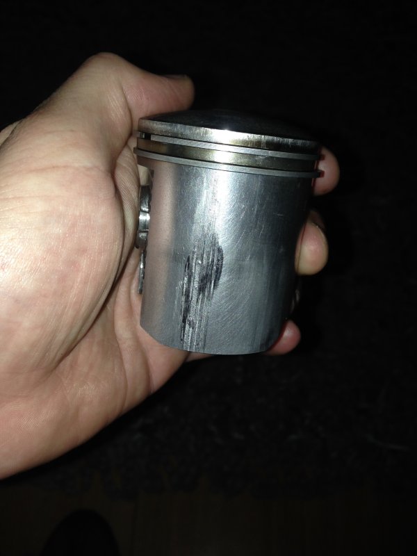

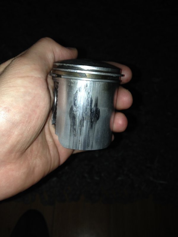

Since it is  a  2  stroke  it requires an  oil /gas  mix .  My  guess is  either  the  oil  injection  pump has  quit  working  or  it  was  out of oil .  A  lot  of  LT 80  owners just  premix  the   gas and  oil  and  forget the  injector.  Here  are instructions  stolen from another forum  on  completely removing the   injector  pump.  Most   owners recommend  a  32/1 oil mix although some  say  a   40   or  50/1 mix  works for them .  I'd  go  with the  32/1.

The  only way  I  can  think  of  would be to  disconnect  the  line  from the oil  injector  pump at the  carb and  temporarily  plug  the  fitting so  you wouldn't  have  a vacuum leak. .  Fill  the   gas tank with 32/1 mix  and run  the  engine ..  See  if  oil  comes  out  of the  line  from  the  pump to the  carb.  I suspect t  is   exactly  because of an  unreliability of  that oil  pump  that  so  many  eliminate it  and  go  for  premix.       Your  piston  displays   the classic scuff marks  of    an  oil starved  2  stroke.
"Fill  the   gas tank with 32/1 mix  and run  the  engine ..  See  if  oil  comes  out  of the  line  from  the  pump to the  carb."
I agree..
What piston did you use? China kit? It stick on the intake side?
Some work, some don't. I run a ball hone thru them and make sure the ring gap is right (been tight when I look/no gap).
hopefully you didn't replace the studs, they are weak.
