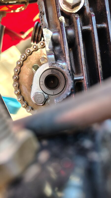

Did a top end rebuild, honed .010 over, new piston, rings, valve seals, etc. When i re assembled i only had like 30 psi of compression but then after it sat all night i now it seems to have gained some somehow, there is much more resistance pulling it over and i even got it to fire for a few pops. Issue i got is that it makes a loud squeak noise through the intake i believe (goes away when throttled so something with carb area) and it seems to not want to run well. I took head cover back off and timing seems fine so im not sure if something is sticky and that's why i got some change over time or maybe the valve lash is messed up after doing all this, i did get another cam for it but i wouldnt think it would make enough difference to need to re lash. Any insight on next step would be appreciated, i will be looking up how to do lash on these because it is a very weird angle to slip a feeler gauge in.
Actually cam is slightly off now that i look at the picture, thought it was good while looking in person. Hmm.
Update-so ya the valves were wayy too tight, adjusted em and now i got ALOT of compression. Sure hope i can get this electric start working now because thats going to be really rough to pull start every time ha.

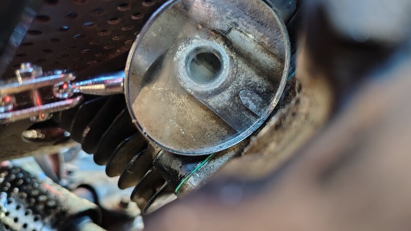

Well now i got what i believe to be an intake leak, my rebuild kit said it comes with a new o ring but i didn't see any that fit really, only 1 seemed close and it was a bit small. Tried to make my own gasket outa gasket paper, but doesn't seem to be working well, only runs with enrichment on and also does this. Guess the carb comes back out again for the 100th time lol.
