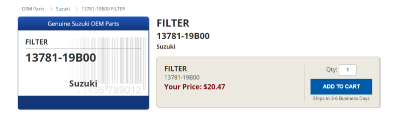

What I normally do if i want to get factory part numbers, I try one of the online catalogs for suzuki and then I check the aftermarket sites like bikebandit. try this https://www.suzukipartshouse.com/oemparts/l/suz/50d0a4aaf870022c2c53496c/1995-quadrunner-lt-f250-parts
Then you can take the part number and do a google search to see if there is a less expensive version. So the air filter looks like a part # 13781-19B00 which on that site is $20.47

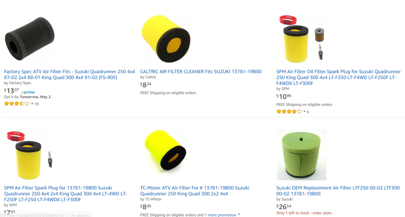

You can also punch that number into Amazon and you'll see a bunch of lesser expensive aftermarket filters available
Suzuki LT 250 Air Filter Amazon

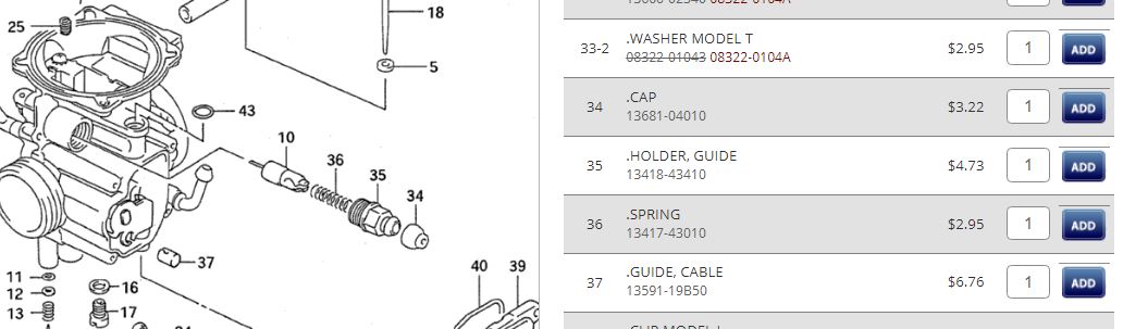

5af2afdfa5f08_lt-chokediagram.thumb.JPG.37829ecd14ca7b10e78ab079587b4d8e.JPGOk, so I suspect I know the answer, but...
Running realllllly rich. fouling the plug bad. The choke cable assy, where it meets the carb, is a sweeping plastic piece that screws into the carb body. This is just a cable guide, but sealed from outside air, right? On mine, this plastic piece is cracked thru/broken and letting air into the system. Mine is different, but shows as #35, here:
