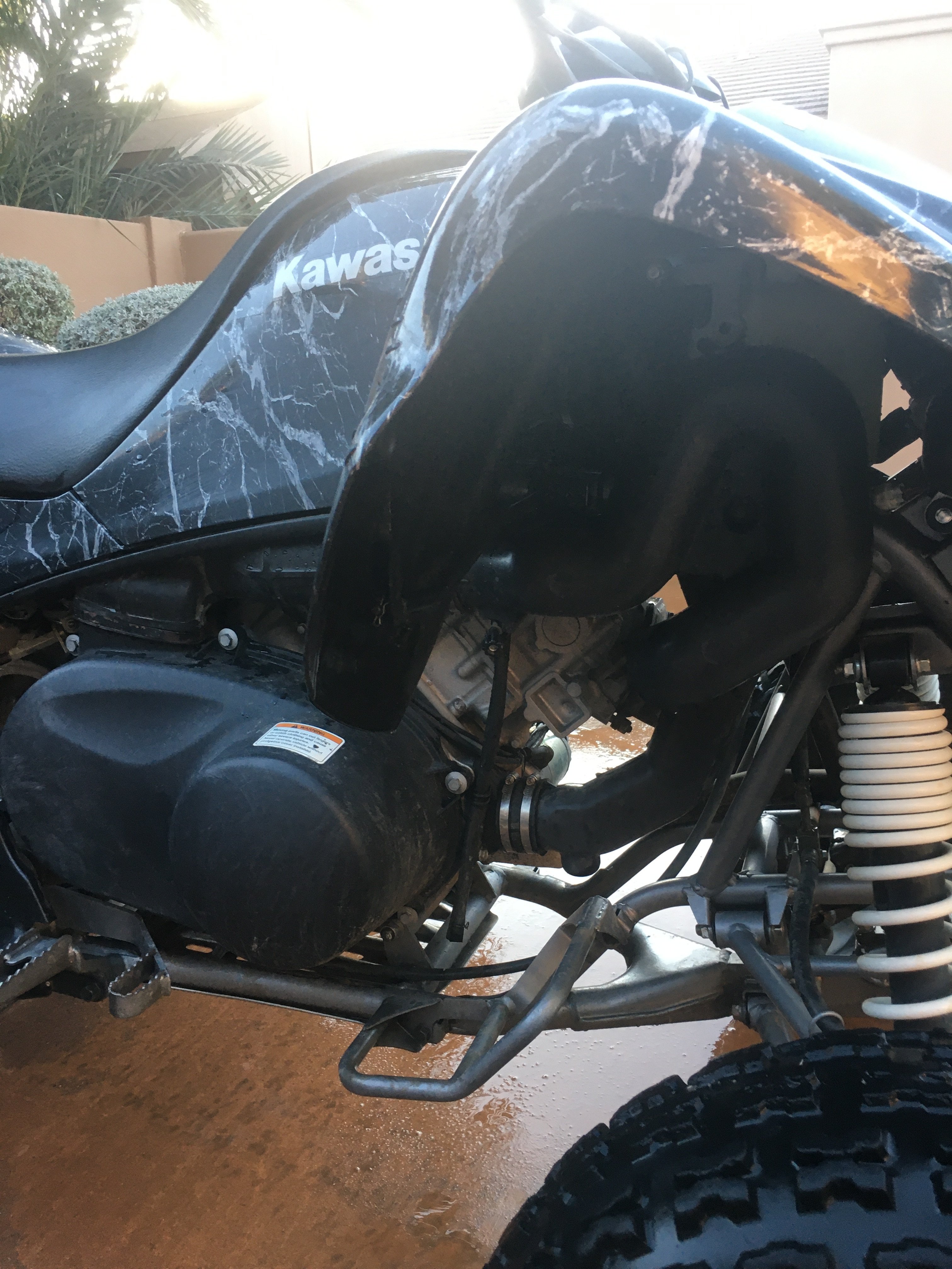

I recently picked up an ‘07 KFX 700. All was going well, rode it about 40 miles, when it started bogging at low speeds. If I kept the revs higher, I was just fine. Also, a persistent issue since I picked it up is the fairly difficult start (but it is abnormally cold right now and the quad is jetted for the dunes at summertime).
Regarding the complete lack of idle, I have to rev it a couple times to get it to idle after starting it, after which it’s 50/50 whether it remains idling. I don’t have low fuel, but all of this began after I rode it pretty hard and the radiator fan kicked in. Might be overheating, just wanted to hear your opinions.

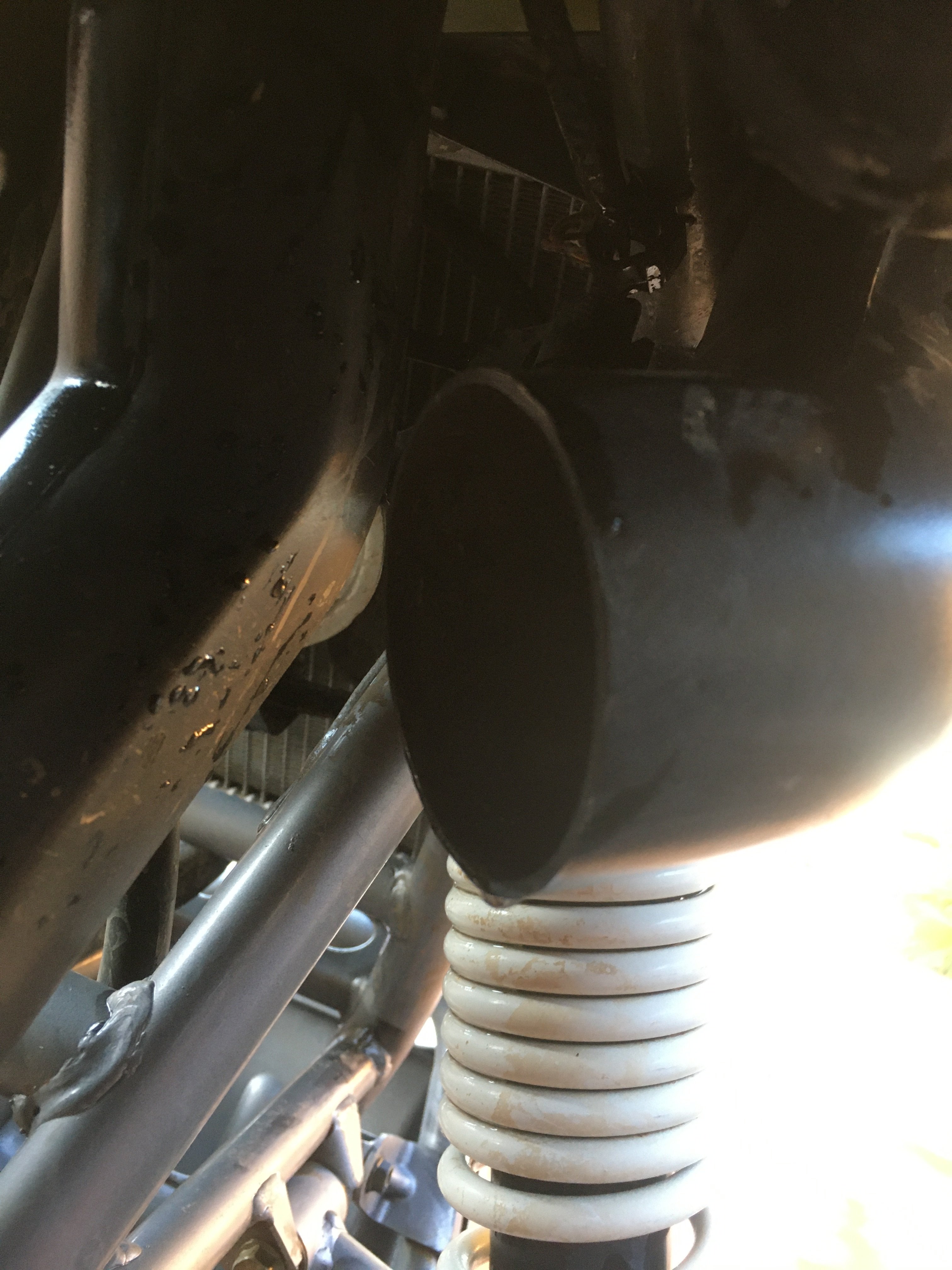

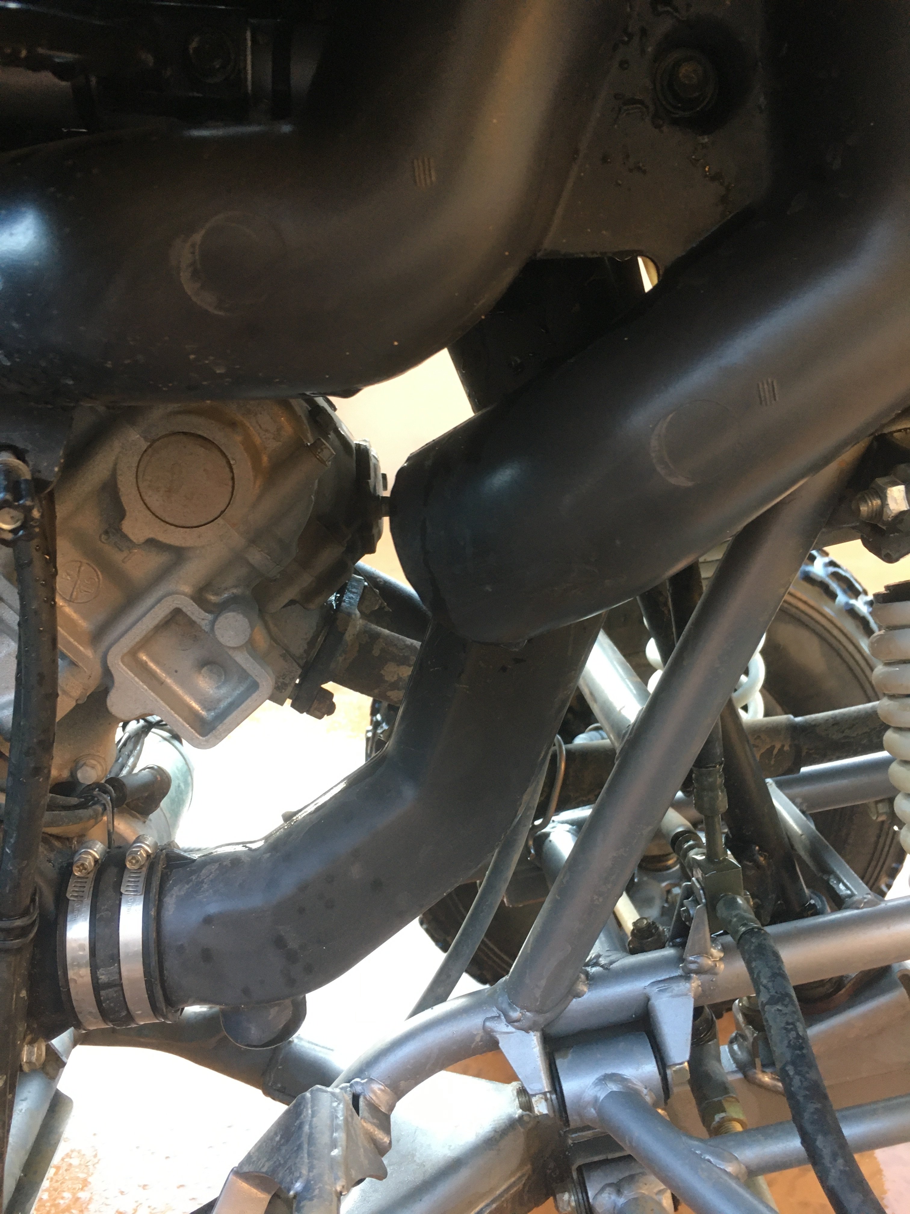

The duct looks fine. That engine is water cooled. Over heating is never a good thing. It really stresses the engine. Check the thermostat or the water pump. The sensor that brings the fan on could be lagging and coming on a little late as well.
Check your coolant level and that its moving fluid through the system.
