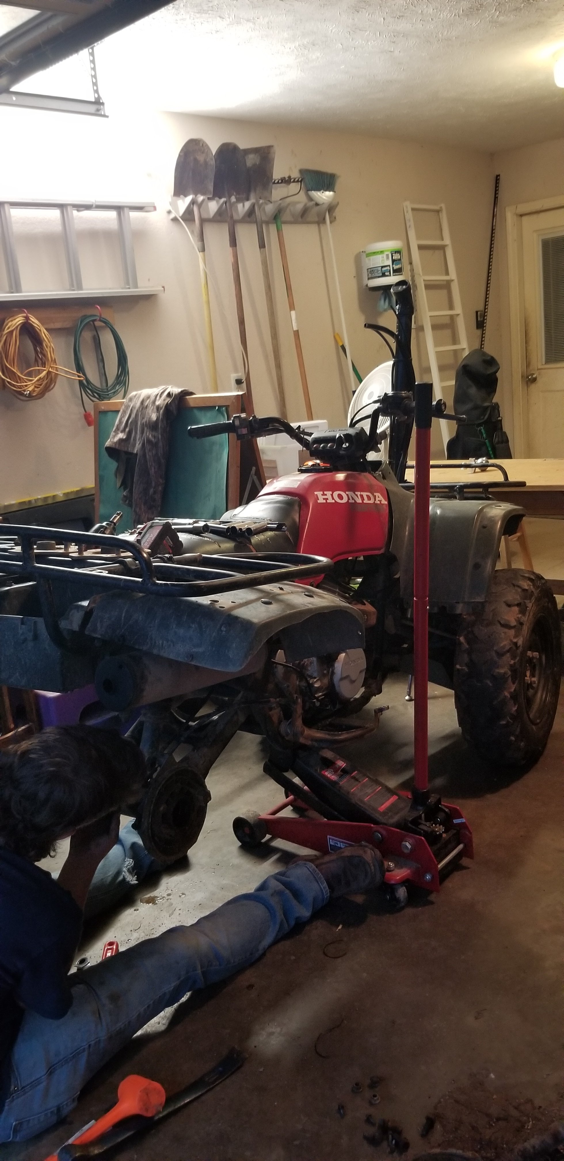

New project in the shop...another 300FW
Picked this beauty up for zero dollars this weekend. It has been passed around several of my son's friends and the last kid was just tired of tinkering with it.  Mostly complete 96 300FW. The pic is my boy robbing the swing arm and rear diff for his 300 for a big memorial weekend ride. Wiring is garbage at the battery, kick start doesnt work, no coil, smoked like cheech and chong when it ran last. I figure a couple hundred and a few hours and this will be ready to ride. Journey will be documented on Instagram at @martincyclellc if ya wanna follow along.

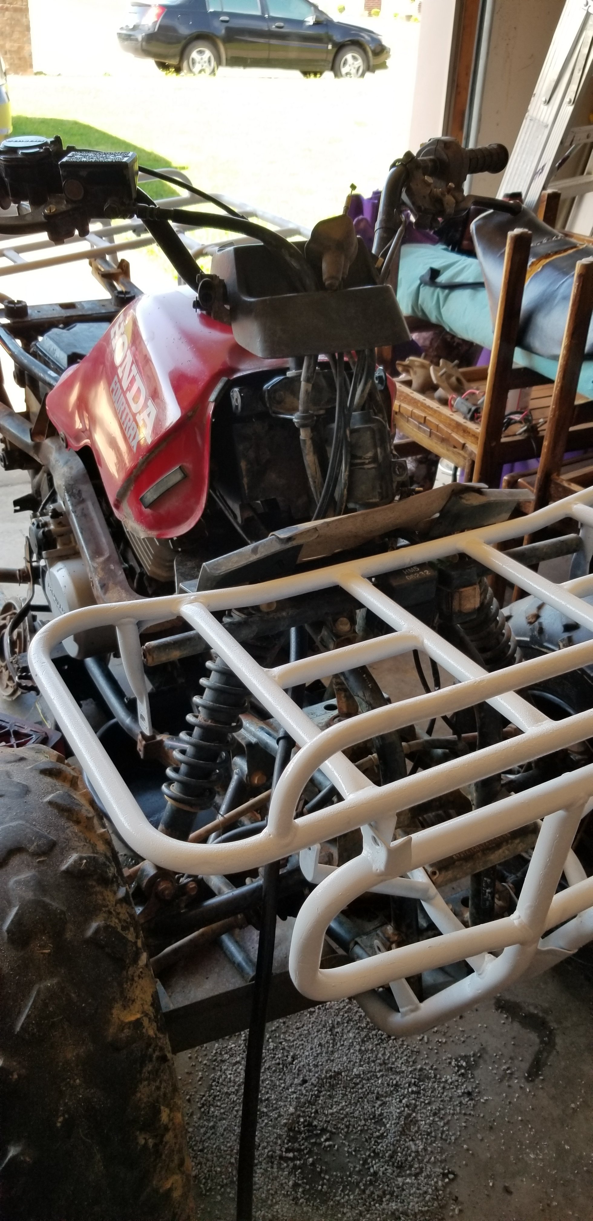

That is definitely NOT a banjo bolt in the middle of that oil line. This little 300 is just full of surprises.
