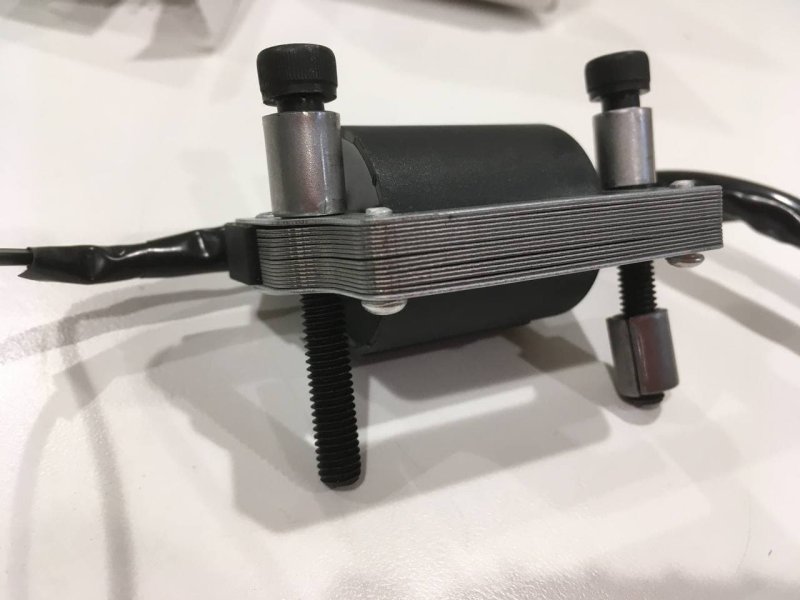

So I bought this quad and it came without an ignition coil or the bolts to mount it.  The coil that I purchased from ebay also does not have the bolts.  I purchased some bolts and spacers but what I cannot tell from photos and repair manuals is whether or not the mounting bolts are electrically insulated from the frame of the quad.  Does anyone know?  I just don't think it would make sense for it not to be electrically insulated with rubber?  So before I go searching for rubber does anyone out there with more knowledge know what to do in this situation?  Bolts in the photo.
Someone may correct me, but I'm pretty sure the outside plate around the coil is meant to be grounded to the frame. All of the circuitry is encased in the cylinder part.
