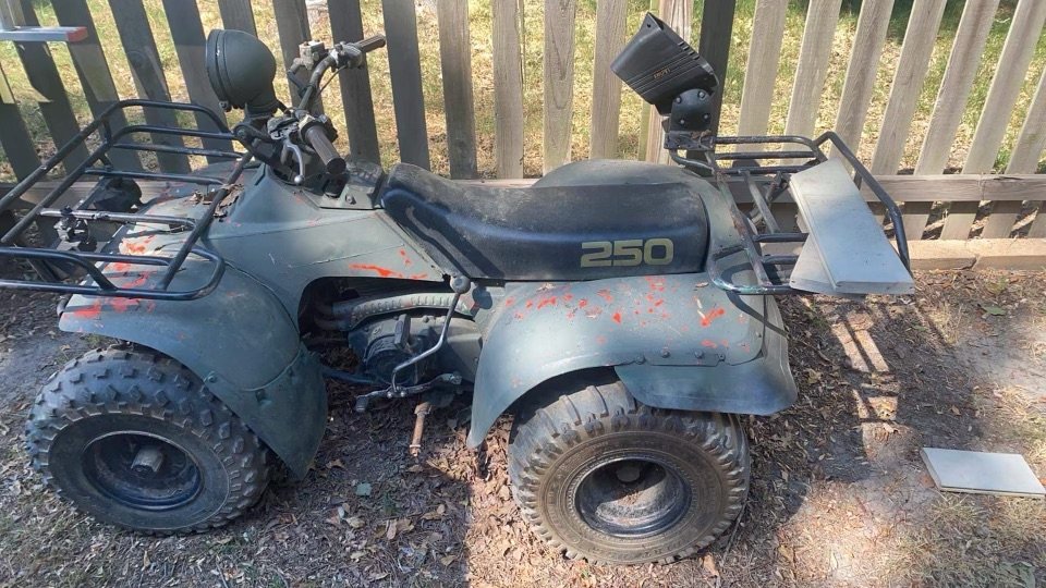

Traded for a 1985 Suzuki LT250 with thick green paint that's peeling and cracking.
Want to remove all the the paint and start fresh.
Anyone know of something that's effective and won't hurt the plastic.
Appears to have multiple coats.
Any help will be appreciated...

You can try oven cleaner, sometimes that will bubble the paint but shouldn't hurt the plastic.  If you can get it to bubble a little, a pressure washer will do the hard work.
Lots of times on paint that is that badly done, you'll get the paint off only to find that they sanded it with 36 grit and ruined the plastic.
