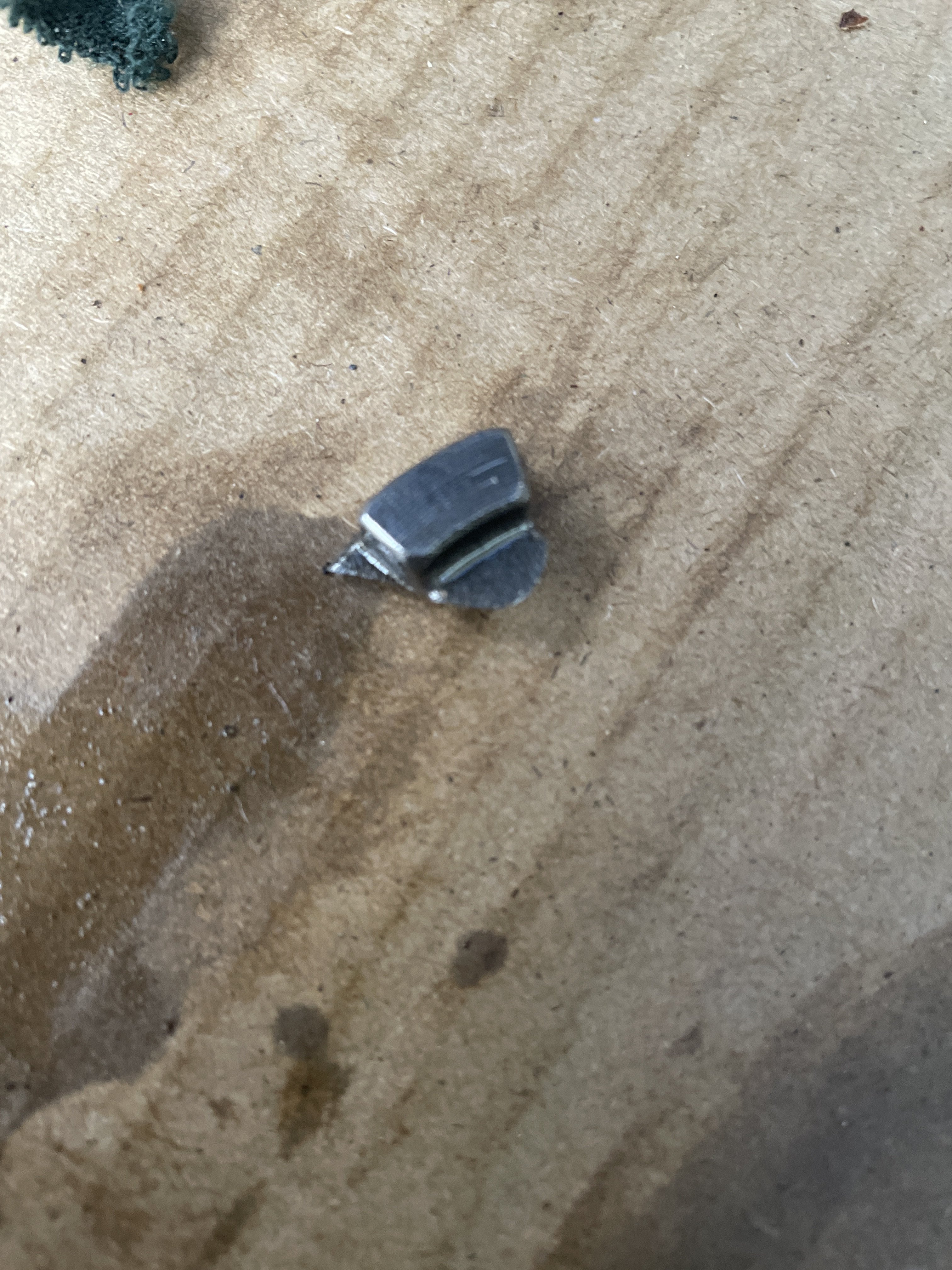

Hey Mech, so I don't see any adjustments besides the cable, so I YouTube some clutch videos, and you're right about it being the clutch I was talking about, and not the gears. I'm not familiar with all the parts and how they function just yet, so sorry if I'm hard to understand or not explaining well. Anyways, I just watched a couple videos on clutch replacement, and they tipped the bike on the side to avoid draining the oil and coolant, and opened the clutch case to replace the spacers, along with what I assume are the clutch disks? They had little grooves and had to fit in there in a certain way and order. Is that what you're saying to look at, and if so, what am I looking for? Maybe I should just change them out if I'm going to open it up? The part I said the guy filed before, was in that box I believe, but it wasn't the disks I don't think. I feel like it was what the disks slide onto. I'll have to find the video again.

Morning Chris. Yes I'm in N.Z.. And yes that's the clutch basket he's holding in his hands, which is the bit I was saying might need the wear taking out of.
The steel plates can be checked for flatness and obvious wear. The friction plates you replace. Both the hub and the basket the plates fit into, need to be checked for wear where the plates press. The basket's normally the worse and easiest cleaned up with a fine file. The new clutch plates must be soaked in oil before they get fitted.

Ok.. Well that's a bit nasty..  When you start taking parts out of the cases, lay them all out in the order they come out.. Top parts away from you, lower parts closer to you on the bench, parts that come off shafts layed at the end of the shafts they come from, all the gears and spacers layed out in the order they go on the shafts. It saves a lot of checking and worrying if you know where they all go back in.
That's sounds like a good way to set up. I definitely need to be Methodical and clear an area. I took the time to label everything I've done so far with the clutch, and even labeled the screws to which hole, because I saw they're different lengths.
