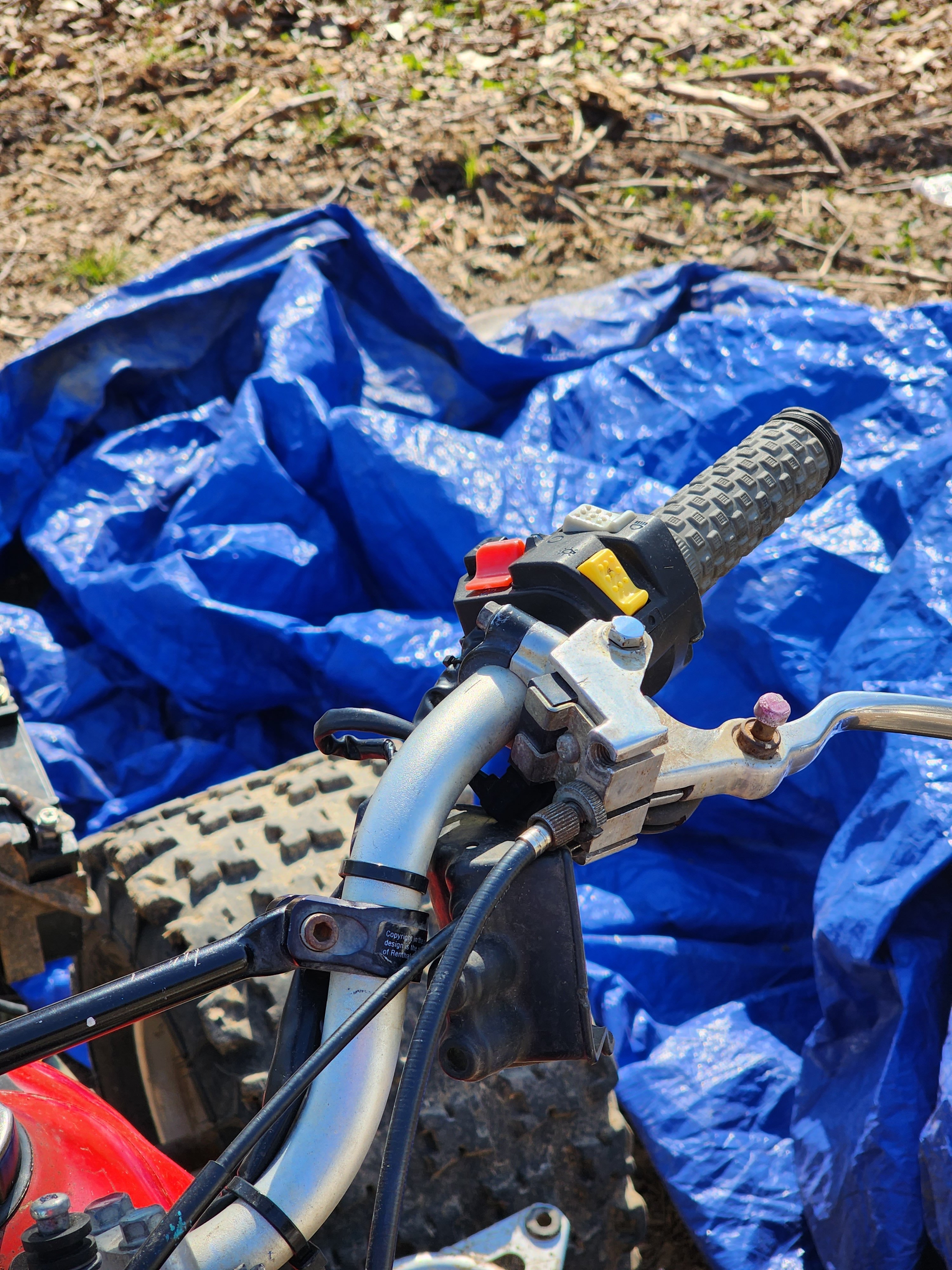

The cable was missing when I bought this atv. I'm not sure exactly, what all is missing to use the reverse. There is a small lever that has a notch for a cable and a red button on the left handlebar. Also, there is a linkage on the right side engine cover which has a cable slot also. I'm hoping, when I put that cover back on, the cable lever was in the correct position. Any info on what all is required to get the reverse going on this would be greatly appreciated!
On the left brake handle there is a button you push, and hold the button down and pull the brake lever at the same time, then push the shifter down to go into reverse, the left lever has 2 cable one for brake and one for reverse. The lever I think you are talking about is for the parking brake, it just hold the lever in the pulled position.

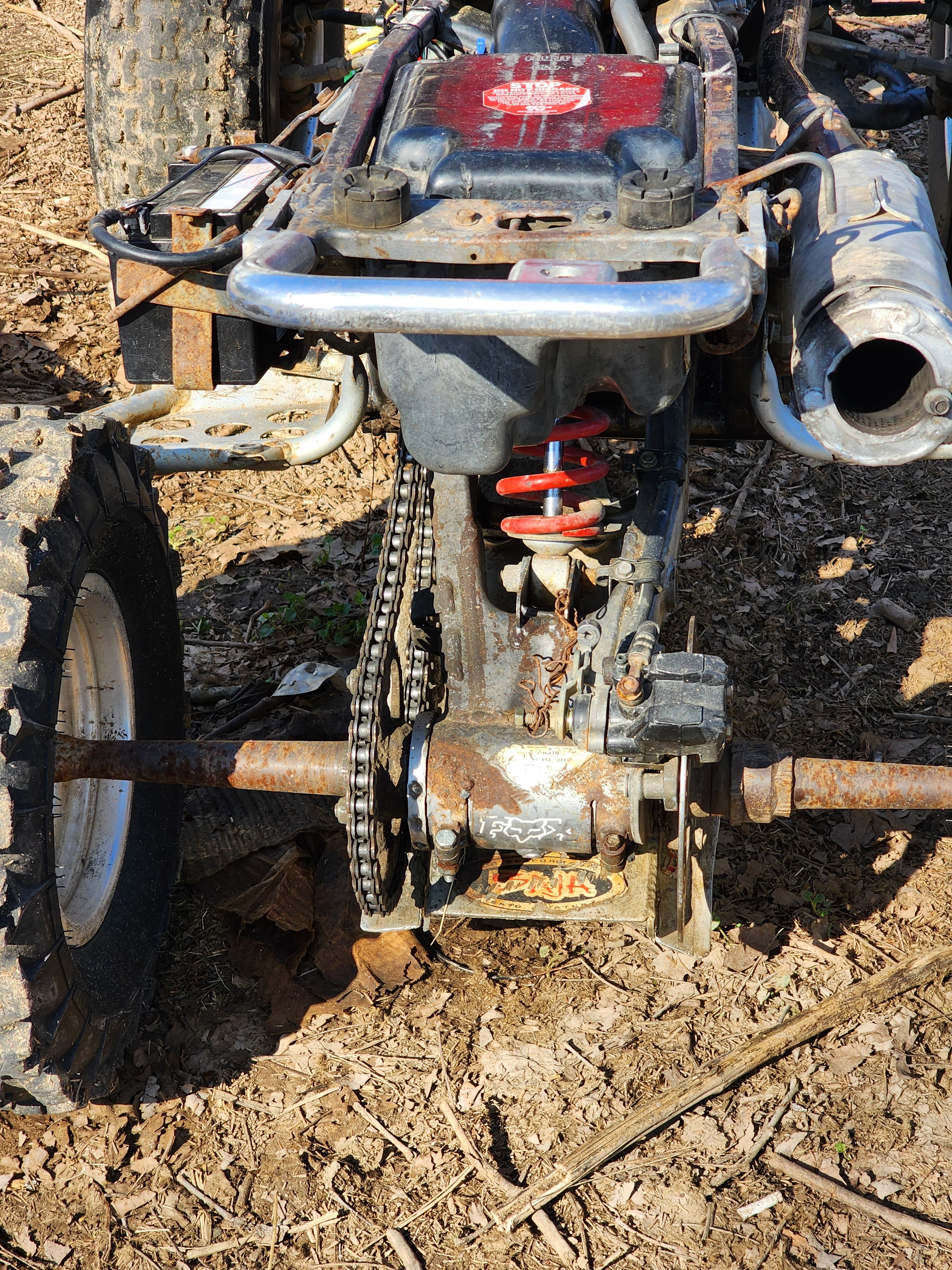

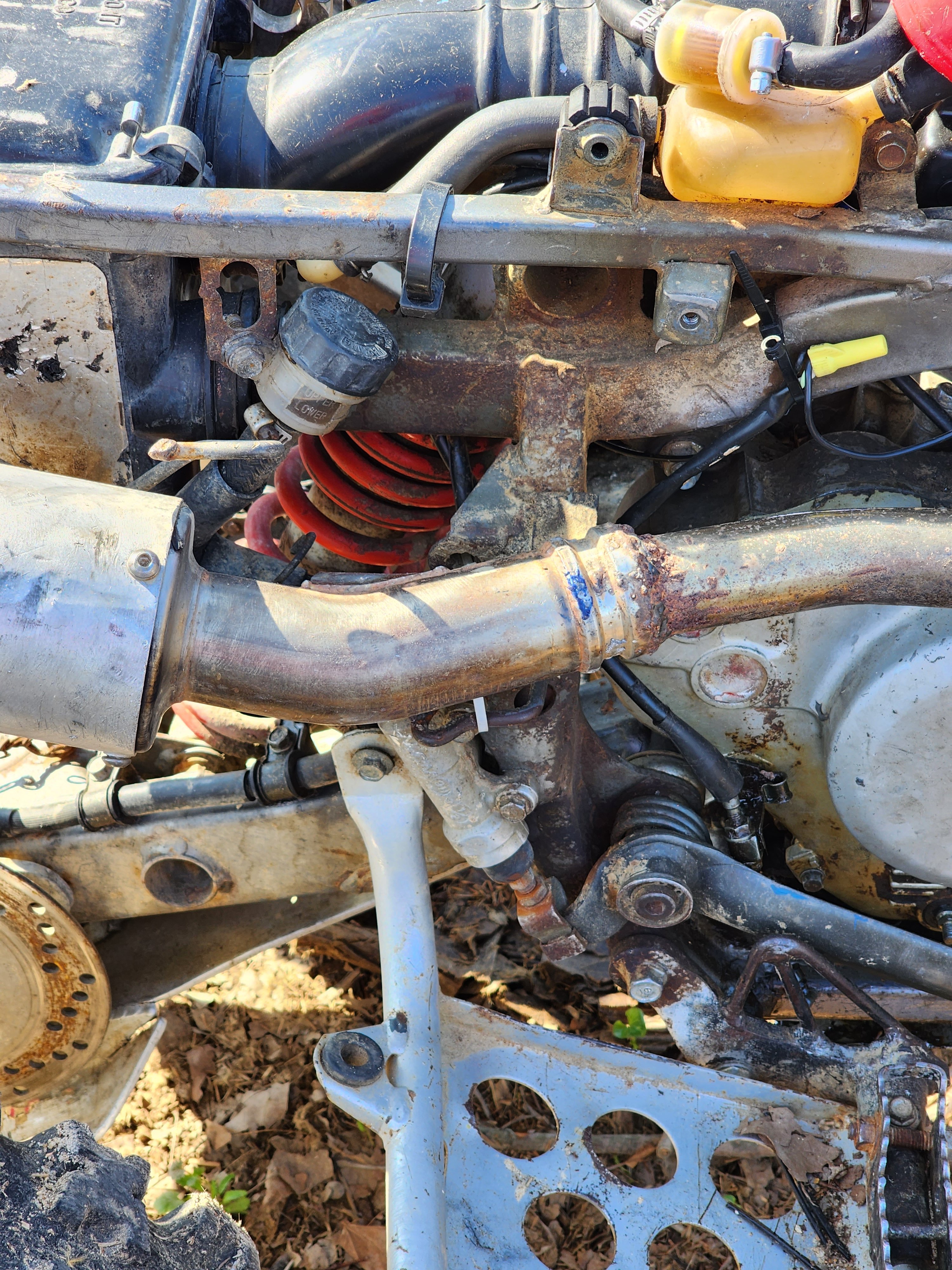

Here is the left handle bar and the other, shows the questioned cable running down below the exhaust  on the right side case cover. The last shows some wire wrapped around a lever on side of caliper which I figured is for parking brake. I guess, they did that since the cable is missing. Thanks!
Also, I can't even get a wrench on the bleeding nipple with the hose in the way?

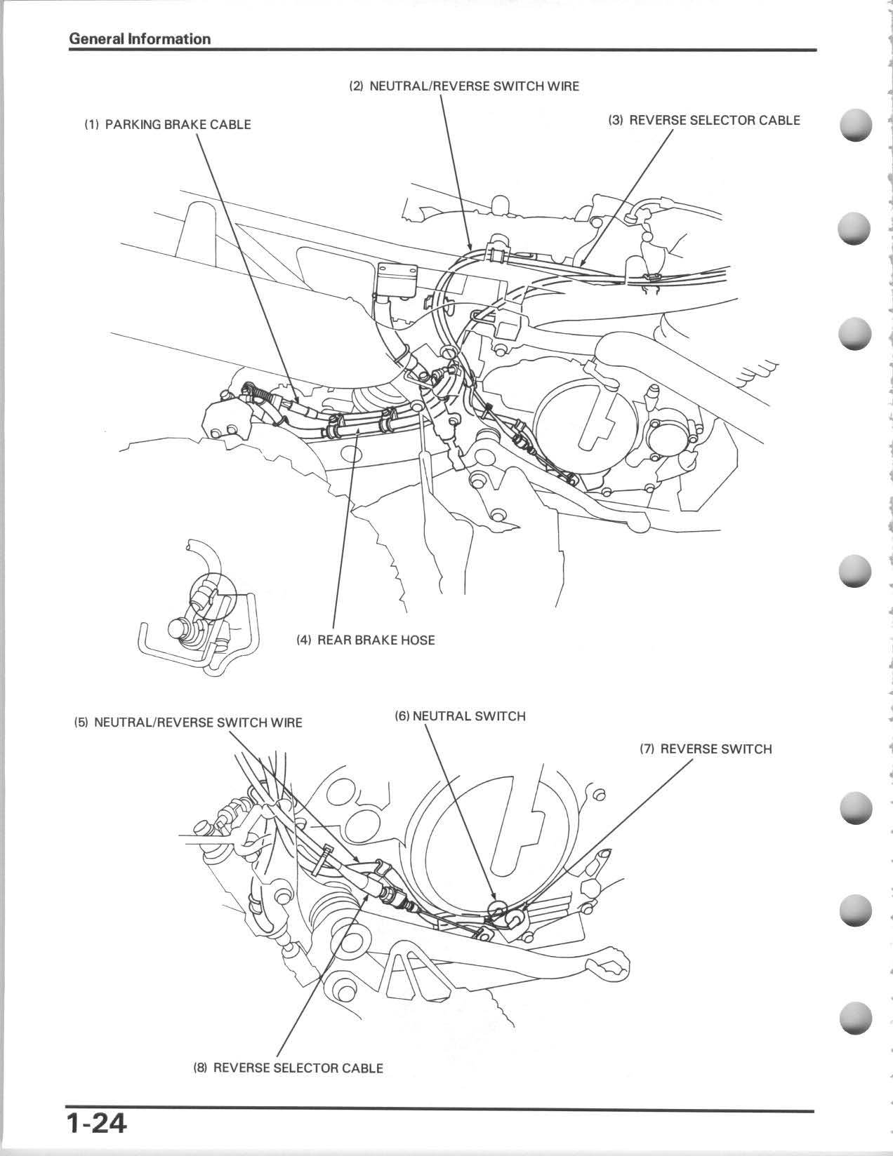

No I sure don't T #8 cable connects to a small lever through the cover. One of my concerns is I hope that lever was in the correct position when I put that cover back on so the reverse will even work or if there is only one way that it will go back on? I need to see where the other end of the cable is on top because it isn't going to the handle bar. What a mess and I really do need the reverse working.image.thumb.png.b6463f37fffd7d5bc74ce3da80ce6c5d.png
It been a long time since I looked at mine, i would go look but its 100 miles away,  the lever should  not have  moved out of place,  you will  have to adjust the cable to get it to work correctly. Once you get the parts you will be able to better see how it all goes together.
This is the part I'm hoping, I installed back inside the crank cover on right side correctly. I traced the reverse cable to the handlebar and it is hooked up. I should have hooked it back to the cable shaft and I wouldn't have lost the part. I guess I'll have to try to order the end piece that the cable ball slides into. Confused yet? I sure am LOL!  2000 Honda TRX300EX Oem Genuine Reverse Cork Line Cable Shift Shaft With Spring | eBay

After tracing the reverse cable, the only part I need is the small reverse lever that the cable end slips into. I've got the nut for it I just have to find a reverse lever.
