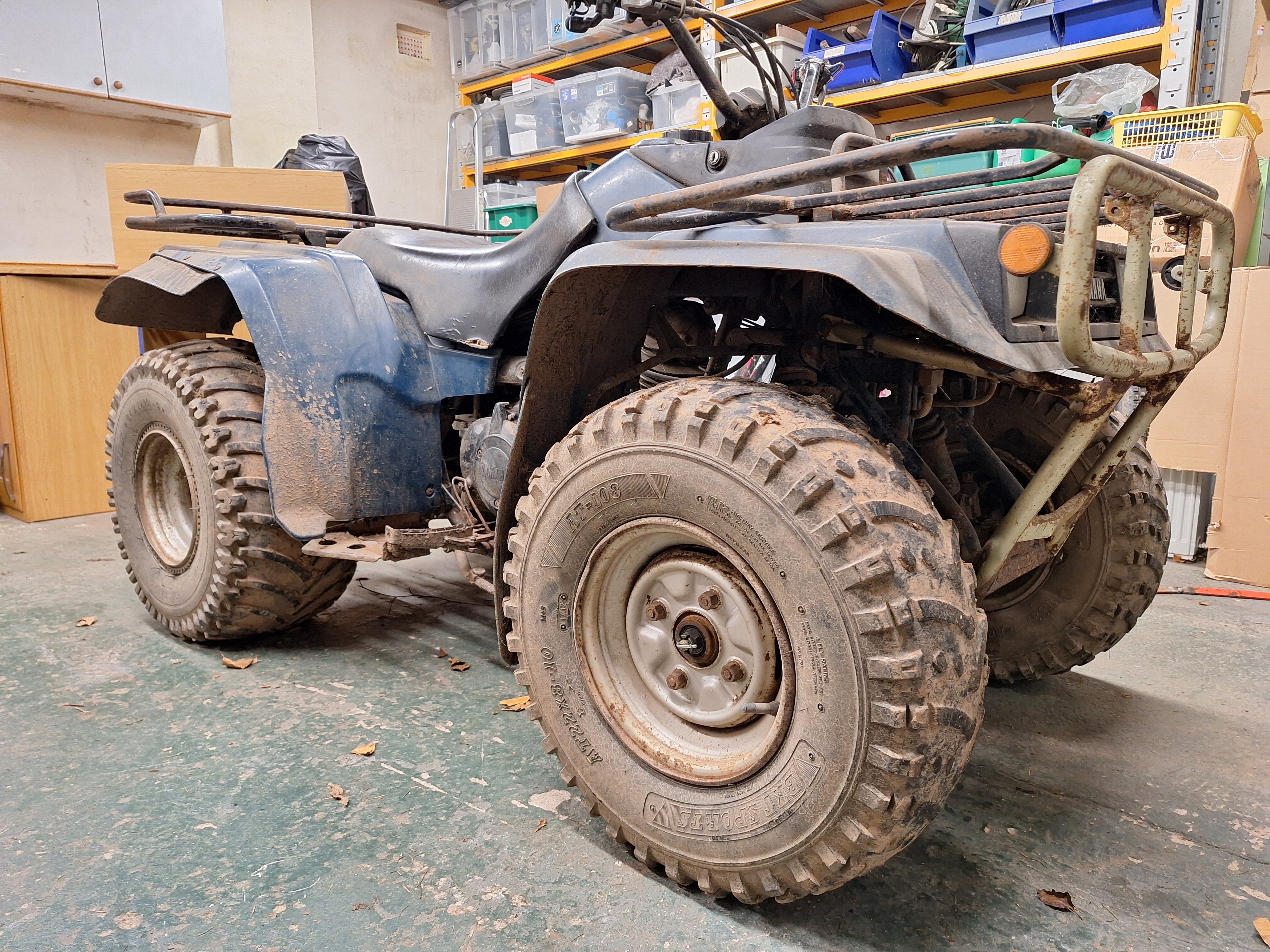

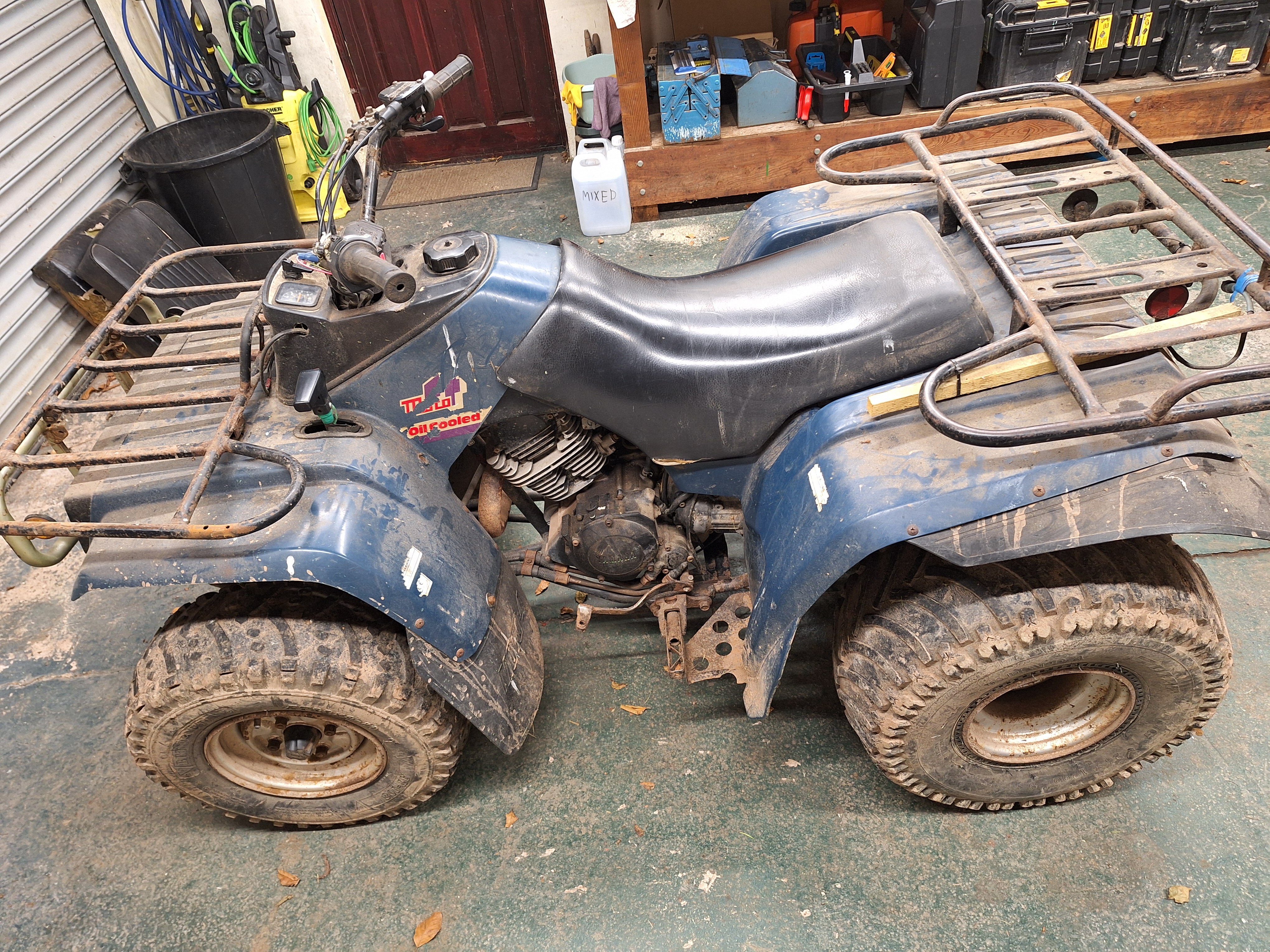

I'm new to the forum, I live in the UK. I have just bought a 1995 Yamaha Moto 4 350.
Generally the condition isn't too bad (I paid very little for it!), it looks quite original and all the plastics are quite good. The bad bits are no brakes, the rear axle bearings are shot and the transmission won't shift through the gears properly.
I'm not planning on a full rebuild but I would like to sort it out a bit. The transmission is my main concern. If anyone has any ideas on what might be the cause I would be grateful. I can explain what's happening in more detail if required.
