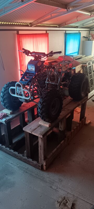

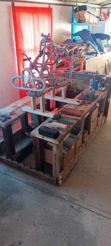

Good work! I built one for motorcycles do a lot of that kind of work, the only problem i have is getting them on and off i ended up mounting a winch to get them on and off, kind of works.
