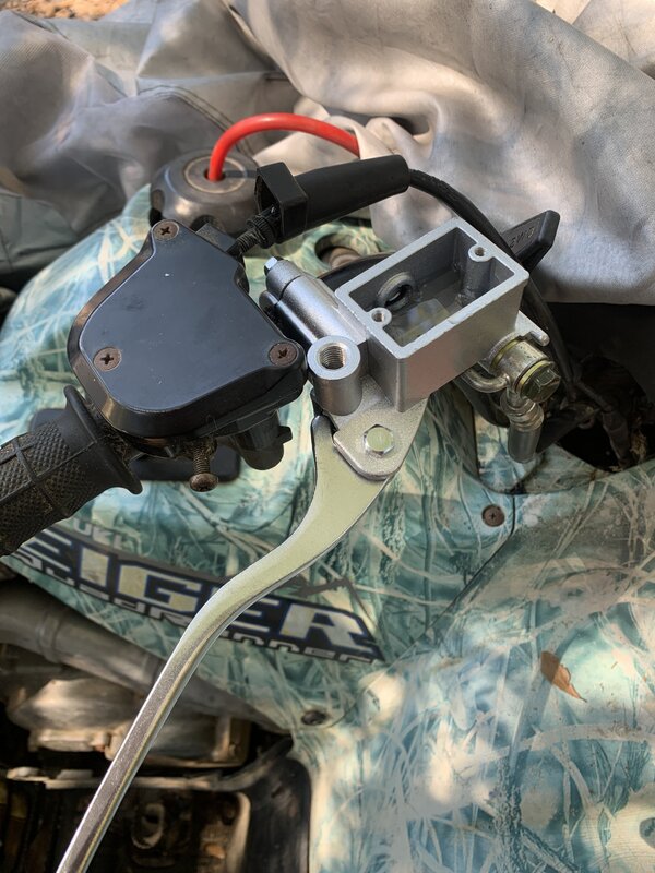

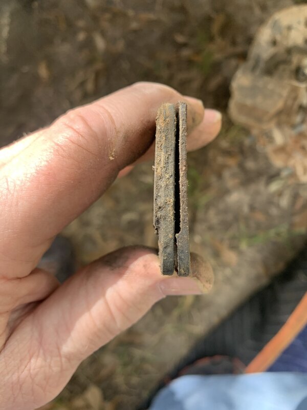

I decided it was time to do the brakes on the Eiger, i got it a couple of years ago and worked out all the bugs got it running good and ignored the brakes. None on it ,front or rear. Decided to attack the front first no pressure on the master cylinder and screws were stripped out on the reservoir, took the banjo bolt loose and pure water ran out, glad i didnt wast time on drilling the screws out, pads were shot also. Pulled a couple out of my box o parts. One was for right hand so wouldnt work, the other looked fine until i opened the reservoir and full of white powder. Cleaned it out anyway and tried it, only would build up a minimal amount of pressure. So no go on that one. So ordered new master cylinder and pads, so now i have to hurry up and wait.

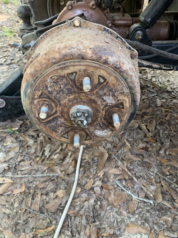

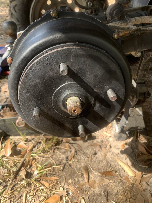

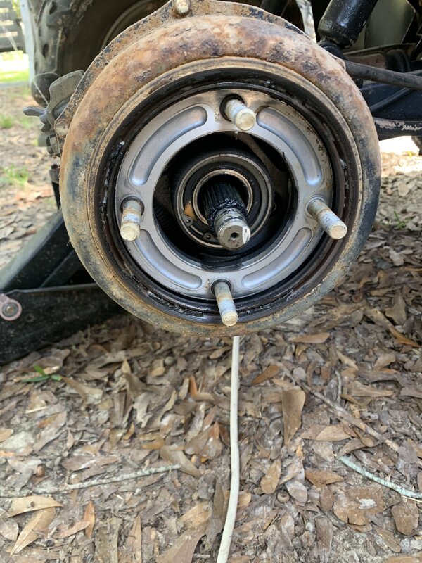

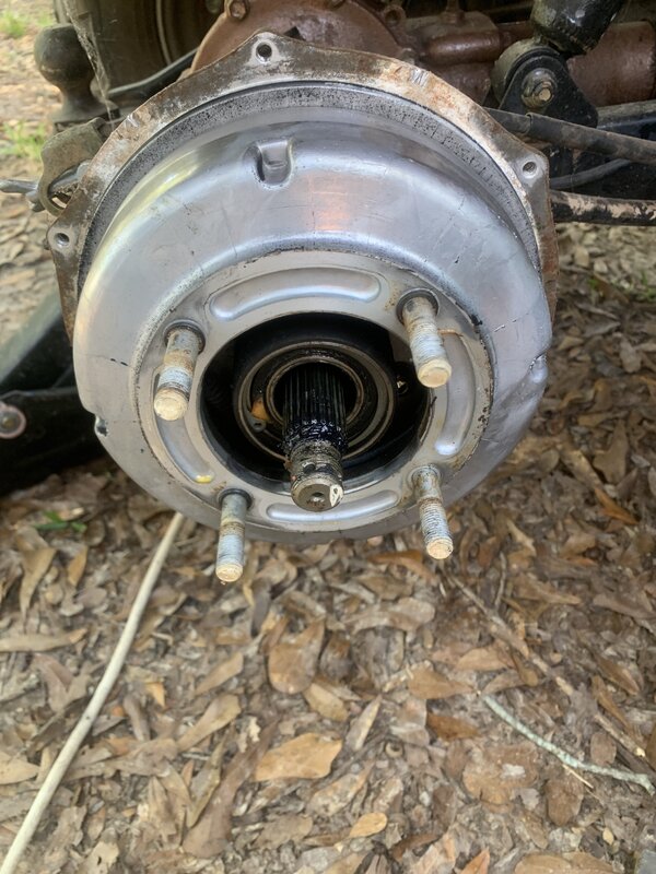

On to the back they are drum brakes so i knew this would be fun, 20 year old machines that have been mudded and abused for that length of time nothing comes off easily. The engage shaft was froze solid from corrosion. Getting that out is easy but you have to get to it first.
The center nut was supposed to be 30mm but it wasnt it was 27 the only size not in my large set, go figure,

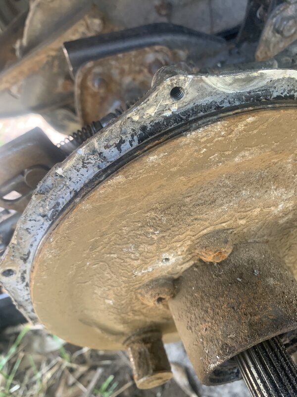

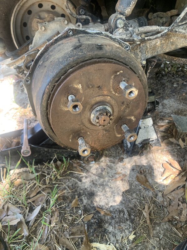

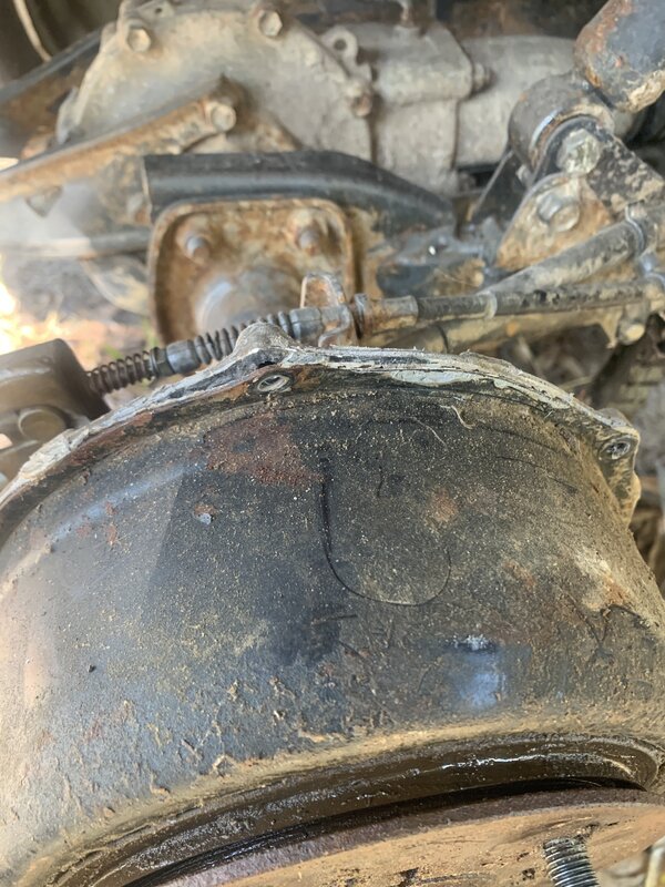

The previous owner decided it was a good idea to JB Weld the cover on making it near impossible to get off, had to chiesel it off.

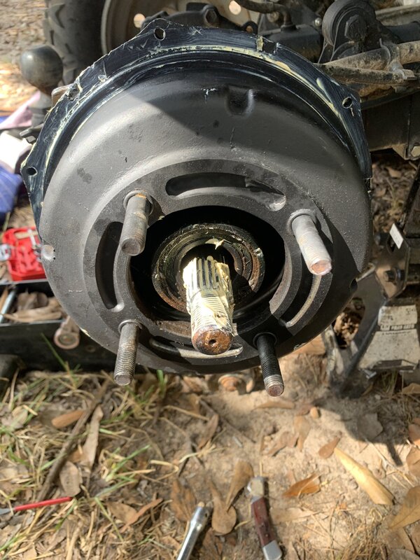

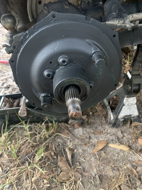

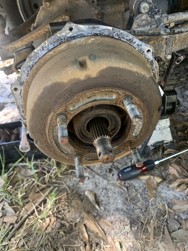

The mounting plate was a different story, nut was tight tight tight took my biggest impact two or 3 times hammering on it to get it loose after soaking all night in PB Blaster. Got it moving along the splined shaft easily but wouldnt come off, when it got to end of its run it would just stop, ended up using 2 24 inch pry bars one on each side, past the point of being gentle and it finally came off.

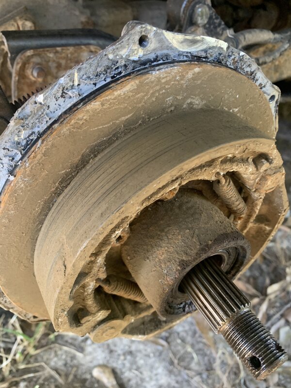

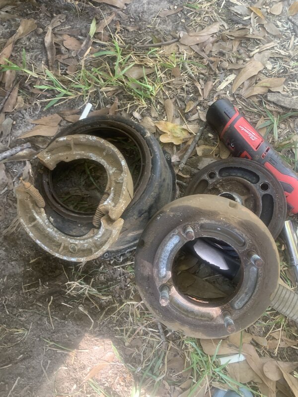

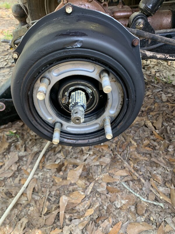

Got to the drum and it came off easily a little suprised at that, it was full of mud and rust, i knew it was going to be bad because there was a snorkle on it when i got it, never buy one with a snorkle, they are highly abused to the machines limit, but i got it cheap .

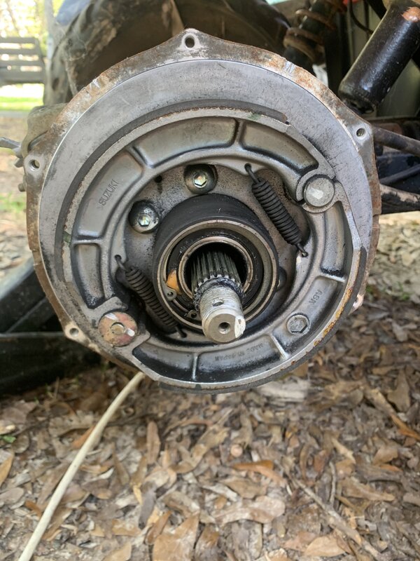

Finally got in there and no shoes left and a complete mess.

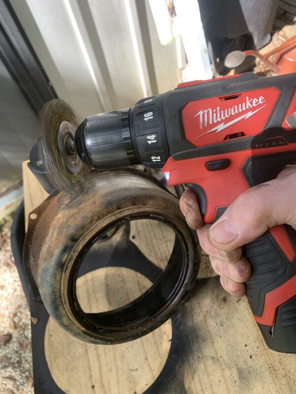

Lots of mess to clean up.
Got it looking a little better.
Lots of cleanup later! Waiting for new parts.

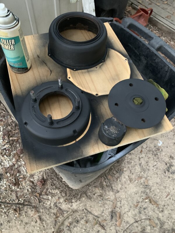

I have never used "Filler primer"   on rusty  wear  parts.   I have used 'Two Part' filler primer on body parts.      I use Rusteoleum "Rusty Primer" on badly rusted parts..

Its made by Plasticote, not a brand i generally buy, but it is one of the best i have used for painting metal with pitting and imperfections, does a good job of hiding those, of course i really didnt need it for this, i used it because once sprayed on its there very hard to get off maybe keep the rust down to a minimum. Plus i didnt have to run to the store to get something, that kind of throughs a pebble in your pond, and it takes a minute to get back to where you are.

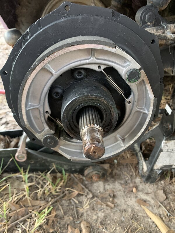

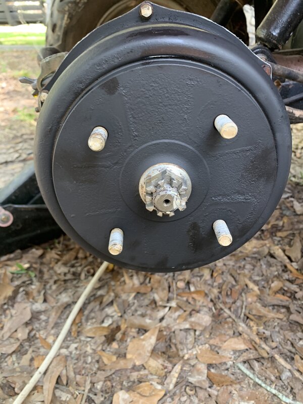

Got the rear all finished up
Looking much better. The hubs are pretty worn but they will be OK for now will probably replace them next round, see how long these aftermatket shoes last. Now on to the front. I think they are going to be worse than the back.
Got the master cylinder installed. Always use anti seize on the resorvoir screws.

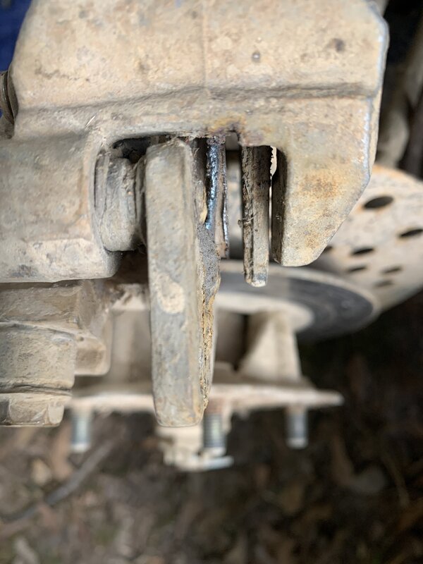

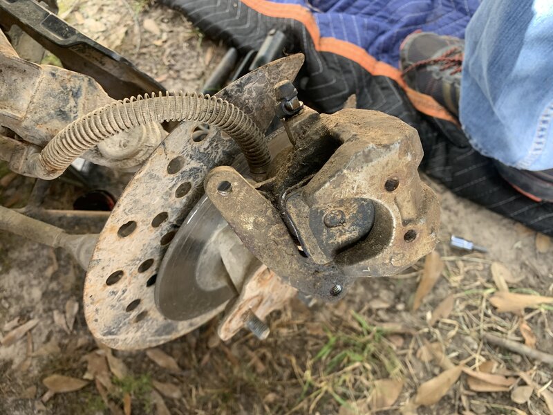

Got on the front brakes yesterday! Interesting find!
Crappy mess as i expected!
Completely down to metal!

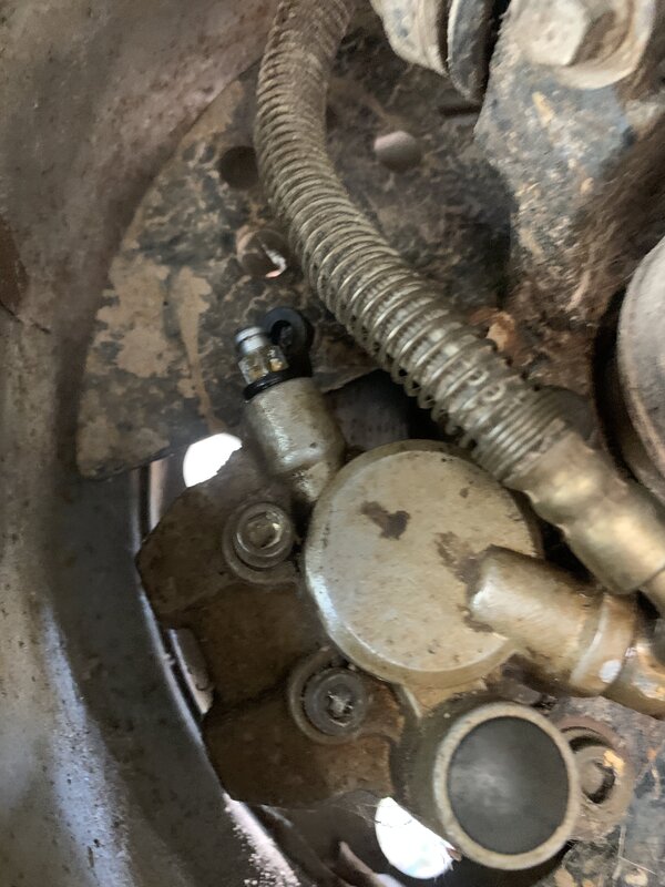

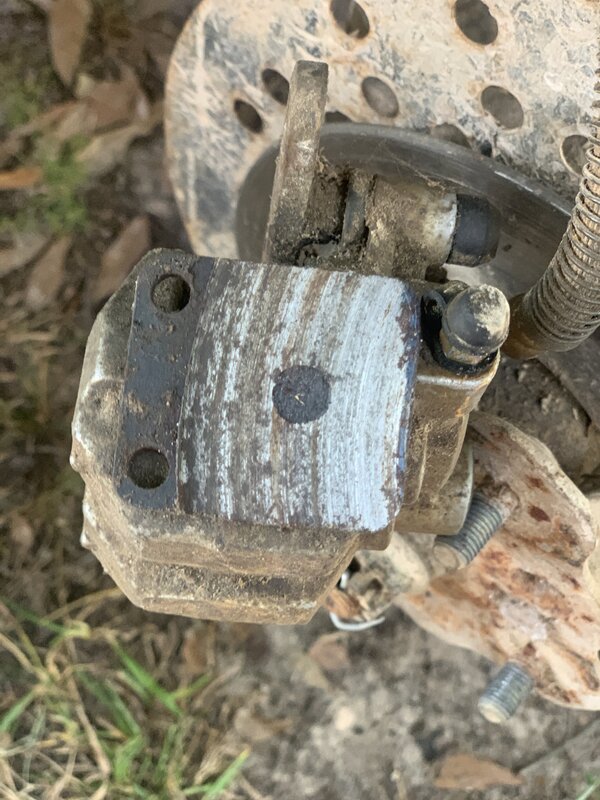

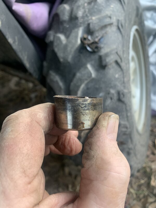

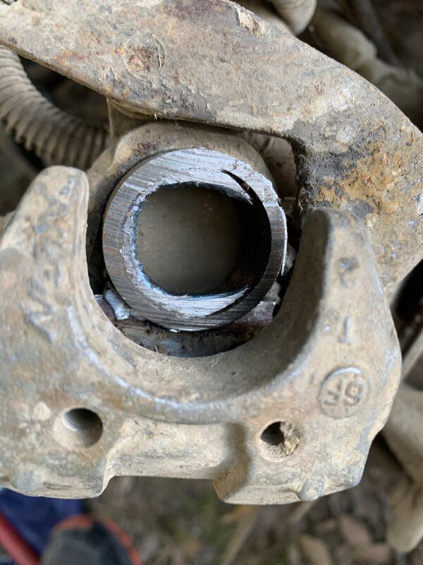

The left side was worse, inside shoe was completely gone! Remnants of shoe inside piston.
Never seen one this bad , i just ground it back down with the grinder reinstalled and working perfectly, see the remnants of the shoe i dug out of the piston laying on the tire in the background.

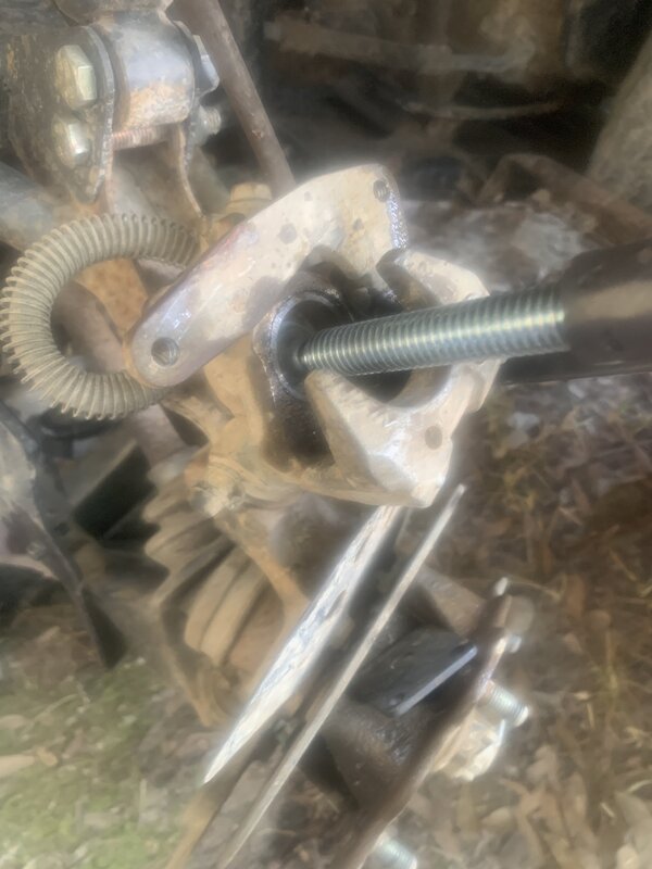

Had to reinstall it with a c clamp my caliper tool was to large to fit in the tiny caliper.I have new calipers ordered for both sides, but its working good now i suspect the bad one will start leaking. Caliperss are so cheap 25 for set of 2 new caliper is cheaper than piston and seals.
