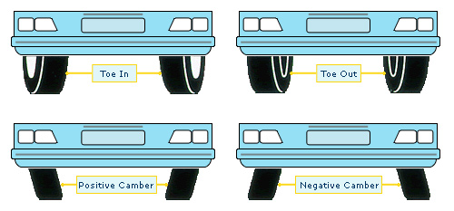

Also, the front left tire (facing it from the front, not riding) tilts in both vertically and horizontally a little. How do I go about re-aligning that tire up?

Now I've been looking around and most people are saying 1/8 or 1/4 (inch?) toe in is usually recommended. I'm guessing that's the 'pitch' from the rear of the tire to the front, right?
