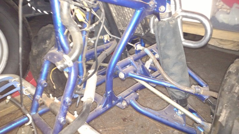

So Im Picking up my crated 89 LT250r next weekend... I have no Idea what shape its in other than its completely tore down. Chassis im told is in great shape and fresh paint. Still sending off to powder coat after gusset install (if I can find a kit). This will be my first Resto/Mod so any tips, special tools, words of advice would be much appreciated. I have no doubt this project will take months and several $$$. I plan on doing all the work myself except for the Motor and paint. Any suggestions on reputable 2 stroke gurus i can ship the motor to ???  Again any help would be much appreciated. Pics coming as soon as i pick her up.....Until then... Deuces...
Well she was not exactly what I was lead to believe. Then again for the price I can't complain. As you can see she is a roller with the Engine already removed from chassis. The previous owner really had no clue what he had. Pretty much the whole Quad is there minus plastics. After loosening the Nerfs I was able to Identify the 10th digit in the Vin#... Shes an N = '92  ... Not the 85-86 I was originally told. which is actually a good thing. The Major problem I have is the huge Crack in the frame next to the rear brake lever. So I will have to grind on what is a fairly new Powder coat job, and weld. My big wonder is will a weld hold or should I also add reinforcements around the repaired area???? AS you can see in the last Pic the Crack is pretty vicious. Let me know what ya think. Until then... Deuces!!!!IMG_20171201_184955993.thumb.jpg.0c0ed20711295da5492a3431fae6ddac.jpg
4 hours ago, davefrombc said:
I'd weld up the  crack  and  also  gusset to  both  bars
I agree Sir. I think im gunna MIG it with some fairly heavy wire. I have a couple of Master Welders on my job site. ill get with them on best wire gauge to use and have them fab me up some gussets. might as well reinforce the opposite side too. The only thing that totally blows, the more I weld and grind, the more im gunna jack up this totally pimp Powder Coat job. I might as well sand blast it and start over.....ERRRRRRRRRRR.... Hubs and A-Arms will have to be done too... Frack it!!!!! Im pulling the Swing Arm as soon as the sun is up. Complete tear down to begin in 60 min.. Coffee is already on.. Walk the stupid dog... Gather tools and material... So much for  Resting on my only day off.
