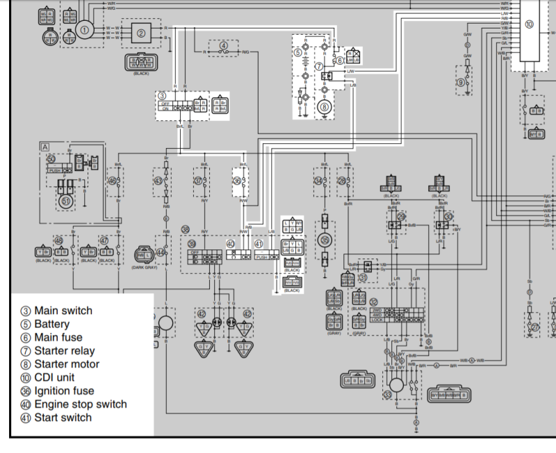

It might be the switch or an issue with the wiring. Do you have a manual with a wiring diagram? Here's one for a 2005, should be similar. There is a diagram. I believe its the push button switch to the ignition fuse, then to the relay and then to the starter.
Look at the diagram in the electrical section
 I went out it took apart the pushbutton housing, While I had it off the bar I pushed the button to see if there was something shorting out or some wires unconnected, as I pushed it, it fired up. Put it back together seems to be working like it’s supposed to. do you think I should replace the switch ?
Glad you found it! That's up to you, I would probably replace it but first take a look at a parts schematic somewhere like https://www.yamahapartshouse.com
