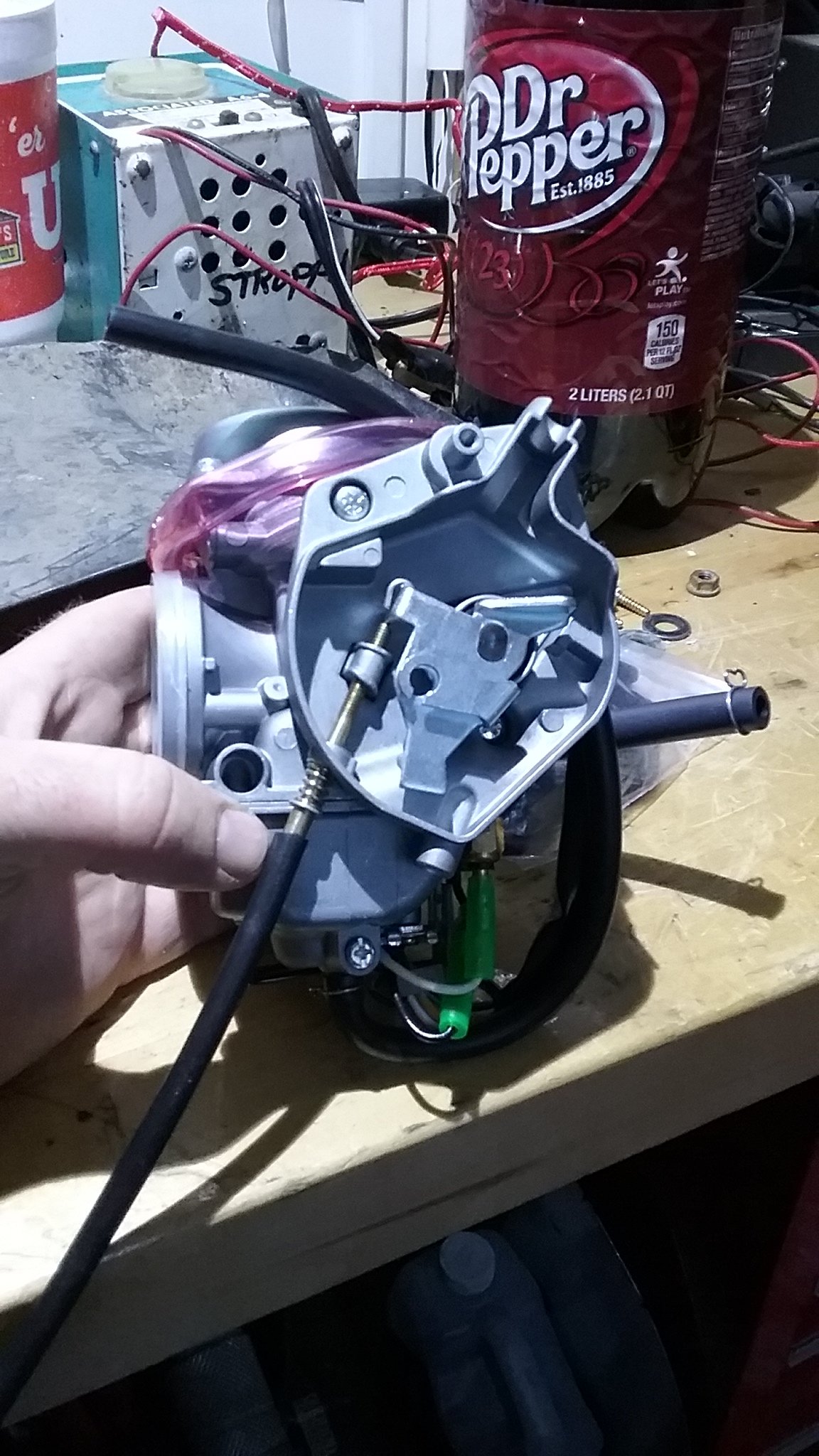

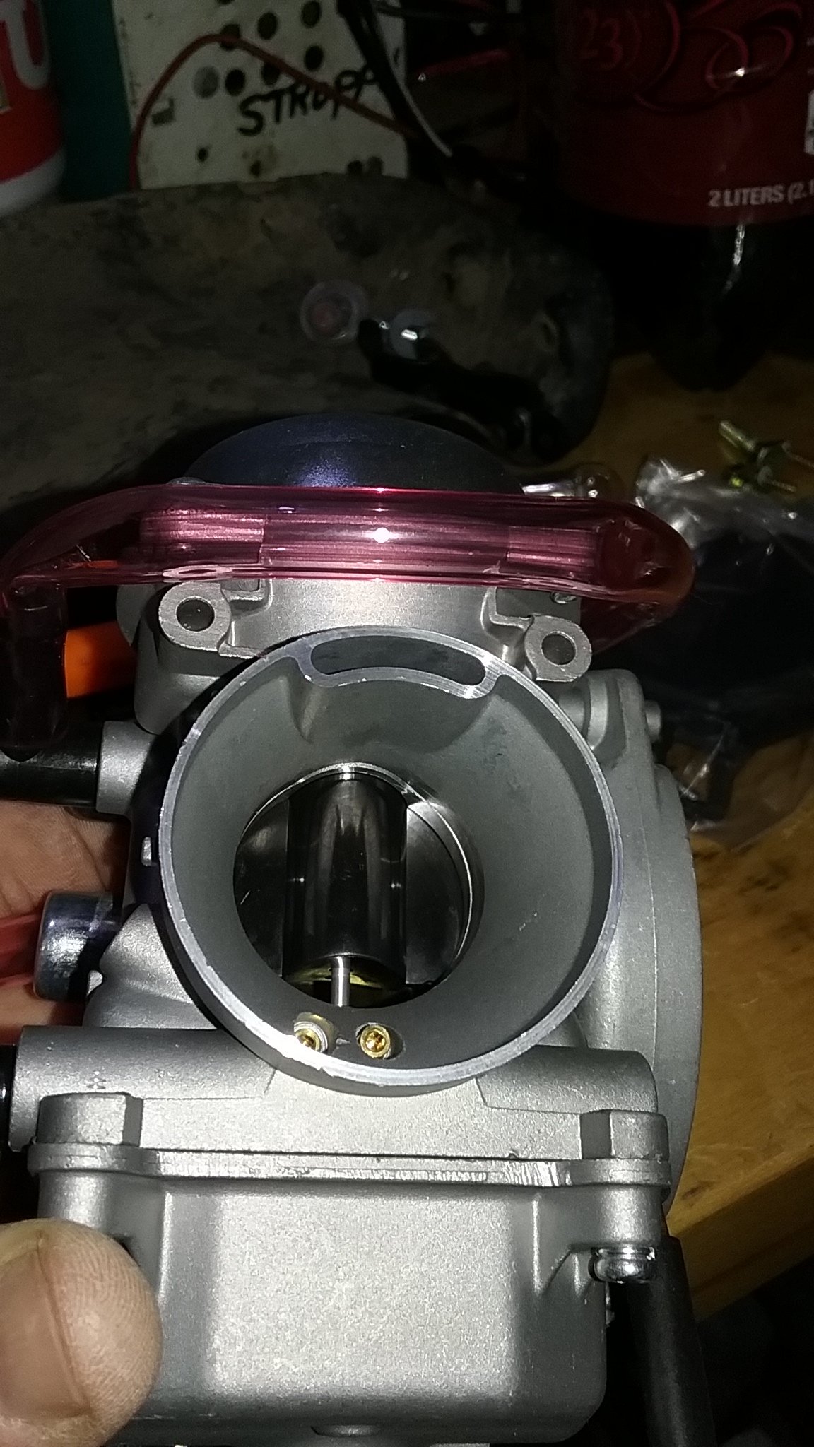

well got the carb in the mail today. man this thing looks nice...only thing i dont like is the slide being plastic but everything is going that way. pics of what i ordered... bolting it on here in a couple hours.. :) crossing fingers 80% and no fuel leaks i will be happy...lol
so got it on.. like you said flat spot in throttle... needle leaked to top.it off.. so i pulled it and pulled it apart. adjusted float level. notice it was running lean up 1/2 throttle... so i pulled the jets out they are way to small.. so i am waiting on the proper jets i had to order... i contacted the seller of this carb and aaid qhat do you want to do.. they refunded me the purchase price of the carb...as it was not even close and specifically listed for this quad and engine size... so more to come...
