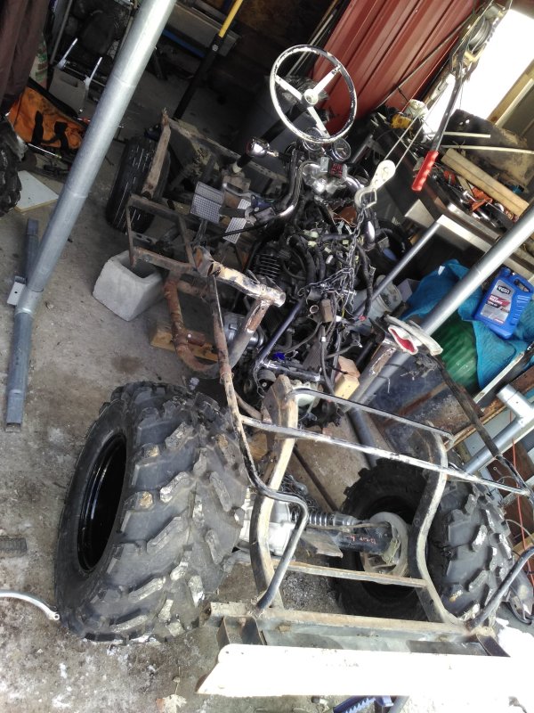

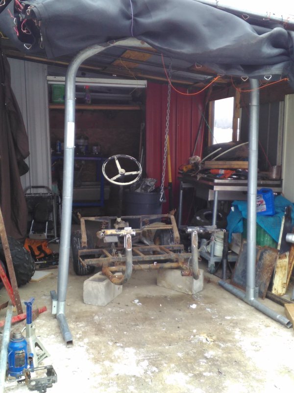

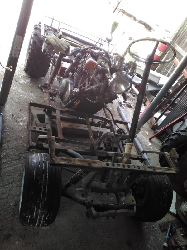

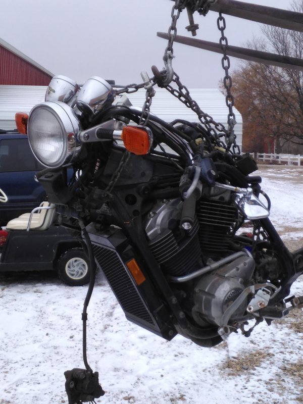

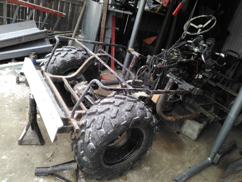

Here's some pics from within the last month. Rather than build a frame and body from scratch, I drove to Kansas and bought a rust bucket G2 for $40 minus batteries. I've since cut it up in prep for the 1100cc v-twin shaft drive engine. I've included a picture of the of the latest mock-up. Im extending the frame and wheel base 12 more inches and widening the body by 12 more inches as well. I have on order a right side axle shaft and housing for the left side of my ATV rear end. This will widen the axle by about 12 inches. I will be eliminating the front  a-arms and replacing with straight pipe from knuckle to knuckle. I'll post more as it progresses.
