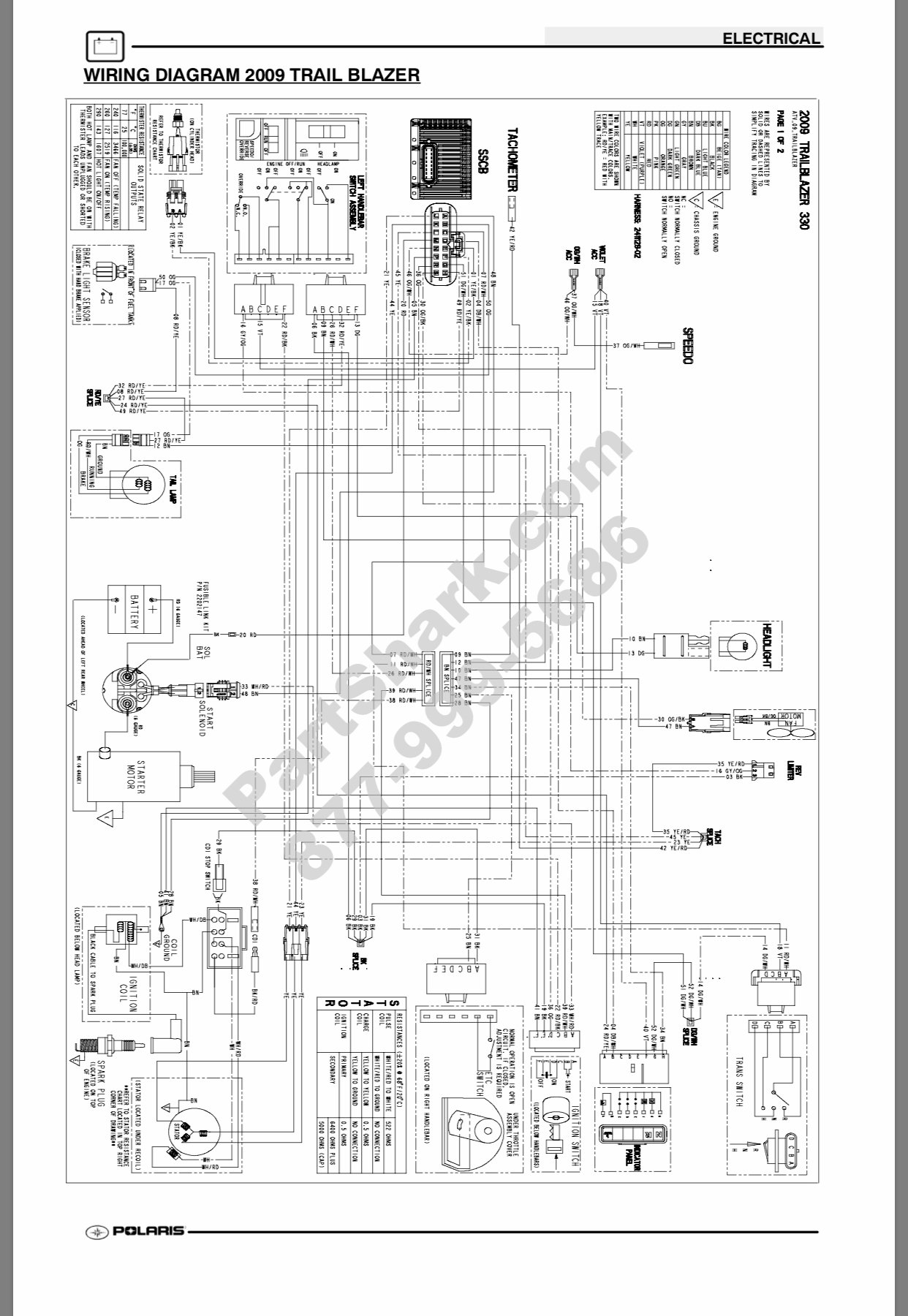

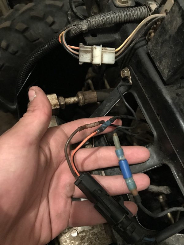

Sorry I forgot to mention it’s air cooled, so it’s not really a radiator it’s a oil cooler theres no water pump. The thermistor switch seems to already be jumped to the solenoid, don’t know if that’s from the factory since I bought it used. The oil cooler gets really hot after a few minutes, the fan does run very fast. Does this make a difference?? Thanks again

So 2 wires go to the thermistor where it screws into the hose, the blue jump goes to the solenoid (powered off the battery) and the other one connects to the fan. It’s also grounded to the bolt

I looked it up and yes it’s an oil cooler and  the thermister that bring the fan in.

I haven’t taken it off but I’ve power washed it and used and a hose to try to get any mud out, I can see through it for the most part. The engine isn’t painted. The guy I bought the quad from said it has less than 8 hours riding time and he let it sit for about 10 years. Everything was fine for the first 10 rides after I bought it, I decided to change the oil and oil filter, the air filter and the spark plug and that’s when it started giving me problems. Since then I’ve cleaned the carburetor, bought a new battery, and the carb boot had tear in it so I replaced that. The fan never came on once it started overheating, The thermistor was connected to the top of the solenoid which I found had no voltage so I connected it to the bottom that’s powered straight to the battery, the weird part is the starter is still connected to the top and works fine?. At first it seemed like a lean condition with it backfiring but now it’s just running way too hot and loses power/backfires. Any ideas?
