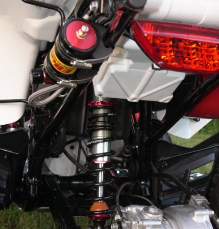

Honda 250x shocks elka suspensions
The kit Elka built for our TRX250X features remote reservoirs front and rear for added cooling. Elka’s legacy series shocks feature spring preload, low-speed compression damping, and rebound damping on the rear shock. The ideal amount of adjustment for most recreational riding and even some beginner level racing. They’re built for your weight, type of riding, chassis setup, tires, and more.
With our TRX250X now sitting around 44.5” wide, it is much more stable, allowing us to carry more speed into and out of turns; plus the quad stays more planted on side-hills.  The wider rear end spreads the machine’s weight out, allowing for more predictable and easier to execute power slides and boosting the ATV’s fun factor. Our only complaint is a small but manageable increase in steering effort, leaving us happy we’d stuck with the +1.5” wheel spacers.
