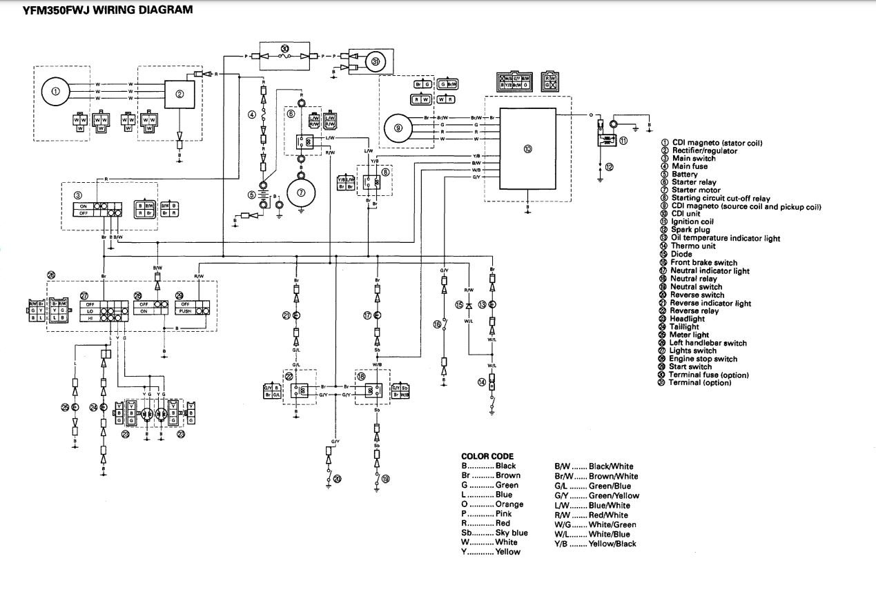

Hi guys
My 87 Bear 350 won't start and could use a hand.
Turn key on and Oil light turns on and then slowly fades out. (I think this is key to this) No start, not even a tick.
battery and connections good
A Solenoid post jump turns it over
Neutral Safety Switch wire attached and seems good
It has not had a wire/switch on Rear Brake Pedal ever since I had it.
Any thoughts on some other things to troubleshoot this??
