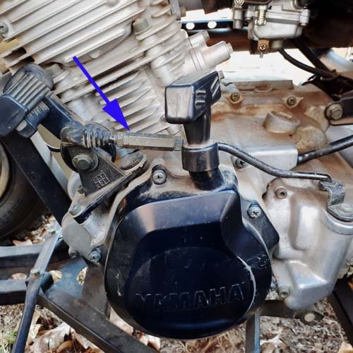

Well it tried to jump into reverse again this afternoon and it wasn't even under a load this time. I've been thinking about it and got to thinking it might be something as simple as the forward/reverse shifter linkage so when it acted up again today I took it straight to the shop and adjusted the linkage so as to move the actuator further into the forward position. I only adjusted it one turn on the adjustment thread since I don't really know what the heck I'm doing and don't want to go too far. Shifts into both forward and reverse with no problem but I won't really know whether that fixes the problem or not until I've rode it awhile since the problem is intermittent, but so far so good.

Quick update on the shifter problem. After adjusting the forward/reverse linkage yesterday it hasn't tried jumping into reverse at all. I worked it pretty hard in the woods all day today, hauling small cedar logs and cart loads of brush up and down these Missouri hills without a hitch so starting to think the problem was all in a simple linkage adjustment. Will post back if anything changes.
