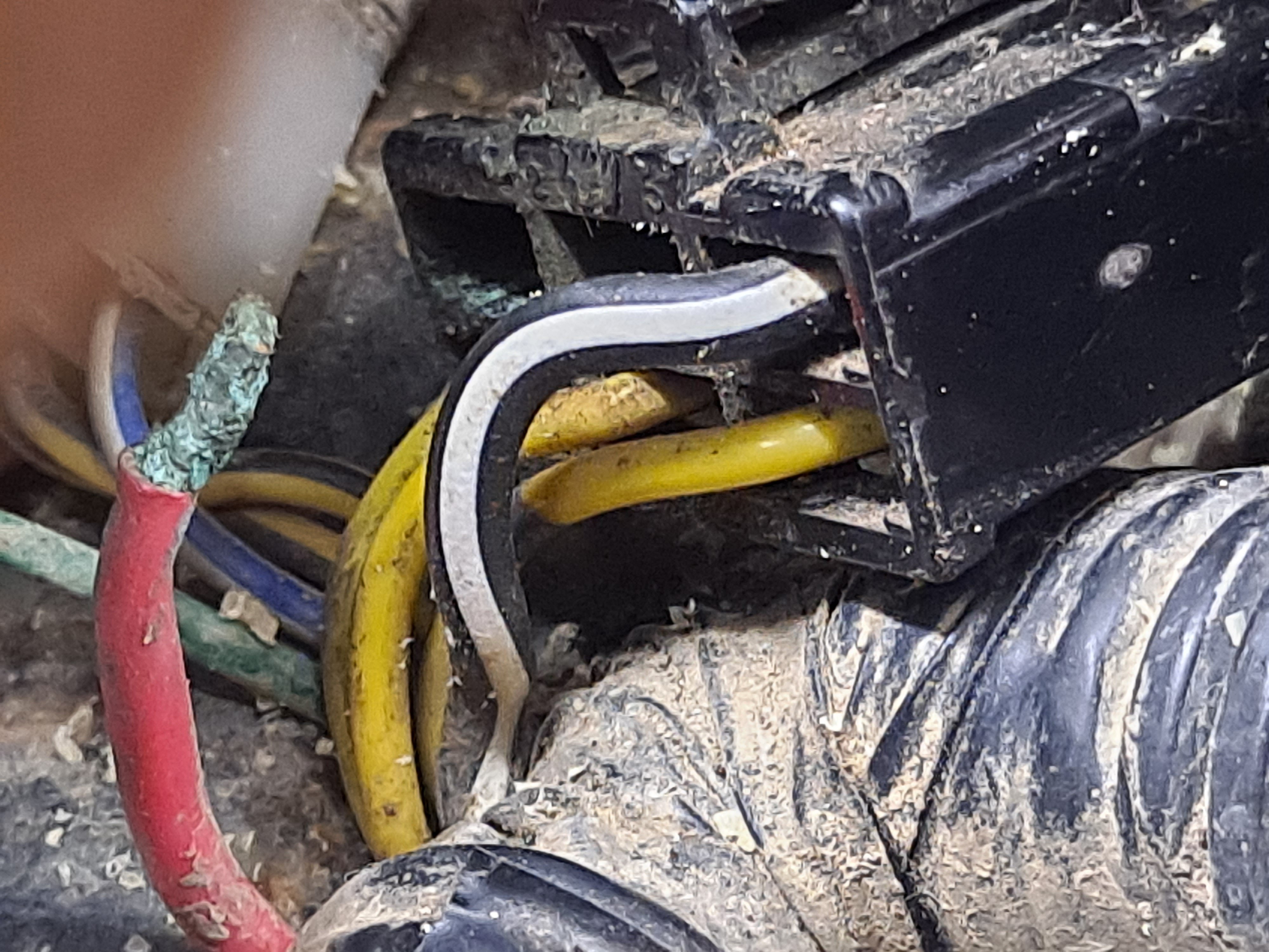

Look what I found !! The last "tech" who replaced the regulator missed this. I guess its why the new regulator never worked. Feels good to find the issue, but, dam, there is no room to work in there........
Well done you !
Wires nearly always give trouble at the ends, either broken from flexing where they go into something, or at the terminals..
It's a good idea to take all the body work off and grease all the bolts and screws so it comes off easily in the future. Taking the bodywork off doesn't take long if the bolts are all good, and it makes nearly every job easier. There aren't really many bolts that need undoing once you figure where to disconnect.
