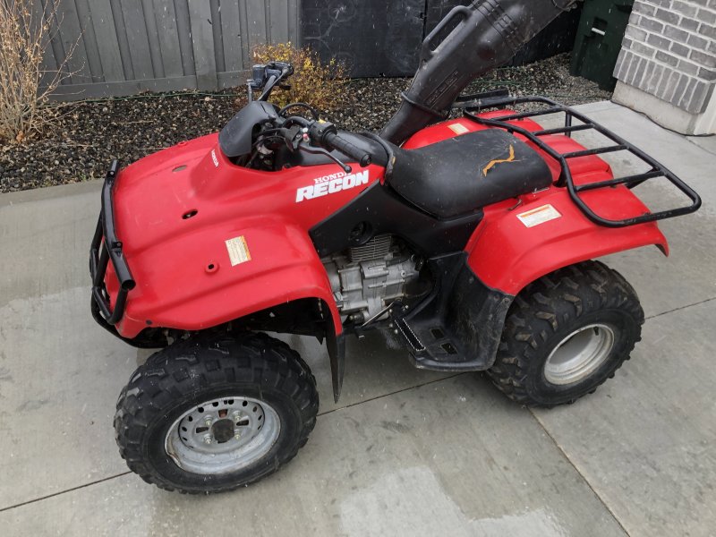

Do these have Oil Filters?
Just picked up a new Recon and excited to work on it. Here's the list:
1. Oil /Filter change
2. Gas Drain/refill with Fresh
3. Carb cleaning / Air filter cleaning
4. Troubleshooting: why reverse isn't engagingIMG_6881.thumb.JPG.8084590ed26eda091ea0bdc80b62e40a.JPG
5. Troubleshooting: why tail light isn't working.
6. Buy a new seat or cover.
7. Straighten bent front left fender(rollover?)
8. Buy a new battery hold-down strap
Hi Matman, How's it going with your Honda Recon, did you still need help with it?  At risk of sounding obvious, you can download the service manual right here, that'll tell you if it has an oil filter and anything else you'd need to know:
Fortunately you have more than 10 posts so download away...:o)
Let me know if I can further assist - Cheers Matman!~  Bellarmine
Thanks!
Yes, Got the Recon running great, even without an oil filter!
Note to all those new to 2000 era and newer quads.....change your oil regularly.
👍oil change
I’ve been working on my brother’s Suzuki quad master, it had been setting awhile.  When I changed the oil it came out like water and looked like it came from my diesel tractor.
The recon has an oil filter rotor that probably should be cleaned every 10 years or so, to access it you need to take one of the crankcase side covers off, I forget which one
