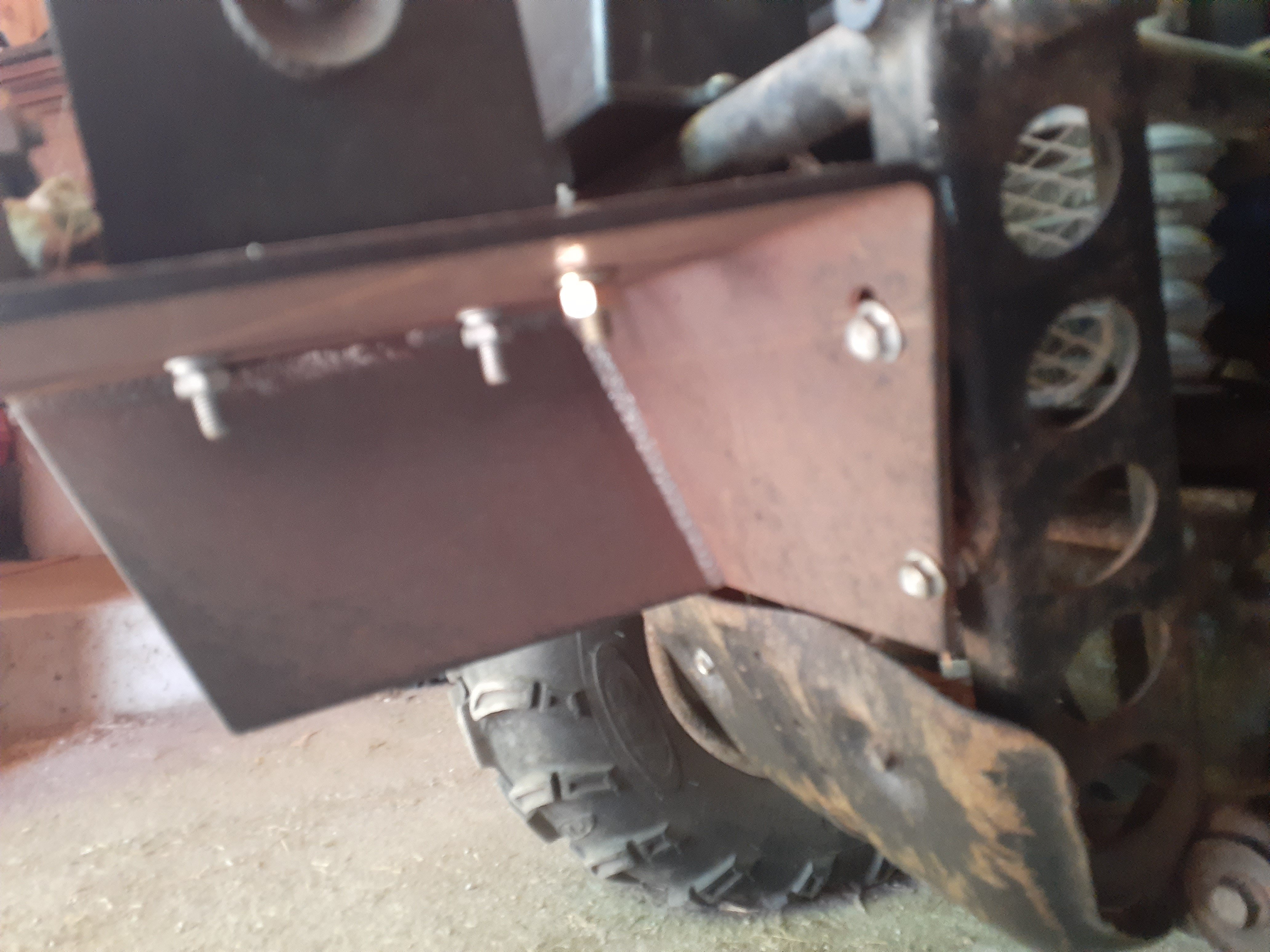

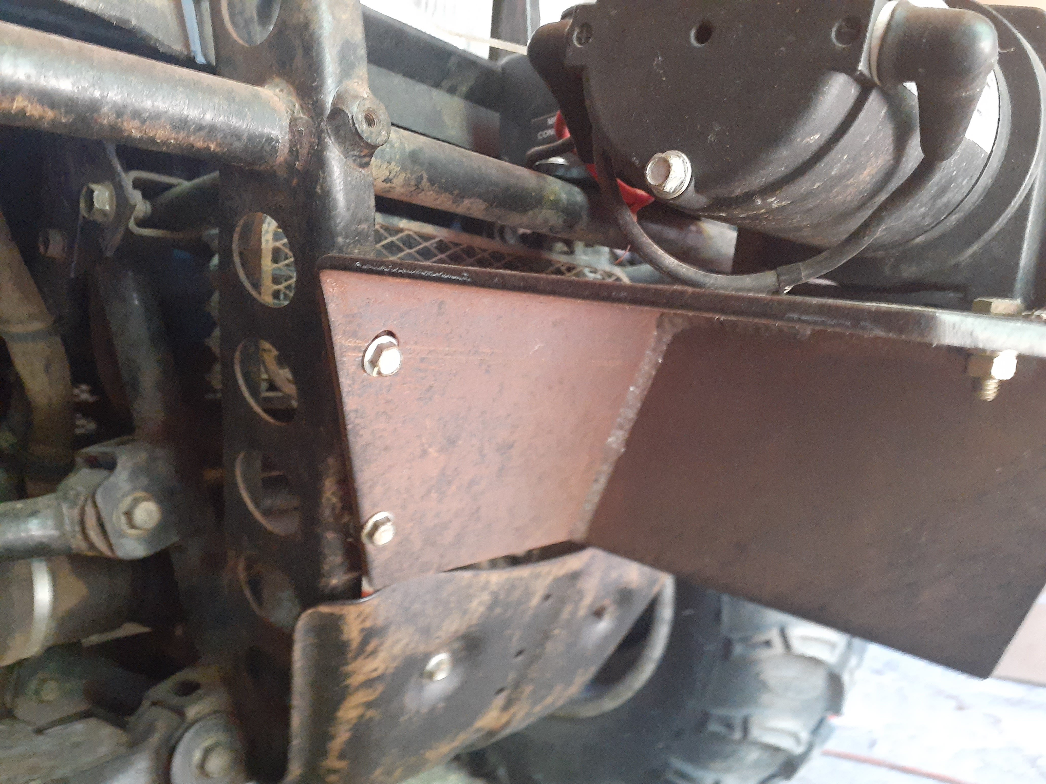

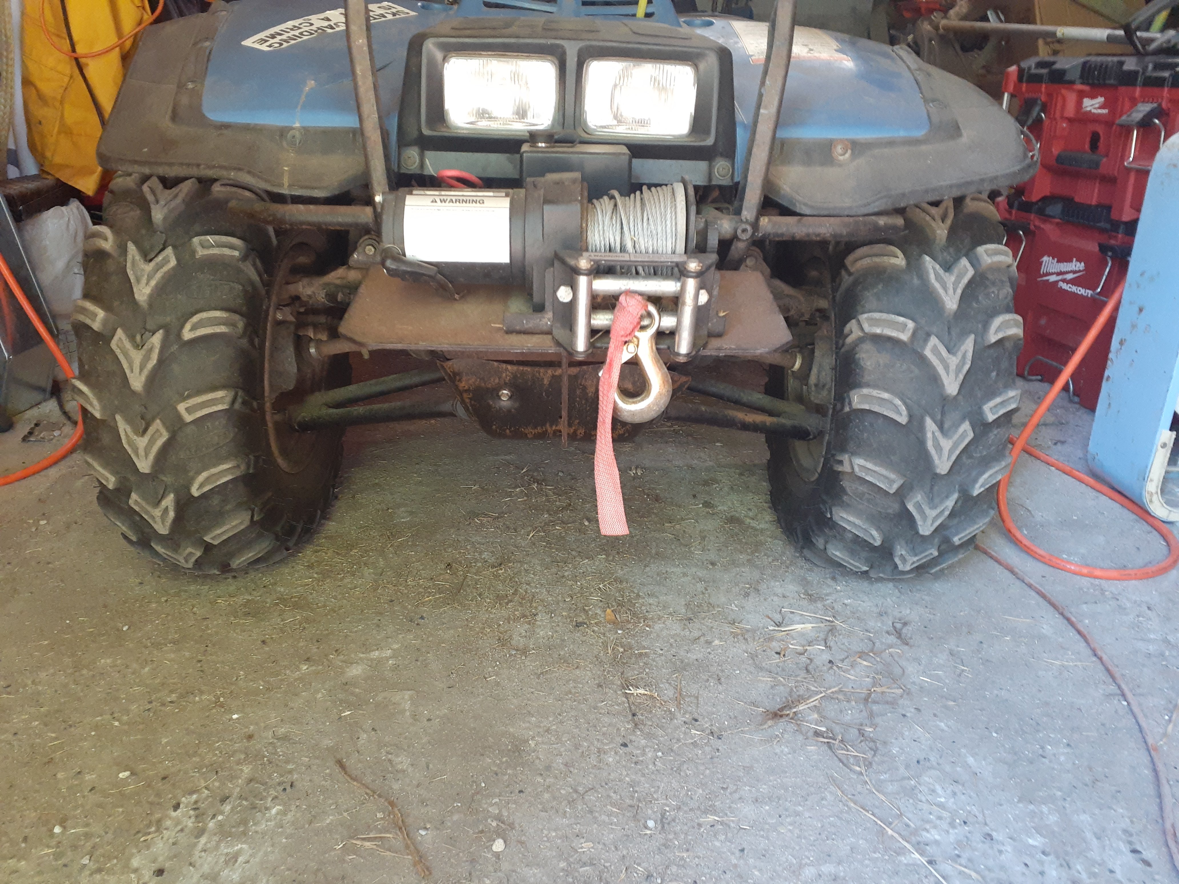

Here's my LTF winch mount, I made a mounting plate out of some 3/16" plate I had ,bent it approx. 20 degrees and marked and drilled 4 holes for the 10mm nuts that are  already welded onto the front frame member. The remote switch assembly was than mounted to the front crossbar just aft of the winch, All I had to do was predrill and thread the holes for some #8 screws. I have one more mod to make, welding a receiver under the winch plate so I can put a ball hitch or pintle or pin to push my equipment around instead of backing everything up
