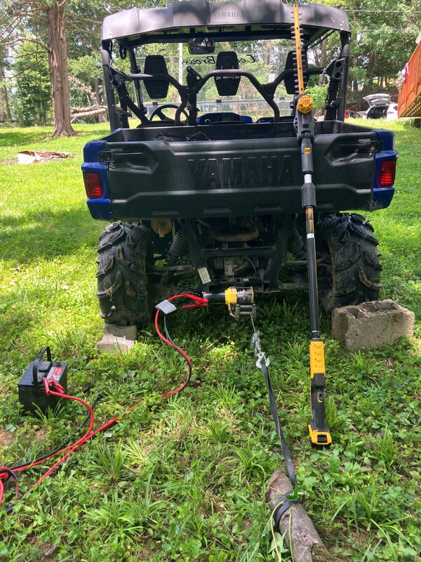

This is an old Harbor freight 1.5K lb wench that still works.  Control went South so cable control.
I like the smaller wenches as they are easy for me to manhandle   ( where did that term come from?)
It aint pretty but it works.

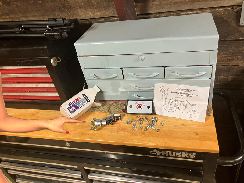

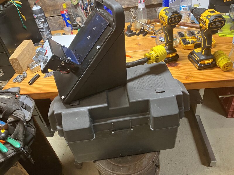

Here is picture of switch assembly.  I got lazy and bought the switch with CB and in line thermal OL.  Notice the solder type ring terminals...very nice.  I always struggle to find correct terminals for projects.
The ring terminals should accept the #10 awg.   Bought from Amazon...$41.  I have quick disconects  that I will use for bat.
It does look like the terminals will accept #10 AWG wire. Is the switch rated for the current? Usually winches come with a box that contains a set of high current relays to switch the polarity to the motor and then there would be a low current side to a rocker switch to select winch in or out.
The manual switch you are showing does the same thing , One thing, where you plan to mount the switch box, you will have 4 #10 wires to the box so you may not want to mount this on the handlebar.

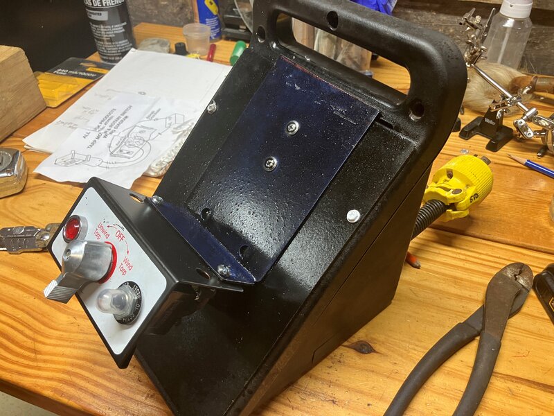

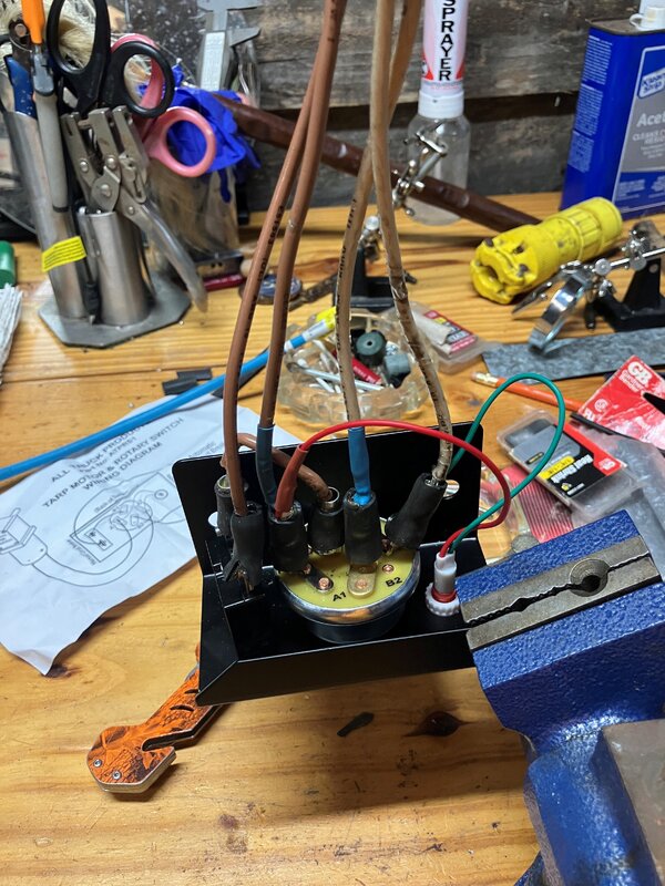

The manual winch switch is rated at 50 A; however, the terminals on the back are close together..  I  used thick shrink tubing over the screw terminal connectors seen here.
The indexing hole in the metal control supplied was sloppy...I like tight.
I had to shim the hole so the manual control would not move when twisted to open / close winch.
