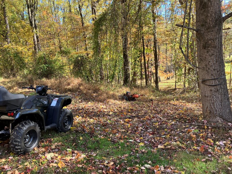

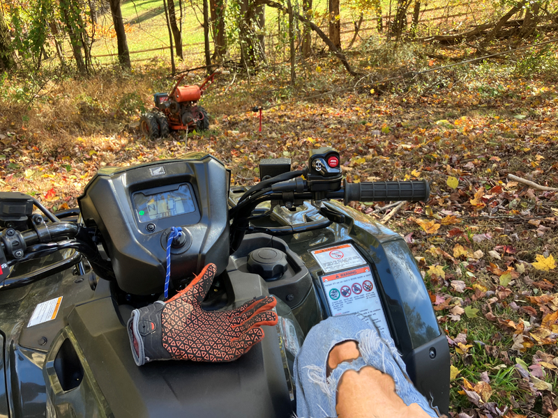

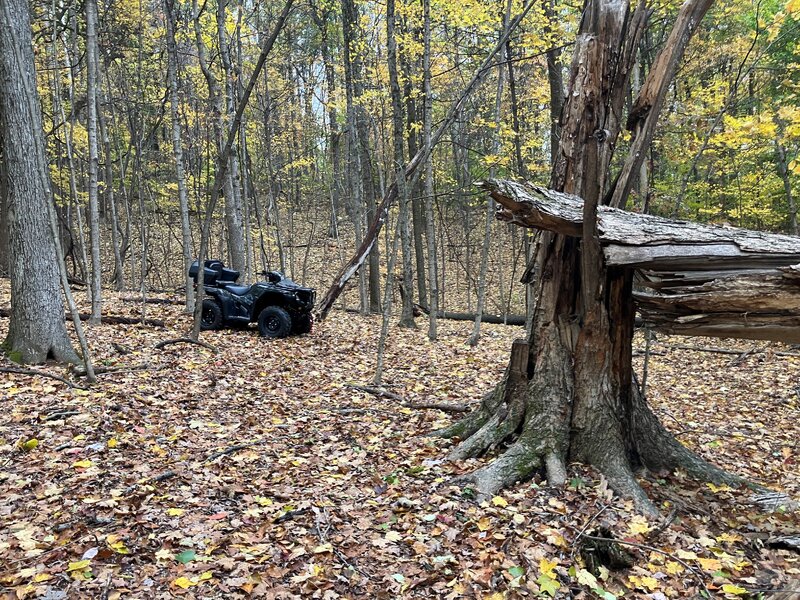

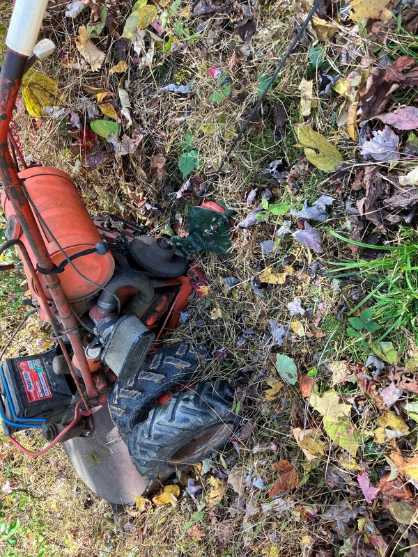

Darn I was looking at snatch blocks but got Grandpa's Monster gravely stuck with wheels off the ground i a ditch. .  Wheels completely off ground with mower deck and rear frame  on ground.   I only had the big snatch block, so i hooked the winch poly rope to Tulip Poplar tree and rigged  running Block on gravely hitch , We always called that a simple moving block.  The Gravely weights close to 800 lbs and it was a dead weight pull for first few inches as wheels were just hanging free.  The Tulip Popular tree did not budge and Foreman drug him out. image.thumb.png.f90d6ad6db5213c3b9f236fa3b29bf38.png
Foreman has a 3500 lb winch. image.thumb.jpeg.4d623092b85e0f48be6851e76182ca08.jpeg
Yes i also had soft strap looped through the serpentine belt that was around tree.  I have a couple   2 " x 48"  braided lifting straps that construction guys have given me.  I keep them clean and use on trees "or clean things".

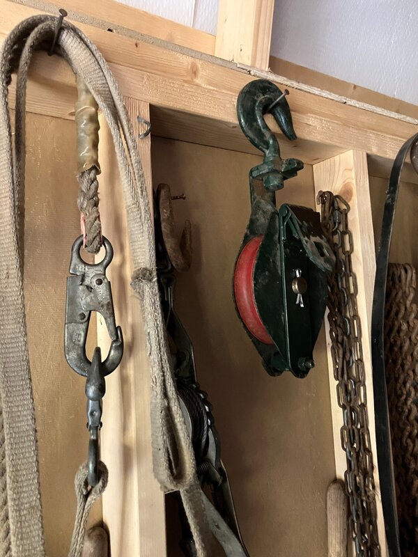

Here is my snatch block.  It is not my only snatch.  I have 1/4 inch steel cable snatch block.  I also have a 2 inch wide  rubber spool snatch block.

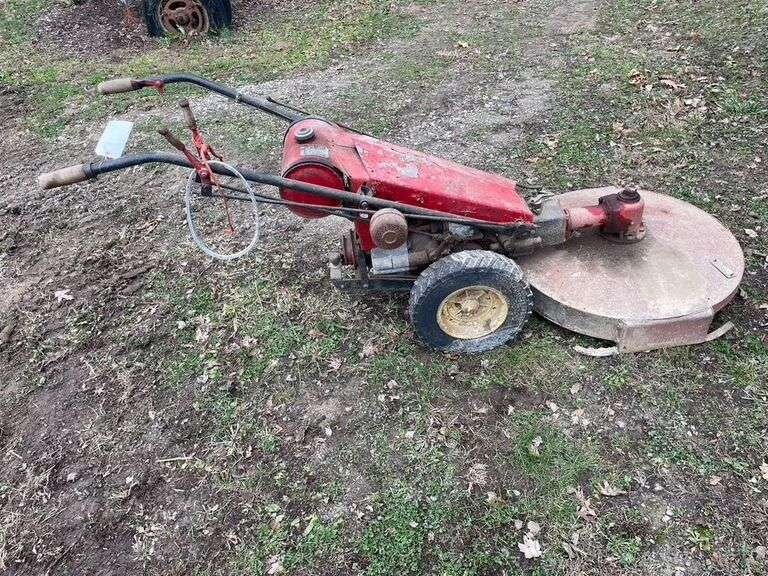

Jenn, that equipment you pulled out looks really interesting.  What is it and what is it used for?

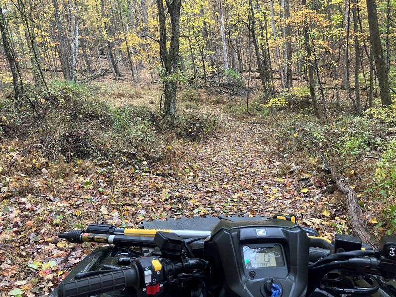

I see you are getting really good use out of your hi tech Honda.
Really..?  That is a Gravely garden tractor made in 1960's ...I have serial number.  I rebuilt the motor ...I am not a mechanic ; a parts replacer. new piston and  cylinder etc. there is a gravely dealer in Spencer WV that specializes in original parts.  Grandpa has one in FLa. also.  They are a handfull to use.  Especially since I added the dual wheels .  Other than motor it's original.  I am using it to brush hog Multi-floral rose in our woods.  It will cut off a one inch sapling.  Picture is web pic
